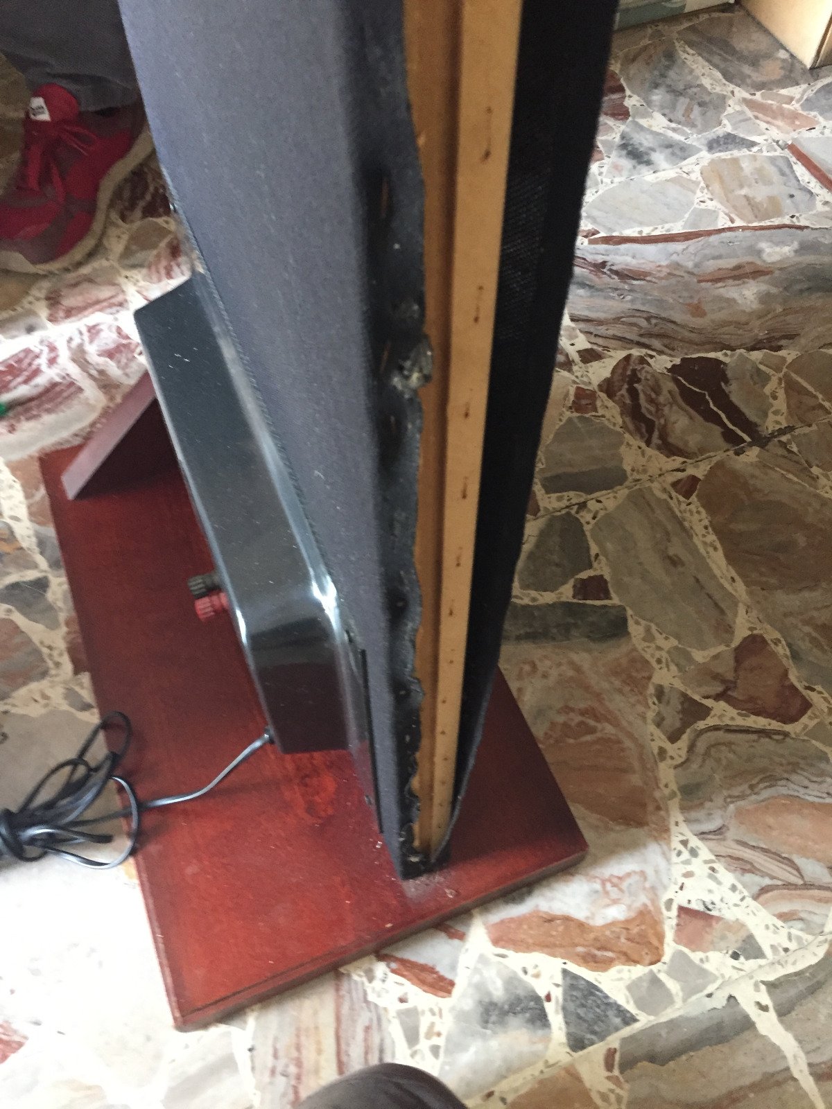

I'll load them onto the van by this evening, then I'll remove the black acoustic canvas and take some initial photographs. Then I'll do a low-volume test and take a closer look to see how it's assembled.
as I was saying... maybe they are the first models and the frame is made of raw wood with black canvas covering it. three power supplies embedded, it is not clear how and some resistors in series outside the power supply area, placed in the lower area of the frame where there is the mylar.

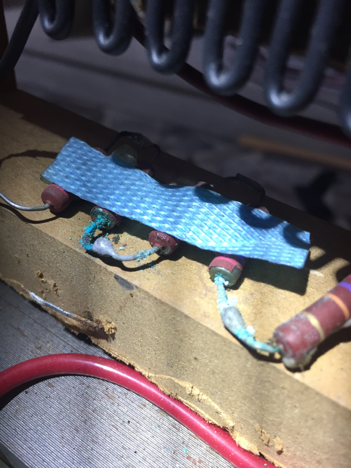

completely oxidized:

also on one there are the aluminum strips that hold the copper/wire loop, in the lower part that have detached from the milar frame - 3 completely and 2 others only on one side. this however does not seem to have any effect on the sound which remains very, very low.
Oh now I see where the black stuff is. I remember a similar one offered second hand. This is a very old one!
These are indeed very early ones, I think these models were still sold under the Megalith name, late 1980's. I own a pair of very early ES200's of identical construction, see https://www.diyaudio.com/community/threads/anyone-knows-this-unknown-audiostatic-es200-model.408281/. Interface looks identical too, with the mirror drive transformer.

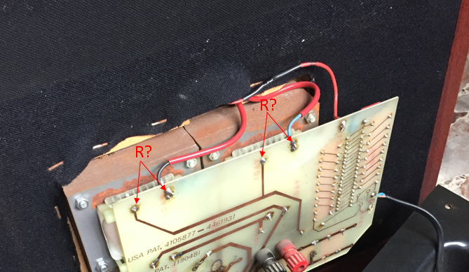

Looks like they were not always stored in a dry location. But nothing terrible. Do you have a multimeter? If not, you should get one. Try measuring the resistance between the points indicated in the picture. And measure the resistance of the four 47k resistors that are connected to on each stator, they look a bit crusty.
It all looks factory built to me, no signs of a later rebuild. So my bet is still on the coating. They must be at least 35 years old by now. You'll need to take of the cloth completely first and desolder the wires to the ESL element. The element is glued to the MDF frame in these, it easily pushed out breaking the glue bond. White or black stator wires?
yes, they are old and yes, they have taken humidity, you can see it. I will proceed with the measurement of the resistance on the 4 points indicated.

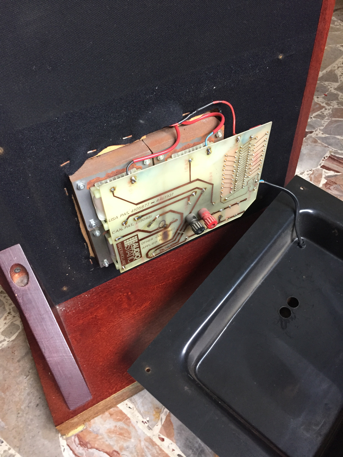

I also have to figure out how the three transformers are locked into the box - maybe glued, it's not clear.

Do not try to take the transformers out! They are glued in the wooden frame. It takes a lot of force to remove them, with a high risk of damaging them. So leave them there.
There is no need to take them out at this point anyway. If you later need to remove the pcb (to rebuild the HV supply for instance), unsolder the connections of all three transfomers. That allows you to remove the pcb leaving the transformers in place.

The worst thing of these is separating the wooden panels from the esl element. Originally they are glued. It takes quite some force and there is a risk of splitting the wood. When unlucky some of the metal bars may get loose. I fixed them with super glue.

I suspect that the oxidized resistors need to be changed - there are 5 in series + another 5 in series. I also noticed that on the board on the transformer side, there are two dark yellow capacitors and a fairly large resistor. on one side it is green and round, on the other it is square and white... hum???
yes, i saw that by unsoldering the six points of the three transformers you can detach the board and better control everything. so i will not remove the transformers from the chassis. ok
and then...i thought i'd do a check on the whole power supply department - everything under the plastic box - then again a listening test and a microphone measurement.

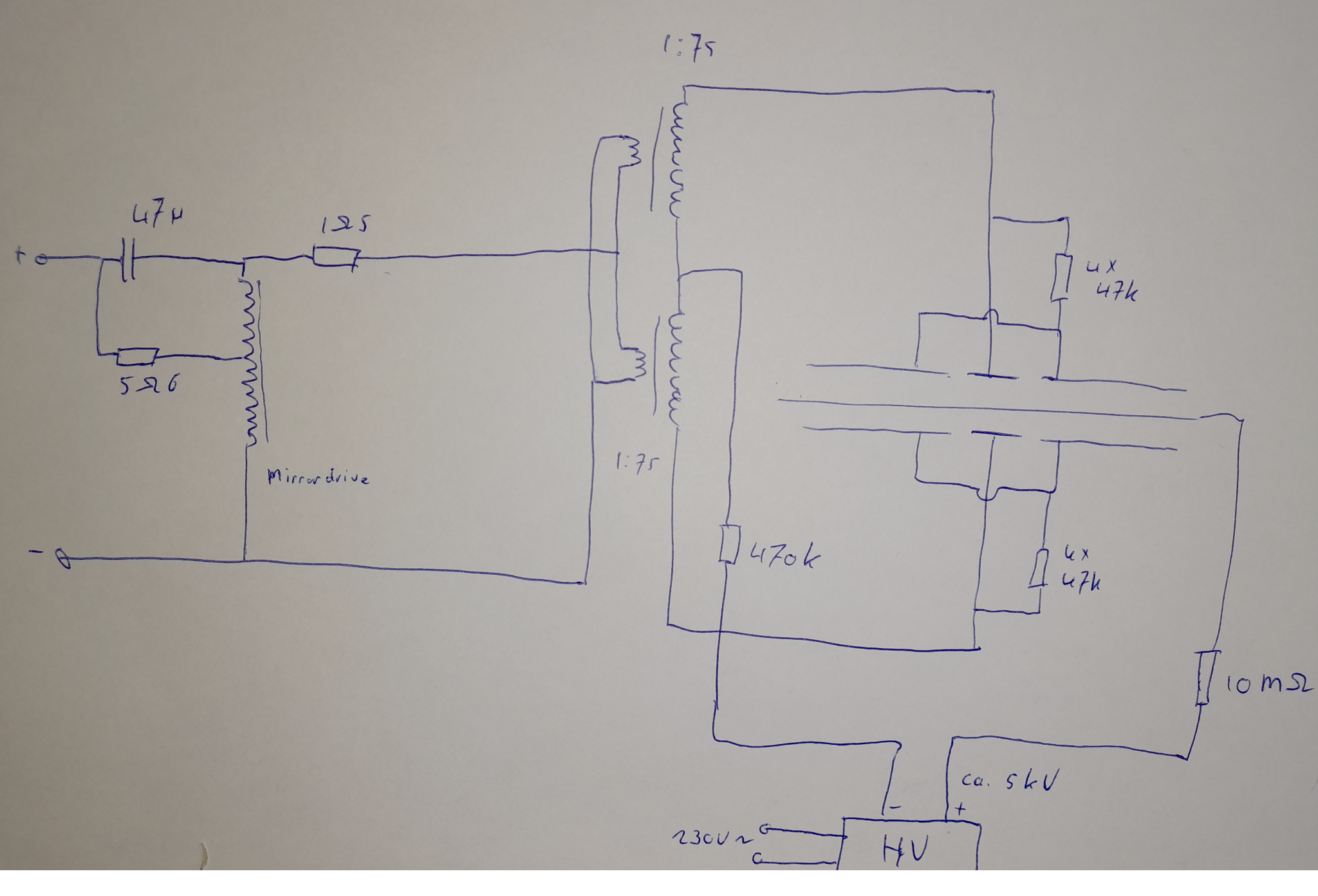

Some usefull information: The interface is very basic on these. Here is the schematic I made of my ancient ES200. The 47uF cap is a very large MKT, the 1R5 is a round green wirewound (10W or so), the 5.6 ohm is a 5W white cemented resistor. Component values may differ a bit on yours because of the larger ESL element. There is really nothing to go wrong here other than the two audio transformers burning out as mentioned before.

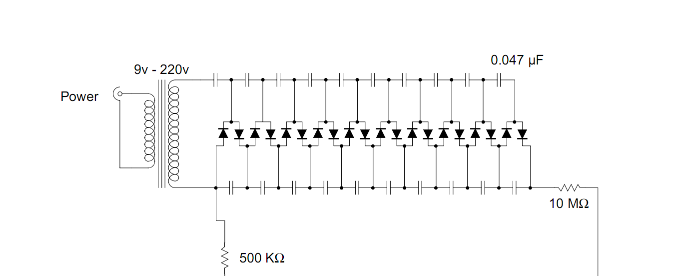

The block with HV supply is a simple voltage multiplier with 20 diodes (probably 1N4007) and 20 caps (47nf). It is used in all Audiostatics, here is a schematic from an ES50 that will be identical.
In your case the mains transformer will be missing and the mains is directly connected to the voltage multiplier. The transformer was only used in markets with a different mains voltage from 220/230V, in which case a small external power adapter was used to provide the 9V AC input. On my ES200, there is is a trim potentiometer on the mains side to adjust the voltage but your's don't seem to have that. I guess my 200's are even older.
