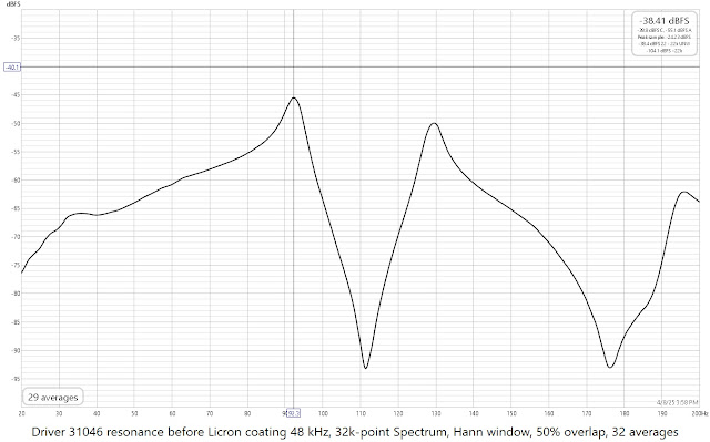

both sound the same and as if lacking in low range, if you turn the volume up a bit you can hear the classic - noise that a woofer emits when it is cooked or goes out of revs, but it does so in a light tone.
I think I will also try a measurement, but I think the sound is lacking from 400hz and below.

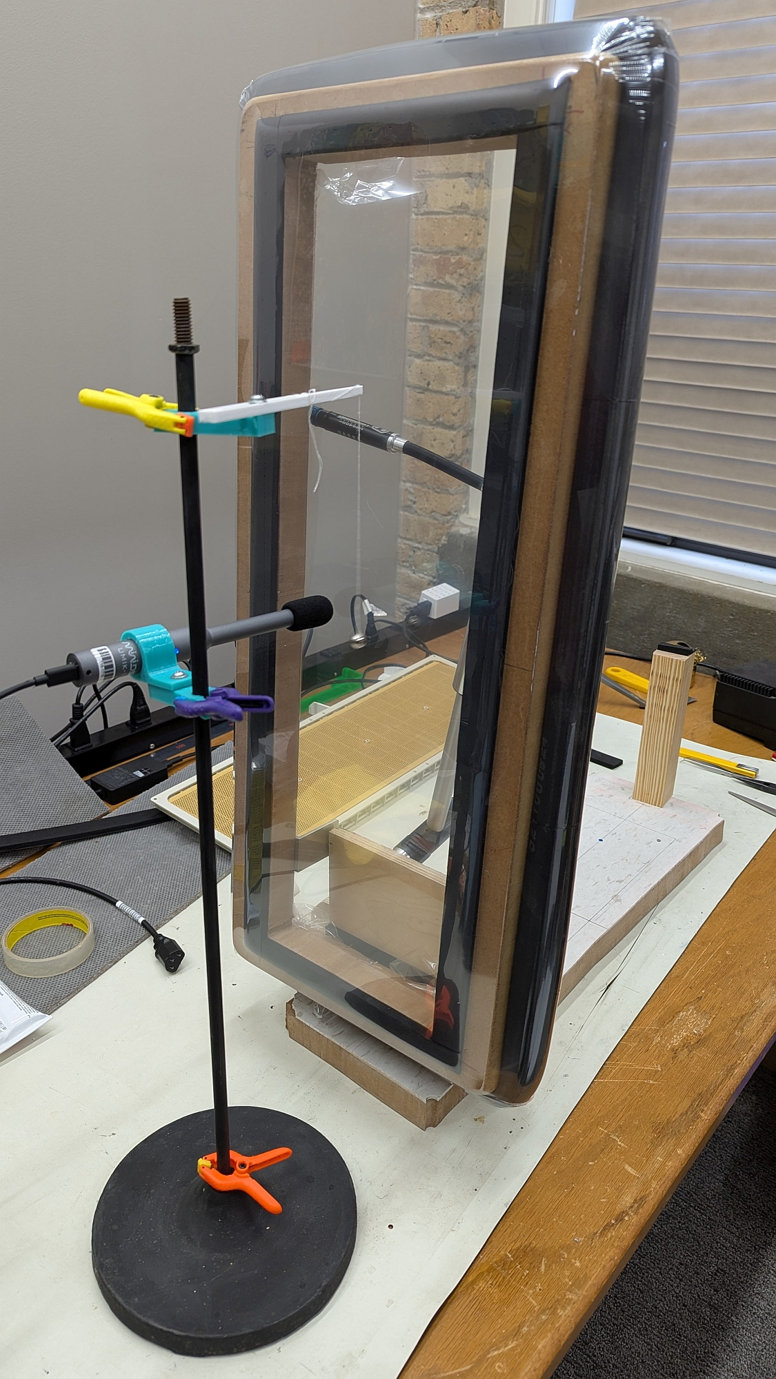

Unfortunately it's not so much a matter of prolonged overloading, arcing only once is enough to potentially kill a transformer. But let's hope for the best for now. Bad coatings or connections can also cause weird sounds. And replacement transformers are not completely unobtanium.
First step would be to verify it is indeed the coating. Since both have the same problem, it is very likely but still. Switch them on, no input signal. Listen in a quite room with your ear close to the membrane and interface for hissing or craking or popping sounds. If all is quiet, feed them a small audio signal (max 1 Watt). Listen again if the output is uniform in volume all over the surface. Try breathing on the membrane, at the bottom end. Don't remember if the coating is on the back or front so just try both. When breathing on the membrane increases the output, you can be pretty sure the coating is gone.
Next step would be to open up the interface. Remove mains and audio connections, leave them for a few hours to discharge. Remove the plastic cover at the back. Use insulated wires to short all three wires that go to the ESL element without touching them with your fingers. Leave the shorts in place for half an hour. Then you can safely work on the speakers. Check for loose connections, oxidation, signs of arcing etc. Post a picture.
Measure dc resistance on the secundary windings of both audio transformers, the connections near the top edge of the PCB. If you get strange unstable readings, use another multimeter. Some meters use a pulsed signal that interferes with the large inductance. Any cheap multimeter should do fine.
For rebuilding you need to completely disassemble the speakers and remove the ESL element from the MDF frames. Everything is glued together so it might take some serious force to separate the element from the side frame parts. Next step is to split open the elements, again it's all glued. Depending on the year of production and/or possible previous rebuilds you can expect all kinds of glue. Some easy to break, some not so... Then you have to remove the old membrane, clean everything, restore any broken joints etc. Most important is not to damage or bend the stator wire/crossmember assemblies. All the rest is easily fixed or replaced.
The original membrane is 6um mylar, but 4 works fine too and gives slightly better high frequency detail. There are several sources that will sell you suitable mylar. You'll need coating, this is the most difficult part. There are some recipes out there that seem to work, or you can order a ready-made coating in Australia that works very well. You will need to construct some sort of tensioning rig to stretch the mylar to the correct tension, this probably will take some trial and error as each batch of mylar is different and you need to get the resonance frequency just right.
The electronics seldom fail but it is a good idea to at least rebuild the high voltage multiplier and replace the large electrolytics in the interface.
