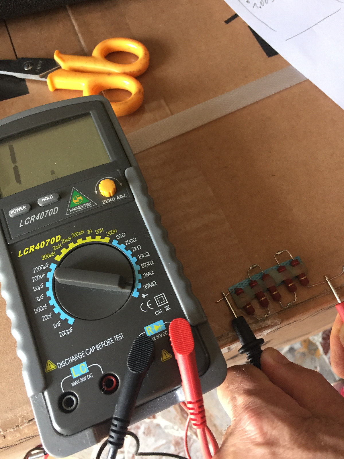

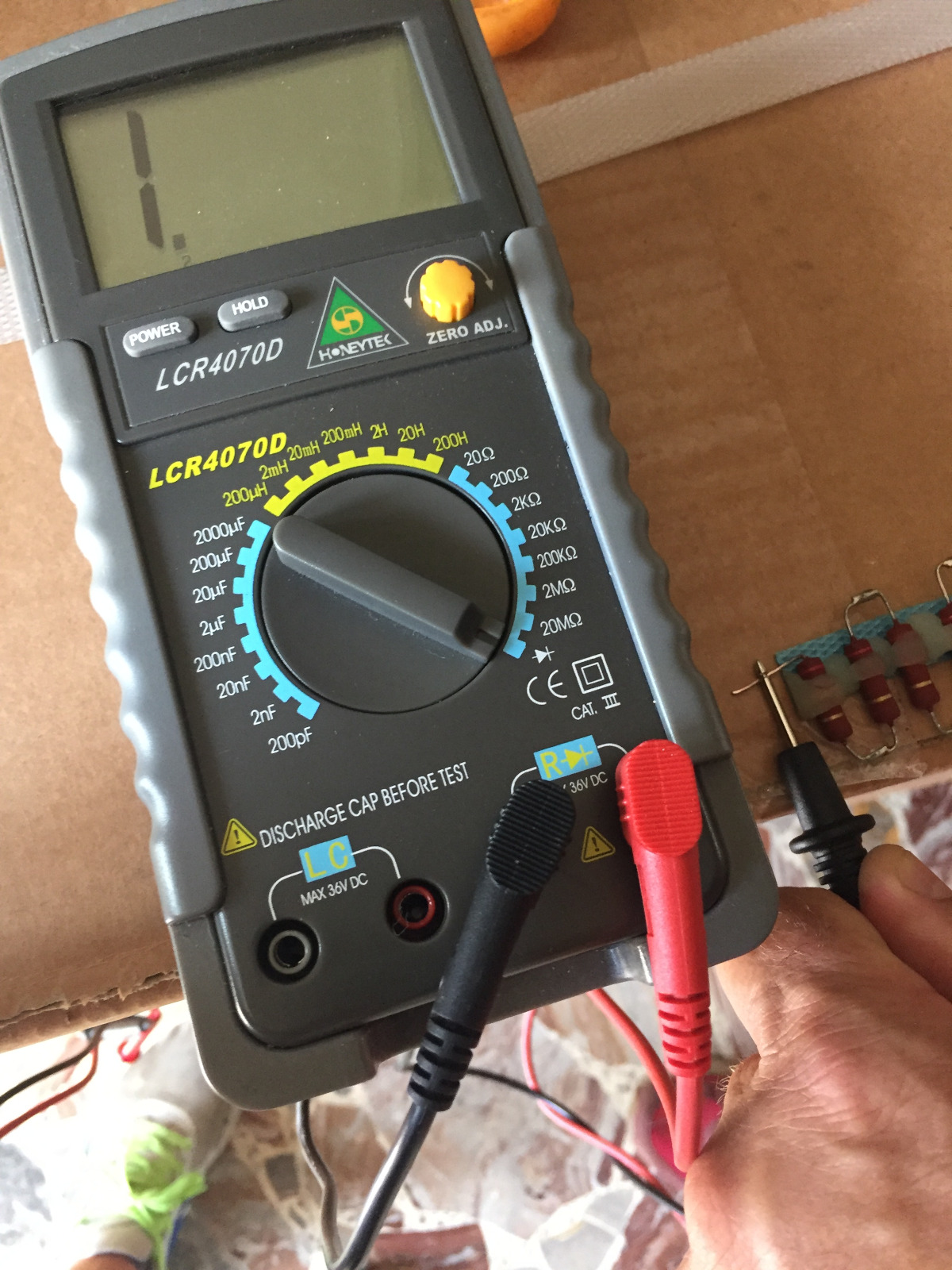

the resistors placed on the chassis outside the power supply area are almost all burned. They are two pairs of 5 for each speaker and only one group of 5 have continuity and a value of 136.7.
These resistors are not for the power supply but for the filtering/segmentation. The power supply is on the membrane, not on the stators.
The element is divided in three segments, one is the center 8 wires and the other two both sections left and right of the center section. The outer segments are wired in parallel. The center segment is connected directly to the audio transformers and emits the full audio spectrum. The outher ones are connected via the resistors. They form a low pass filter together with the capacitance of the ESL element, so the outer sections only radiate lower frequencies. This is to improve horizontal dispersion and to even out the frequency response. It also reduces the load on the amplifier.
With the resistors open, only the middle section will still work severely limiting output. Replace them and see what that brings.

You are measuring resistor with the tester on Diode!136.7.
Color code looks like yellow-purple-orange-gold, that is 47k with 5% tolerance. Makes sense, other models use 4 or 5 resistors of 27k-47k. Depends on the segmentation and the panel size.
Given their size, they will be rated for 1 or 2 Watt so order 2 Watt.

after separating and measuring them, the value of each is 26.8 each - only one is burned and therefore the reason that there was no continuity of all placed in line. probably that the others also have only one faulty.
I looked once again, could it be red-purple-orange-gold instead? That would be 27k. Makes more sense with the measurements too.
For a test you could just bypass the bad ones, so use only 4 per section. Saves you the trouble of ordering.
