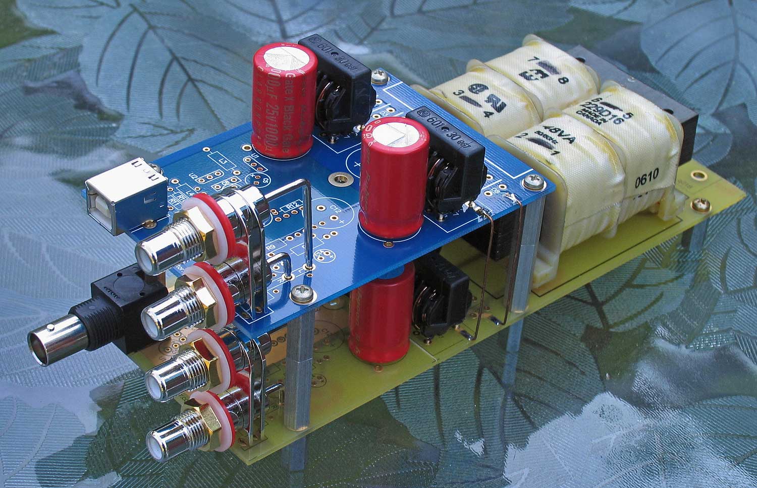

Yes, the price is correct.
In order to keep best performance, either USB or SPDIF versions are available separately only. You can however, stack two DACs, boards powering them off a single supply.

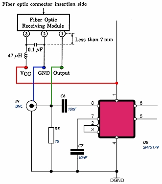

Hi Peter,
I have been using your USB DAC for a number of years now and I'm really happy with it. However, I want to make my setup more user friendly, having a meters long usb cable through the living room isn't that great anymore...
I am looking to connect it to an optical source (Airport Express). Is there any way to add that to the exisiting board, much like your stacked solution of adding USB to a SPDIF board (multiple inputs would be even better, but 1 would do also)?
Best regards,
Erik
Attached schematic shows how to do it. If you want to use existing 3V supply from a DAC, use TORX rated for 3.3V
