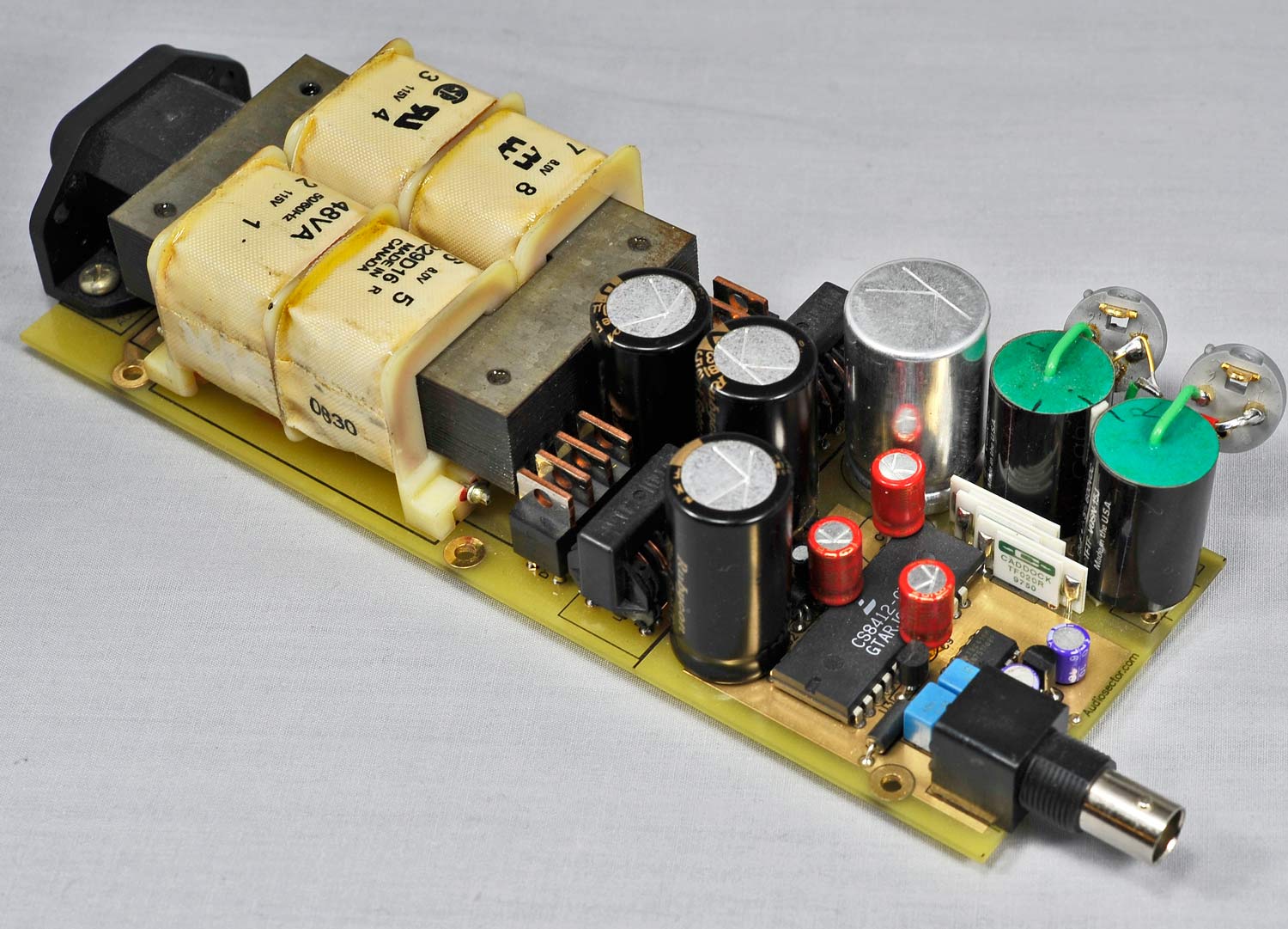

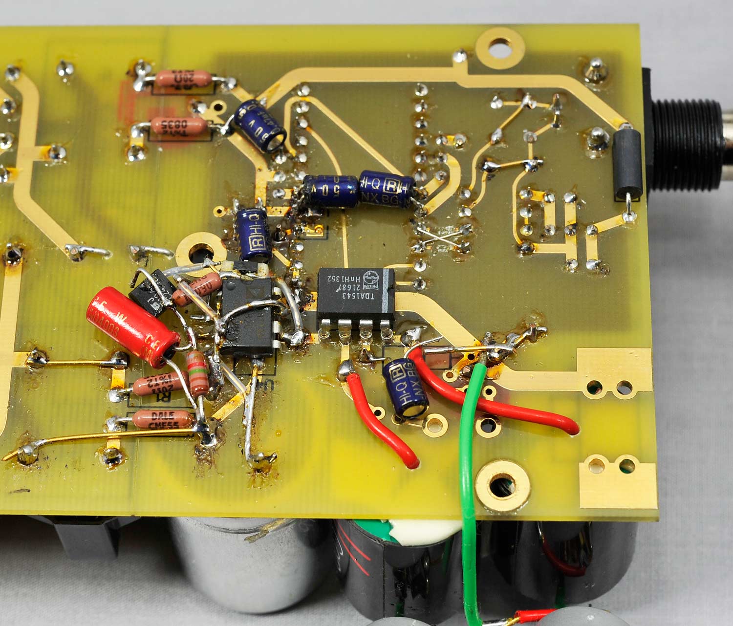

I've been experimenting with improving those DACs for quite some time now. The results are very promising and I wouldn't do it without an input from a forum member Bobken who spent countless hours tweaking his SPDIF DAC.
Attached pics show my personal SPDIF DAC, which I'm using currently with Shigaclone.

Peter,
would you be able to explain the mods you did to the DAC as shown in post 26 (bobken mods?)
