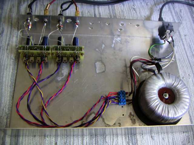

Time for a small review:
Puzzled by all those experiences (also mine, I must admit) with the need of "amp-driving-preamps" I made a small experiment.
First, I never really understood the need of a preamp together with a non-inverting really. To get some isolation from the source, ok, but if the source is nothing unknown there is no real difference between the input of the buffer or pre or the poweramp exept the fact that the amplifying feedback loop "is near". My NaimClones need the whole setup with pre and poweramp to sound at their best, but although the NaimClone pre is verx good itself, it never convinced me combined with a LM3875 Chipamp. And: There is always enough power by the sources themselves to drive the chipamps to absurd levels, so why use another possible harmful amplifying stage for nothing?
So I made a small "passive preamp" consisting of a very cheap chinese carbon 50k log pot, wired in the tradional way. I then connected my PD-DAC (very good, very musical, as most of you already know...) directly to this pot and then to my - still in an experimental aluminium frame mounted - premium amps. The transformer's values are 2 x 24V / 300VA, I use two secondaries splitted to the both channels with their own rectifiers (no hum at all, btw).
That sounds absolutely brilliant! Very transparent, almost unbelieveable clear, very musical and full. The "soundstage" is wide, and the bass is low and quite precise, not more slightly overblown than with other setups with these amps. The pot is not very linear especially turned down
So what can I say? If I must be convinced for the need of a preamp here - this will be a hard task. A transformer based stage I can possibly imagine - but this is too far out for to experiment with. If I was able to create such good sounding amps - say - 20 years earlier, this would have been a "small revolution". This humble setup tells me everything I need from the music and the recording, it reveals more information that I had expected.

That has to be the most tidy, minimalist amp I've seen. I never thought of wiring the psu to the amp board like that! Nice!
Thank you, Adolphe, but you did not see my other chipamps yet. They are mostly much smaller... and even more minimal. One of the next projects - not fully ready yet - will incorporate smd resistors soldered to the chips directly.

That's how I also plan to implement my chipamp with the chip board mounted to the rectifier board, albeit I was only going to use a single rectifier board for the pair of chips.
How do you have that transformer wired up? Is a single pair of secodaries paralled at that terminal strip, then feeding each rect. board?
Yes. I do not have good experiences - for what ever reasons - with common rectifiers for both channels. I once tried that, found the channel separation very poor, changed it and never tried it again since. I know this is contradictory to the general use and experience.
I used just two secondaries splitted to two full bridge rectifiers - like many amp producers I suppose. At least I know that practice from some Naim amps. And seperate transformers for each channel is probably better, but a 300VA torodial transformer should be enough for two amp channels. I have though very good experiences with full wave rectification (four diodes and four secondaries per channel!) but that cannot be called easy. (Please look at the webside by clicking the button below. This shows another chipamp with that configuration - with much cheaper parts than PD's but with a good sound nevertheless.)
To be honest: There is still a little hum (very little) with this "el cheapo" setup. But this can be cured by better screening (consider the passive pot with cables etc.) and a different grounding circuit. It is much better with the pot within the case of the amp of course to avoid the second pair of cable lenghth. This is the simplest configuration I would recommend. To create a high class "intergrated amp" with that setup is so incredible easy...
I should mention that PD uses Panasonic caps in the AudioZone Amp2, so this amp is - besides the case of course - similar to the Audiozone premium kits.
