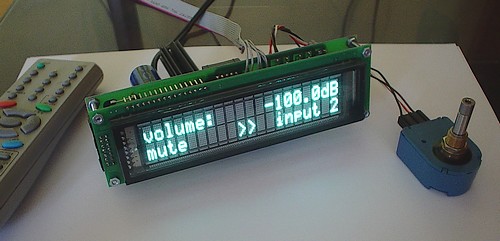

You can read about my experiments with passive volume controls here: http://www.diyaudio.com/forums/showthread.php?s=&threadid=73538&highlight=
The most recent one is getting closer to completion. Control interface was developed by Veteran:

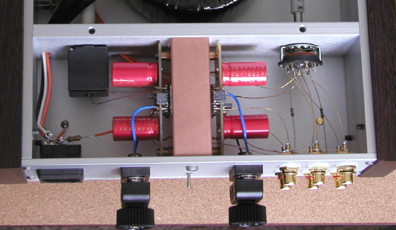

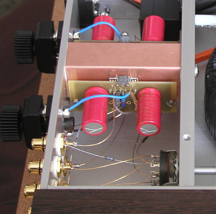

Could i use it between source cd player and Amplifier ? I want to use it as a buffer with a nice pot. ie a small simple volume pot. I'm using one now as a passive pot but want to see what a buffer sounds like with out causing to much distortion.
Jase
Is there a way to get a balanced buffer in any way ? Would there be difference ?
Would i use it before the volume pot or after ( sorry just added that question )
I had very good results with buffer installed directly at DAC output and the switching attenuator directly at amp's input (one IC only)
Thanks Peter..for the info! Man..that volume control looks sweet! Every time I turn around you've got something new out. It seems I'll never be able to keep up! 😀

Peter Daniel said:I had very good results with buffer installed directly at DAC output and the switching attenuator directly at amp's input (one IC only)
Do i need to buy 2 of these or one ? Ie 1 Board will do both channels..?
All i need to add would be a transformer ?
Jase
A kit includes two boards, so one set is good for stereo, two sets neded for balanced setup.
All you need is transformer indeed (plus input/output connectors)
