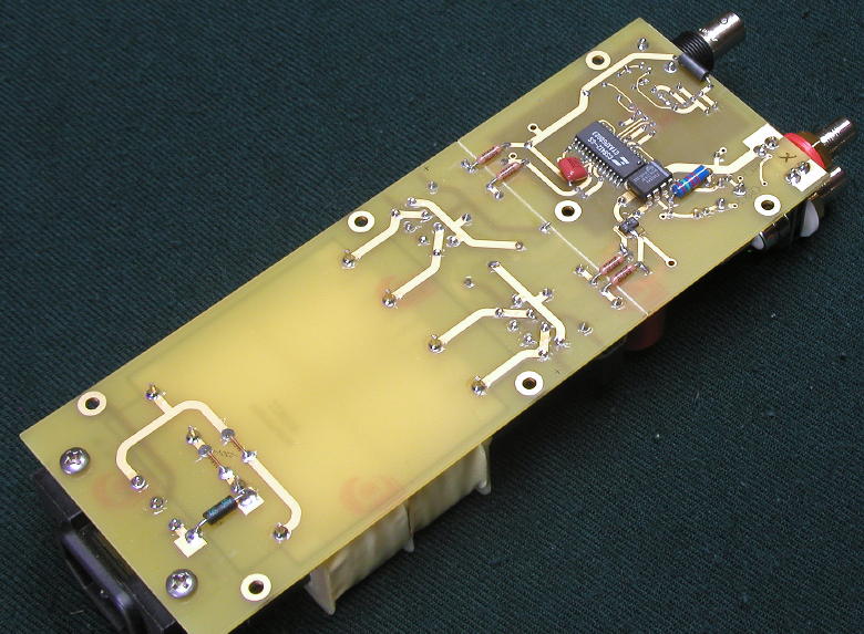

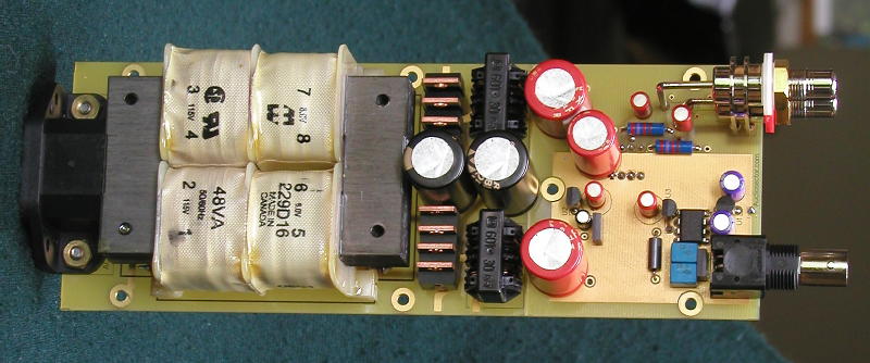

I uploaded a few more pictures here:

What are those red caps?

I was sort of "forced" to redesign the board, as I run out of DIP version of CS8412 receiver chip.
The new layout has been improved, with easier cap mounting and shorter PS and signal traces.
No major difference in overall design was made, as circuit has proven itself over the last 2 years and I don't see a way to improve it. One may experiment with I/V resistors and coupling cap choices, as will provide a slightly different sonic signature, but overall sound characteristic will remain unchanged.

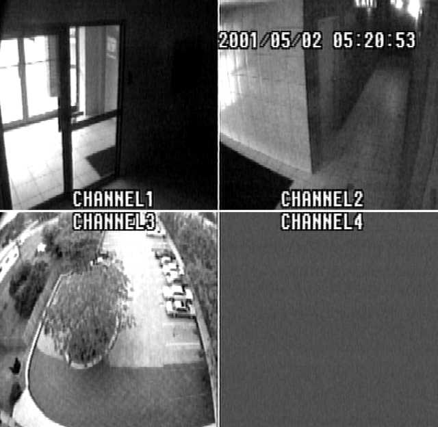

peter i will mail you the parts and money order next week, i made a mistake with one of my latest jobs and lost 6 cams do to lightning.
i forgot to ground the coaxial on one of the roof cams.
it was just a small fire.
and now i need to pay for the parts
hopefully i can replace the parts before the owner comes around
in the pic you can see my handmade roof cam i call it the hd cam or surround cam.
cheers
