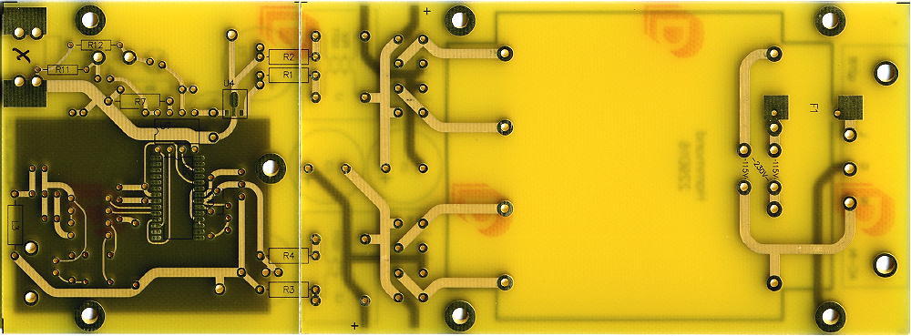

This is a redesigned board layout, accepting only SMD version of CS8412. I changed the value of the bypass caps to provide more open, faster sound. I have a feeling it will work well with new board layout. I also want to keep things simplified, less different cap values to deal with.
Besides that, the power supply traces have been also simplified, there is an option for BG N 1000/50 main filter caps (two of them mount outside the board), bleeder resistor option added after coupling caps (R11/R12, but I don't feel they needed), additional holes for Caddock TF020 in I/V, and improved layout of high voltage traces on transformer's primary (with two holes for proper fuse mounting). I didn't asembled any of the new boards yet, but I hope the layout is OK
C10 mounts on a bottom, attached directly to pins of R6 and C8. R6 is 220R now. As usually, with BG N short lead (NON POLAR print side) is recommended to mount on + side.

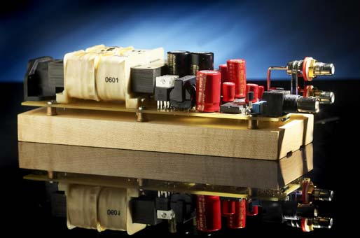

DAC kit
Great looking photo.
What's the current USD price with the Hammond 50W, Cardas dual RCAs and power module?
-Rob
Peter Daniel said:The chassis is not really needed here, I like to mount the DAC on a maple board only (Hammond 50W transformer, Cardas dual RCAs and power module are not included in a kit price but are also available).
-Rob

Could someone do a brief check on the boards, please. I haven't powered up the DAC yet. Well.. I guess I didn't screw up anything and I can always get new parts if I fry something.
Instead of using one 4,7 uF cap in the output I used two as super-E-Caps. The solder joint fuse was a great idea but not suitable for 230 V. I soldered the fuse holders sideways. I first tried soldering a fuse straight to the board but the fuse broke when heated. All in all this was a very straight forward job and I didn't have any problems building the board.

The components look like they are installed correctly. Regarding the fuse, although it's rated 125V it should work fine with 230V. I asked Upupa Epops about it and he confirmed.

Thanks Peter for checking my work. Voltage rating was one thing but current rating was another. It was a 2 A fuse which means 460 W power with 230 V (10 times tranformer power rating). I didn't wan't to take any chances with high impedance faults...
