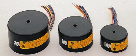

And now some questions. For dual mono, in your opinion, what’s the best solution? One 300va toroide or two smaller ones, one for each channel? One or two rectifier boards? Have ever used capsuled toroides like the one in the photo? Are they any good? Can I put the two power supplies in the same enclosure with the amp, or is it better to separate them?

300VA toroids can be still regarded as small, so I would recommend them for monoblocks as well. The best approach would be using separate transformer per amp, if not a single transformer for two channels (300-400VA) with shared rectifiers board. I only use toroids with those amps, the quality of sound depends on transformer as well, I like Plitrons.
