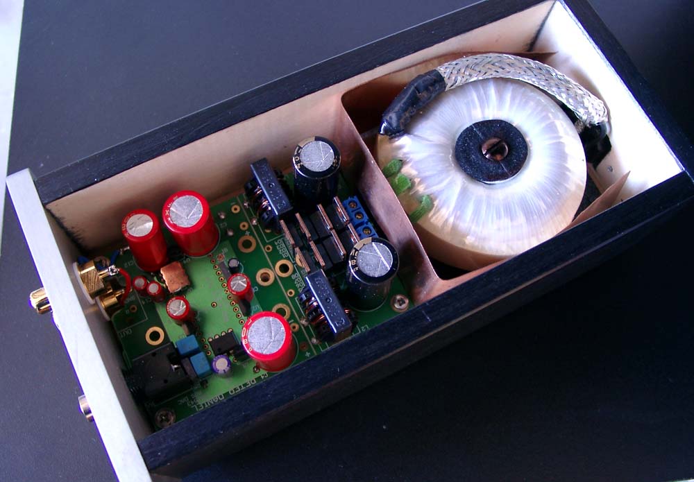

DAC RCA Output
I forgot to order the dual RCA output with my Greenboard DAC kit from Peter
- i have a dual cardas but it doesnt fit the greenboard layout.
i did remember to order the input socket & it fits neatly into the board.
anyone know if i can find a board mounted dual output rca in the UK that fits the greenboard ? i wanted to go enclosure-less, so it is much neater if i can manage this.

There are dual RCAs available from DigiKey that fit green board but those are even worse than home made ones.
Vampire Wire also carries the dual type that probably fits the board: http://vampirewire.com/mcart/index.cgi?code=3&page=2&cat=5
