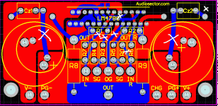

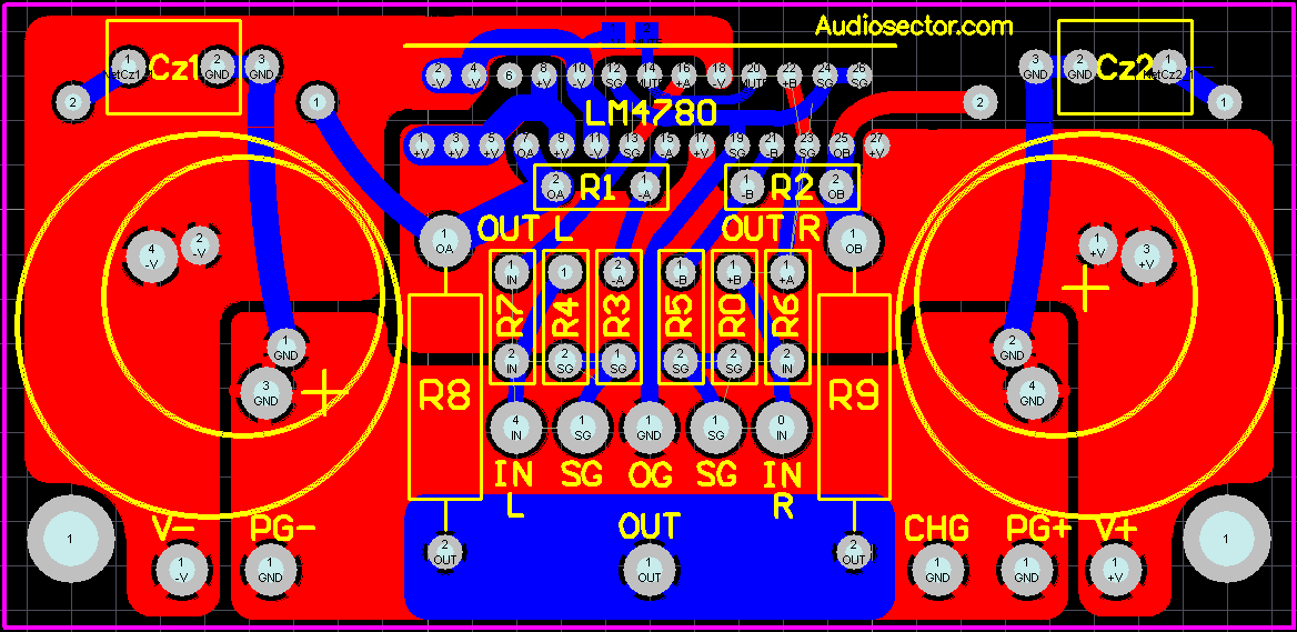

I'm slowly running out of LM4780 boards, and i was considering a revision, with updated layout, accomodating all 3 options: parallel, balanced and stereo.
If balanced would be to implemented, the board does not use inverted method (like per AL-1192 notes), but both halves are non inverting and additional circuit is required.
I will be comming with balanced active line stage, so that could be used there, or I might include a small board, implementing LM6172 for buffering and phase splitting.

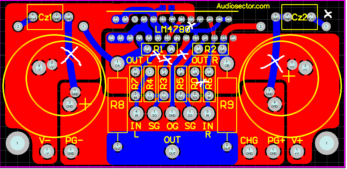

Below is the proposed layout I was working on yesterday. As you see, the signal traces lengths are substantially reduced, there is more separation (in layout) between both sections and the chip can be also used in stereo mode, providing same funsctionality as two LM3886 chips.
If stereo or balanced operation is looked for, the balast resistors are not required and output is taken directly before those output resistors. In case of parallel operation, resistors should be in place and there is one output only.
The signal grounding is very symetrical for both channels and also simplified.
I plan to do mirrored boards (2 amp board per one main board, as usually). So if someone uses boards for balanced operation, they can be put back to back with PS connections aligned for paralleling. A multiple number of such parallel modules could be connected in parallel (with bus wires for supply) providing simple power distribution scheme and high power.
The accompanying PS board will feature all presently popular options (large caps and snubbers)😉
As usually, all comments and suggestions are welcome. It will be at least a month before those boards become available.

Peter i notice on all your boards so far that your lines are not neat and tidy there in difrent ways and if not rout there squiggly ? How come ?
Joined 2002
Those are probably bugs in a program, or maybe it depends how it's opened. But when I print it, it looks fine. Besides, it's still work in progress, so I'm not concerned with those small imperfections.
Joined 2002
How about an option for T0220 output resistors? We can't get Mills that easily over here, but the Vishay thick film are very good and an excellent substitution.
What is the price on those Vishay TO-220 resistors, any links?
If it's a standard TO-220 package, there shouldn't be a problem to implement it.
Go to RS components, and search for "Film Resistors 20W Type RTO 20". The site is session based, so I can't give you a direct link, sorry.
