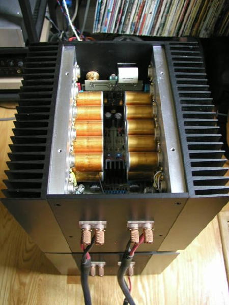

Peter,
You are a very talented mechanical designer. Have you given any thought to perhaps adding chassis/enclosures for non gainclone amplifiers? Based on the response to the group buys jrsun sponsors there may be a market for a sturdy, well designed chassis for a 100 watt class A or 200 watt AB amplifier. I dislike (but really have no choice) the chassis fabrication when DIYing an amp. I have been on Google and there are just very few manufacturers who offer this type of product.
I checked WIKI page started by jrsun and it seems like are only 5 inquieries with regards to big amp chassis. I don't think such chassis would be very popular.
It is my opinion that the chassis I created for A-75 amp was the simplest approach, and it presented itself quite nicely, but even simple chassis like that is quite expensive to make.
You have to buy at least 100 heatsink extrusions to qualify for $50 price, then fabricating additional panels and brackets might run you another $100. So we already up to $200 per chassis. To make the offer profitable, I would have to be selling it for at least $300, but even then all the trouble with packaging and shipping such big item doesn't make it appealing at all.
One way to do it, would be creating a kit that is used with a given heatsink extrusion and size (while everybody interested would orders heatsinks personally from a same vendor like it was done in a past: R-Theta group buy). But this would require to drill holes in the heatsinks by the end user and complicates the assembly.
Considering all the hard work and trouble involved in organizing and delivering such kit, there is simply no profit in it.

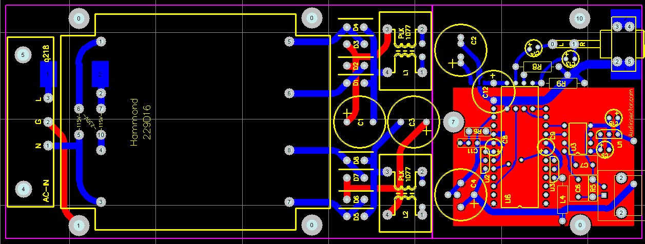

It looks like the DAC board is finaly done. I will be ordering it this week. Here's a pic.
I calculated the cost of the parts in the Premium version (that I'm currently using) and it gets pretty close to $200, including transformer. 1/3 rd of it is due to 4pcs of 1000/25 BG NX and MSR860. The diodes are almost $2/pc in 100pc quantities, which was quite surprising, considering much lower cost of MUR860.
There will be a scoring line, that can separate PS section from the actual DAC circuit. As you see, the PS takes 2/3rds of the board area. The width allows fitting it inside 2 x 3 aluminum square tubing. Transformer can be set with jumpers for dual voltage.

... MSR860. The diodes are almost $2/pc in 100pc quantities
Peter, have you looked at the IR HFA08TB60. Pretty much the same thing as MSR860, but down to $1.40/pc in quantity.
IR HFA08TB60
Actually I tested those diodes once: http://www.diyaudio.com/forums/showthread.php?postid=134309#post134309
They were not as good as MUR860. MUR860 are also better than MSR860 for GC amps. It's only for digital that I prefer 'S' version. The difference is not that big, yet it is worthwhile if you want to get the most out of your setup.
I'm pretty sure there are cheaper, equaly good diodes, I just didn't have a chance to find them yet.

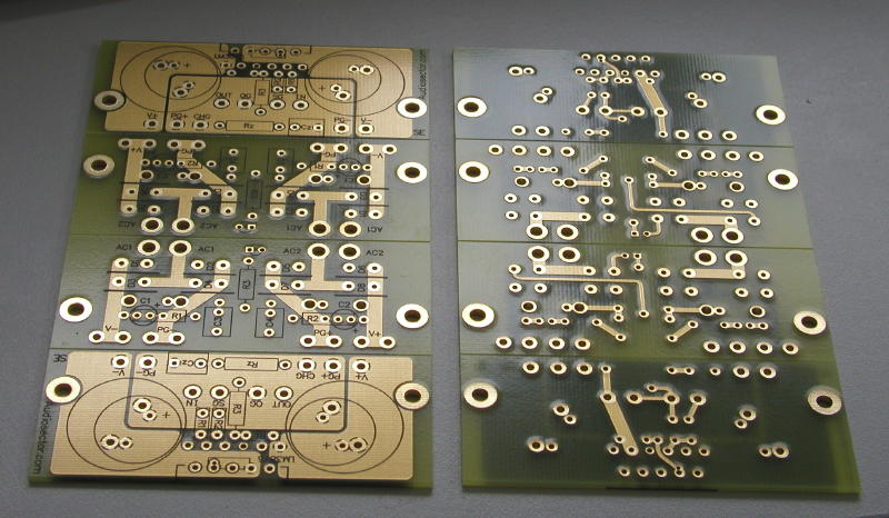

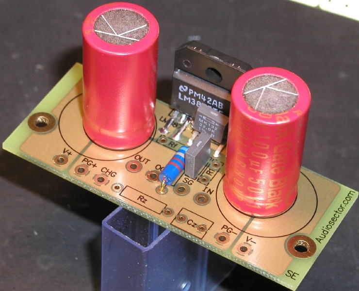

The most important new feature is additional spot for feedback resistor (you can see extra hole between chip pins). This allows for very easy mounting of that resistor, yet keeping conections extremally short. The other resistor lead solders directly to pin 3 of the chip.
All the usual snubber PS parts can be mounted directly to rectifiers board as well, including 10,000u caps.
Dang Peter, those are some beautiful looking boards. I think it's pretty much mandatory to put a board like that in a case with some acrylic, so you can see it 😀
If I didn't have so many dang gainclone variants laying around, I'd buy quite a few from you.. (I've got some 3875 and 4780 BrianGT boards, along with a ton of 3886 Digi01 boards). Damn you for tempting me!
I still may have to order a set to put in an acrylic enclosure and just call it art.

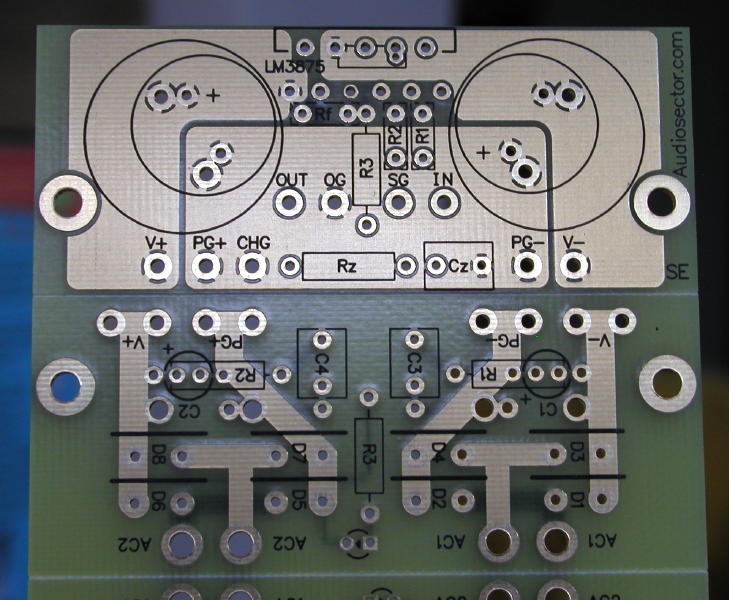

Yeah, that board looks indeed refreshing, comparing to all the red we had so far. When you break it in small pieces it looks even better. This is my current preference: no series resistor, BG N 100/50 caps and of course no Zobel (althogh it can be implemented)
PS: There was an inquiery about reg, so it may be sold.

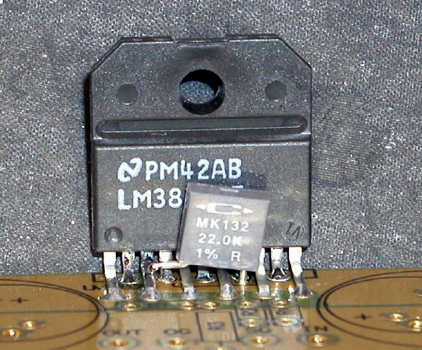

Here's a close up on feedback resistor. It mounts very easy, in closest possible way to the chip. The procedure doesn't require any special tools and is easily repeatable. I believe it's the most practical method for mounting that resistor.
Pin 5 is not connected (internaly) so there is no danger of a short.

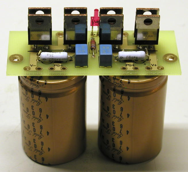

Now, here's the PS board. It's still the same size as previously, yet allows all the variations of the snubber and big caps (up to 35mm dia). There is a LED output on board as well.
The spacing on output connectors are the same as on the amp board, so piggy backing is still possible 😉
BTW, this board allows everything that Brian's LM3886 special supply board does (but in more compact format). I will fabricate extra pieces (just for the PS), so anybody willing to upgrade previously bought version will be able to do that.
