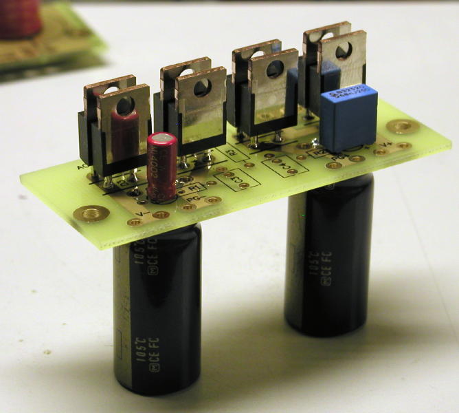

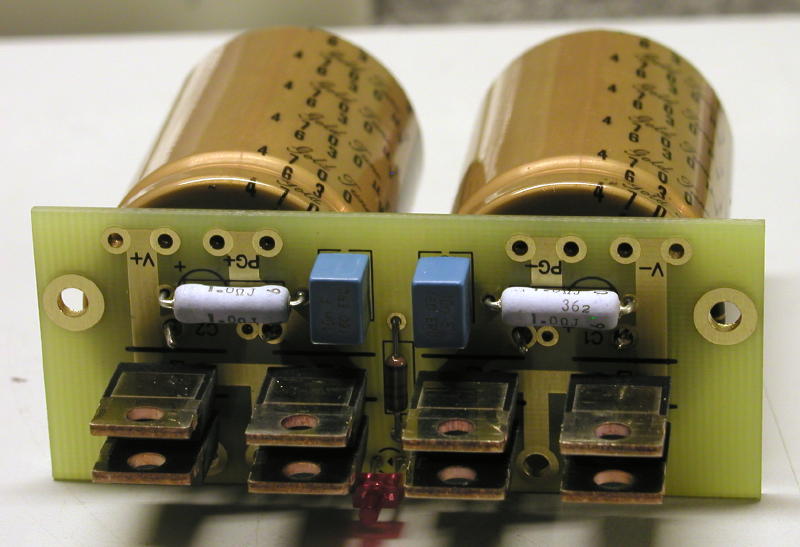

The position of the big caps allows to mount this board horizontally as well, if space is concern. In order to accomodate those extra snubber components, I simply moved diodes closer together (comparing to previous versions). I also reduced the hole sizes (for the diodes) so it will be easier to mount them this time.
Now the best part. As I mentioned already somwhere else, I'm not that crazy about snubber anymore, and prefer not to use it. I'm getting very good results with AC power and single 100u BG N caps, but with some efficient speakers it may create slight hum of the drivers, or some might prefer more substantial bass signature. So I made extra holes for 1500u Panasonics which can be used together with those 100u caps (preferably BG N) on amp's board. Also, when snubber isn't used, variety of bypass caps are possible to mount in that place, with spacing ranging from 200-400mil.

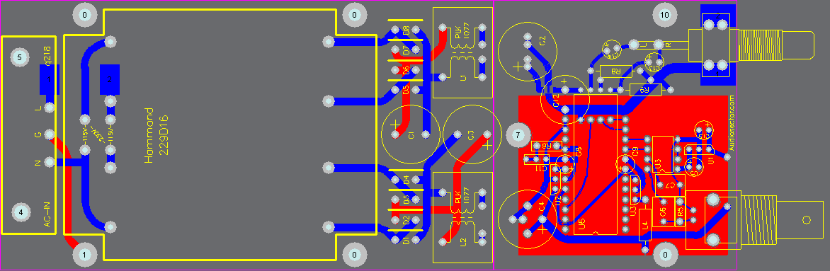

Peter Daniel said:I ordered the boards this week, they should be ready the next. Before taking orders I want to show the actual boards. Here's the current layout:
Where are the connections to tie the transformer board to the main board? I see the small pads under the caps, but you might want larger pads if you are going to wire the board to a battery setup or other power supply setup.
Brian
When you do screen shot, it does not show bottom layer components. This is one board with a scoring line, in case somebody wants to use just the DAC section. I hope the scoring line might also partialy break vibrations transfer from transformer, if such occur. There are 4 series resistors on the bottom, between coils and caps, connecting both sections.
There are jumpers on transformer primary, to set dual voltages. At present, it seems that AC power is actually better than running the DAC from bateries, but again, it will depend on batteries used and quality of the mains.
The board will require a bit advanced assembly procedure, as 4 pins on receiver have to be cut off (to make room for other traces), the bypass caps on the receiver need to be soldered directly to its PS pins, there is one SMD regulator (for ths DAC: in order to disipate heat better, and because there was no room for TO-92 package), the bypass cap on DAC goes over the receiver chip. This is a bit of a 3-D layout, but not confusing in any way. All those choices were made in order to simplify signal paths and possibly improve performance 😉
The board accepts only through hole version of CS8412 (and I have at least 100pcs of those chips available). It will be also gold plated, with clear mask.
There will be another board made as well, accomodating both versions of receiver, and without transformer on board. This board will feature on board regulators for batteries recharging.
