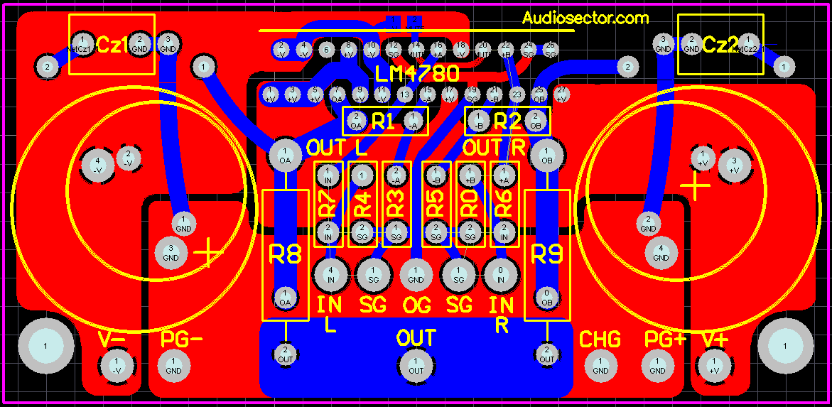

Peter Daniel said:I'm slowly running out of LM4780 boards, and i was considering a revision, with updated layout, accomodating all 3 options: parallel, balanced and stereo.
If balanced would be to implemented, the board does not use inverted method (like per AL-1192 notes), but both halves are non inverting and additional circuit is required.
I will be comming with balanced active line stage, so that could be used there, or I might include a small board, implementing LM6172 for buffering and phase splitting.
Below is the proposed layout I was working on yesterday. As you see, the signal traces lengths are substantially reduced, there is more separation (in layout) between both sections and the chip can be also used in stereo mode, providing same funsctionality as two LM3886 chips.
If stereo or balanced operation is looked for, the balast resistors are not required and output is taken directly before those output resistors. In case of parallel operation, resistors should be in place and there is one output only.
The signal grounding is very symetrical for both channels and also simplified.
I plan to do mirrored boards (2 amp board per one main board, as usually). So if someone uses boards for balanced operation, they can be put back to back with PS connections aligned for paralleling. A multiple number of such parallel modules could be connected in parallel (with bus wires for supply) providing simple power distribution scheme and high power.
The accompanying PS board will feature all presently popular options (large caps and snubbers)😉
As usually, all comments and suggestions are welcome. It will be at least a month before those boards become available.
Peter,
I like your layout. I very much like your thinking ahead for multiple uses, if you can pull that off without getting an awkward board, that'll be great.

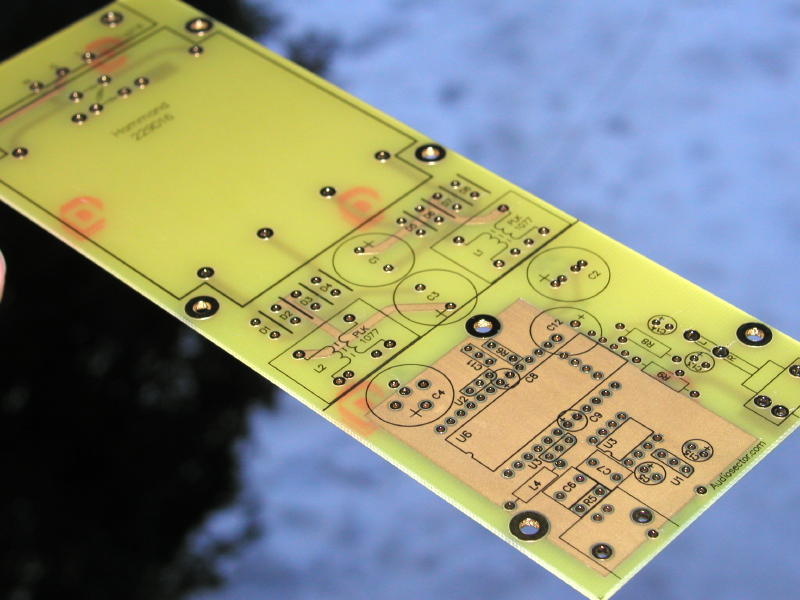

Peter, what are the (approximate) dimensions of the DAC PCB?
Then, I can start hunting for an enclosure.
It's 7.35 x 2.7". It fits inside 2 x 3 aluminum square tubing. I didn't call the place yet, but those boards should be ready for tomorrow.

Peter, that layout looks great. One thing though 🙂 Please consider placing an extra pad on the resistor footprints to allow proper mounting of standard resistors with 300 mil lead spacing. That way it will be possible to build both a high-grade version with caddocks/vishays or a more standard version with standard metal film resistors. Shouldn't be much of a problem and it makes the board a lot more versatile IMHO 🙂
/U.
/U.
Actually that board was never really designed with Caddocks or Vishays in mind (although they fit there perfectly). With the kits Brian and me are selling, we are using those 0.5W resistors from Phoenix. They have 0.134" length and fit well in 200mil footprint: http://dkc3.digikey.com/PDF/T051/1011.pdf
If there is more interest in 300mil footprints, I might try to implement it, but this will somewhat affect the planes, which are already looking like Swiss cheese😉

Peter,
I would be interested in either a DAC kit with the board and critical parts or a full premium kit, depending on my finances. 😀
Would the power and input transformers come with the partial kit? Sometimes it's hard to find parts like this that fit exactly in the circuit board's holes. Then you have to buy and pay extra to ship the same parts anyway.
Thanks,
KT
Thanks,
KT
KT,
I should be able to deliver any parts needed for the DAC. It does not feature input transformer though, I prefered the sound with an active driver.
