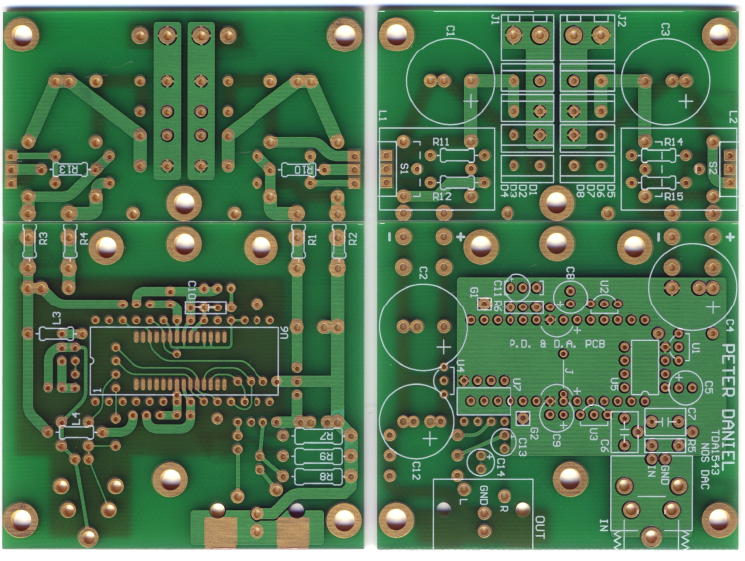

Are there any major audible diffrences between the two DAC's that you've posted? I really like the layout of the second one even more so than the first.
Mike
Mike
I still didn't receive those boards yet, but I expect the package any day now.
The circuit and the parts are exactly the same for both boards (with exception of one less OsCon for the green one).

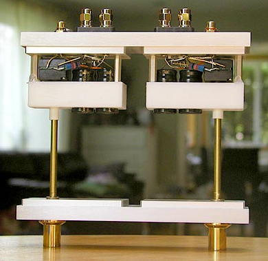

The inclosure is pretty simple, yet functional. I'm using 3 x 2 aluminum tubing, with end caps attached, sort of Amp-1 styling
__________________
How do you actually attach those endcaps? I can't see any screws, and I don't think they're glued🙂
The ones in a pictures were actually glued. This was prototype and I didn't have the time to order machined pieces, so I cut them myself from 1/4" plate. The front plate can be mounted permanently and the board is only attached to rear plate and slides out. The rear panel is attached to board, the board attached to the bottom with 6 screws.
However, in a final version both plates will have milled out notch that goes inside tubing and is press fitted. One screw on bottom will provide additional security.
This is the same way that AMP1 and PS are made.

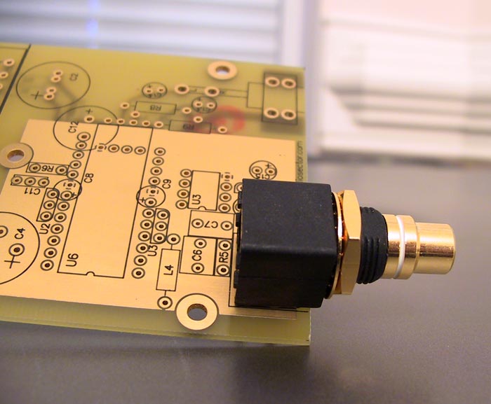

Received the boards today. The gold on the boards looks great with the clear soldermask, much better than the pictures!
I hope to put the dac together soon 🙂
