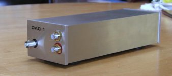

I made DAC enclosure prototype today. It's pretty straight forward, and no milling is required. If the tube length is chosen properly, attaching font and rear panels can be done by means of on board connectors: RCAs and power module. Additionally, front panel can be glued permanently, rear one provides access to the inside.
The finish is by brushing (on belt sander) and applying alodine, which gives the stainless steel look to the aluminum.
