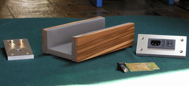

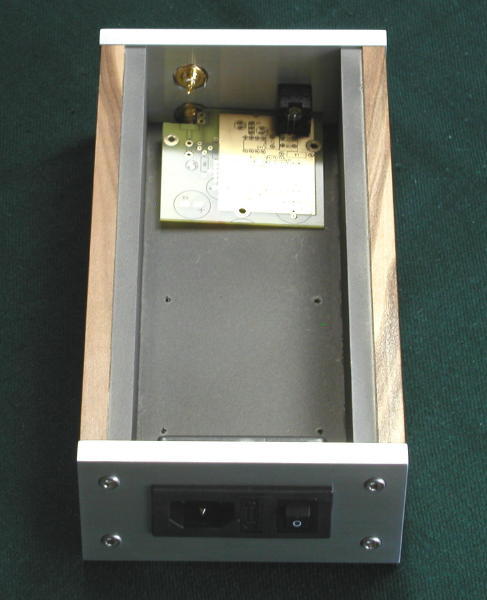

Sure I prefer wood, but this one is easier to make. This is for AudioZone DACs, and it matches Amp-1 appearance. My personal unit is without any case, just resting on a piece of acrylic.
With a board in a metal case, the sound becomes a bit less open. Not a bigh difference, but still noticable.
Peter,
What method are you using to transfer the "DAC-1" lettering to the aluminum plate? Been trying to figure out how I'm going to get lettering on my pre-amp chassis!
Terry
Terry
I'm using dry transfer method and sheets with lettering can be bought at graphic supply outlets: http://www.diyaudio.com/forums/attachment.php?s=&postid=62789&stamp=1032685651

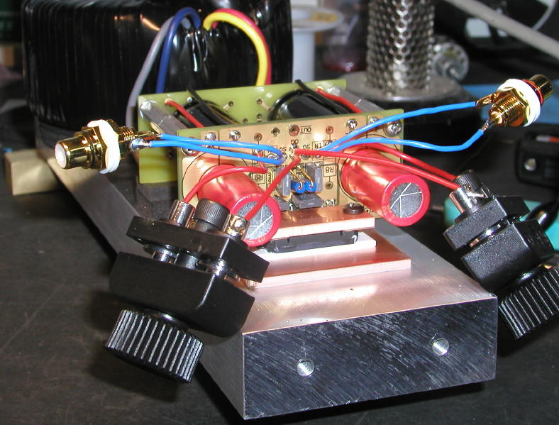

Soon a new board will be available from AudioSector.com
It is a replacement for a previous parallel only LM4780 board. The new board allows all 3 configurations: stereo, bridged and parallel.
I'm testing it presently in a stereo version, and it sounds very good. The price of the new board will be $25, featuring as usually 2 amp channels, as well snubber option for PS. I will be also offering half of that board only (for half the price), allowing to build a stereo amp (like the one in a picture), using one LM4780 chip.
Copper spreader was used to improve heat release from a chip.

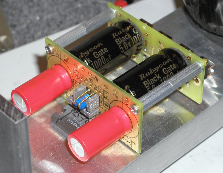

Here's a closer look at the complete assembly. 1000/50 caps are mounted directly to rectifiers board and that board is attached to amp's board using standoffs, forming a one piece module. 100/50 caps are mounted directly at the chip and all the connections are minimized.

I was working recently on a different enclosure for a DAC, and here's how it looks.
The side panels are made out of Red Gum wood, the bottom made of Balic Birch and thin metal plate attached (mostly for cosmetic reasons). Front and rear panels are machined from 3/8 aluminum and alodined.
