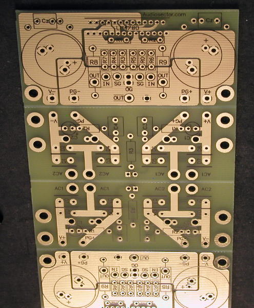

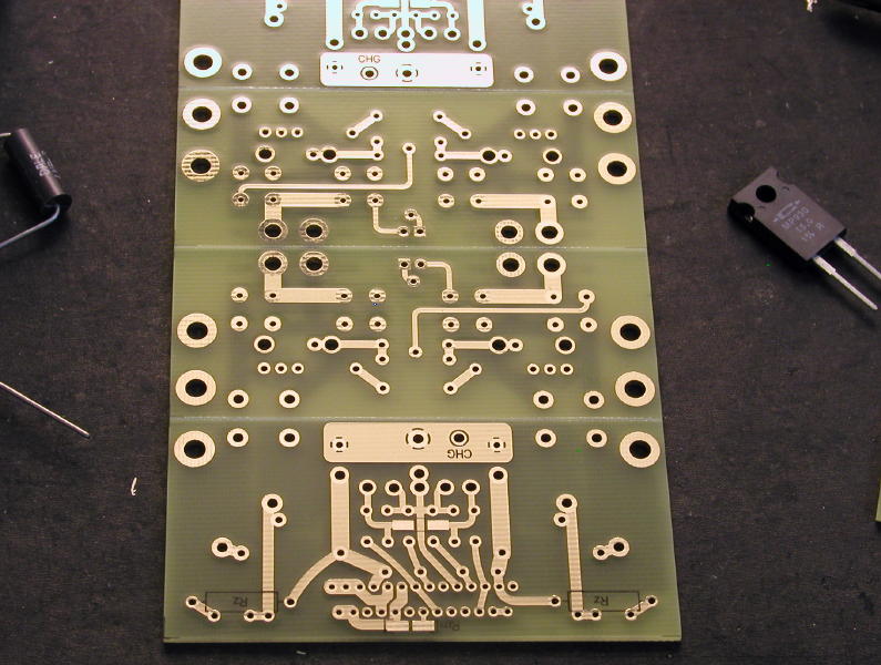

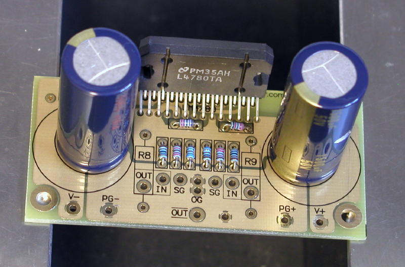

Starting last week, a new LM4780 board is being shipped with the kits. The price didn't change yet, and will be the same untill weekend's over, after that it increases to $25/board.
The main upgrade here is improvement in PS section, so more options, including snubber, can be implemented. The idea is the same as with my LM3875 board, which I described here: http://www.diyaudio.com/forums/showthread.php?postid=584429#post584429
Also the amp section is more flexible now, allowing to use all 3 possible conigurations: stereo, bridged and parallel.

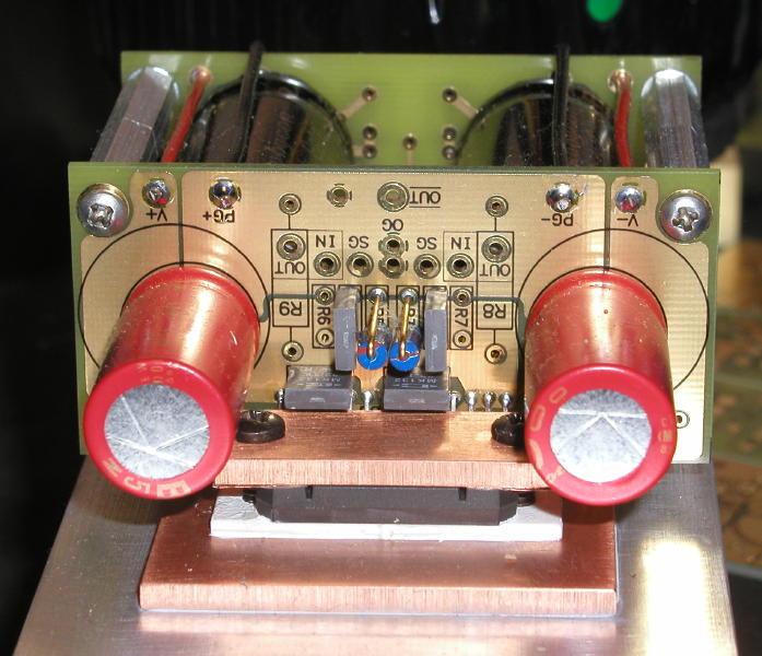

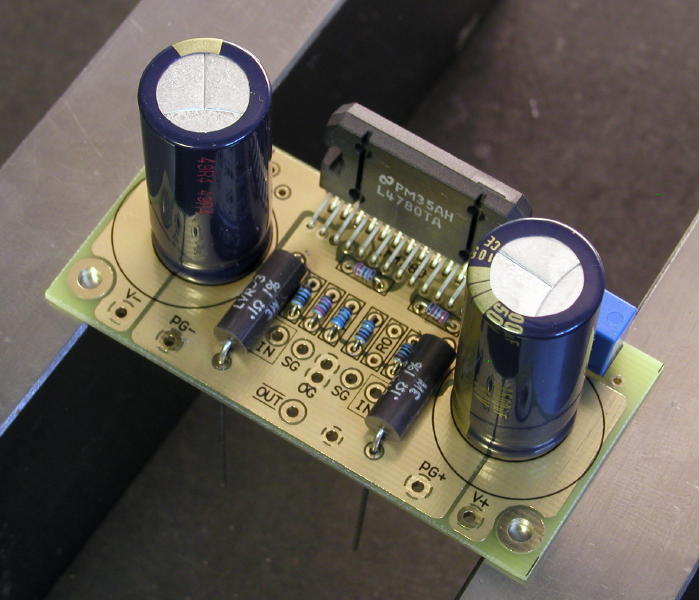

Here's a pic of a stereo setup. Input and output (for each channel) are marked by IN and OUT (in a same outline), SG is for signal ground connection. There are two output ground (OG) hookup points (one for each channel).
The resistors values are as follows:
R3/R5 680R
R0/R4 22k
R6/R7 1k (lower value, down to 200R can be used instead)
R1/R2 22k
No output resistors (0.1R) are used with stereo setup. Same configuration applies to bridge setup, as long as balanced source is connected.
One board allows two separate stereo applications ( which can be suitable for bi amping) and one stereo bridged application.
I will be able to supply 1/2 of the main board only as well (for single stereo application).

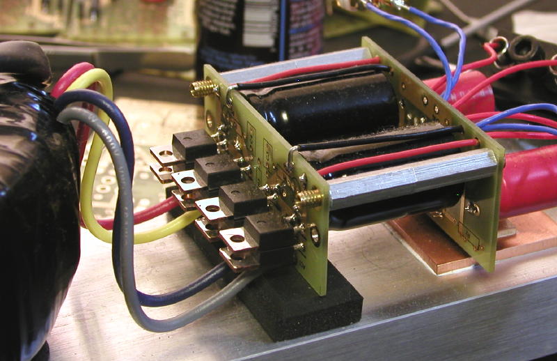

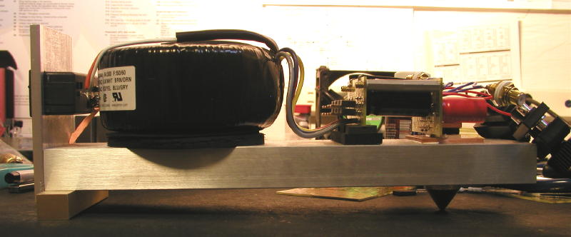

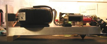

A very simple chassis can be built using minimum skills and resources. The main structural support is provided by 1 x 3 flat bar, about 12" long. There is another small bar in a back, creating footing and a single cone in front ( directly under the chip location). A flat piece of aluminum creates rear panel, where power module (with a switch and fuse) is installed. A similar panel in front (I didn't install it yet), supports input and output jacks.
I didn't notice any hum or interferences with that type of open design chassis, and the sound is very pure without the veil and coloration that more fancy builds impose. ;)
