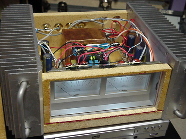

Peter, thanks for your response. Actually, my casing will be aluminum on all 4 sides. The left and right side where the amp is going to be attached to is 4" (H) X 8.5" (D) X 0.5" (thick), and the front and back is 4" (H) X 11.5" (W) X 0.25" (thick). I would rather not add fins if possible. The bottom will be a piece of wood off a nice chopping board and to show your beautiful PCB, the top will probably be acrylic.
My speakers are a pair of Epos ES11 which I believe they are about 87-88 dB sensitivity. No idea on impedance though, but I guess it will depend on the music played too.

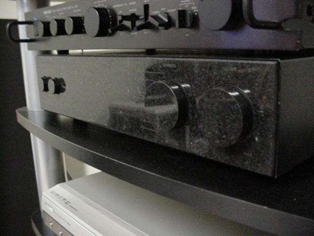

sweet and i have the case to complement it😀 marble.

If you ensure good thermal transfer between all those panels (angles or bars, or proper contact surface) I don't think you would experience any problems.
