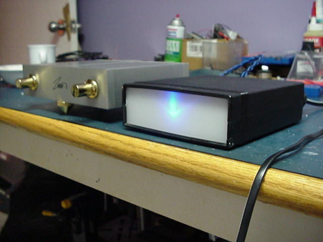

It would be great if you could someday replace that front with a brushed 10mm thick alu plate to match the amp 🙂

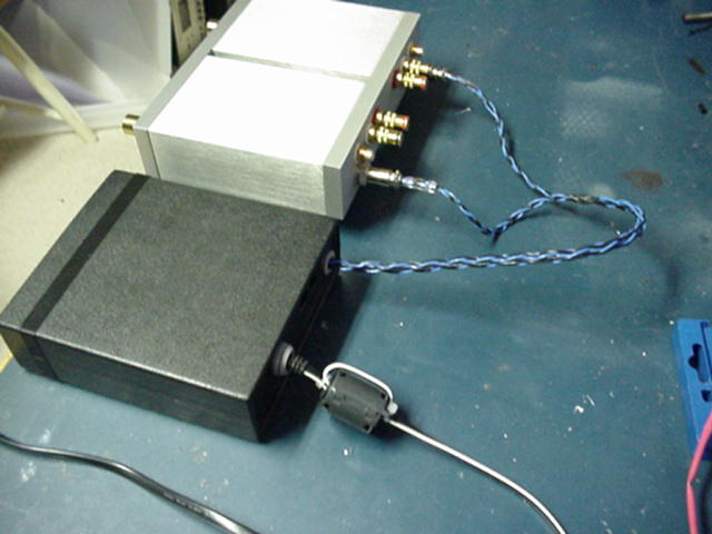

karma said:peter i finished the psu what do you
think😀
Looks good. I'm also working on a new PS enclosure for Patek amp, will post some pics soon.
