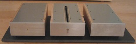

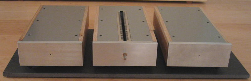

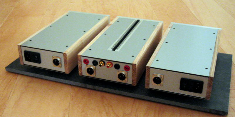

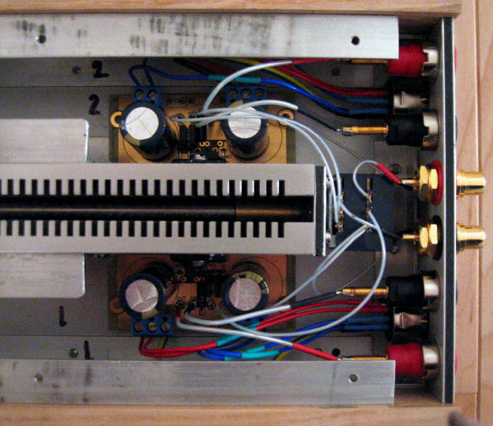

Peter,Peter Daniel said:But what I find particularly interesting is the way potentiometer is mounted and shaft extender run between the heatsinks (including the cutout in top panel).
What is he using the potentiometer for? Is it just an input signal attenuator? (looks like an Alps?)

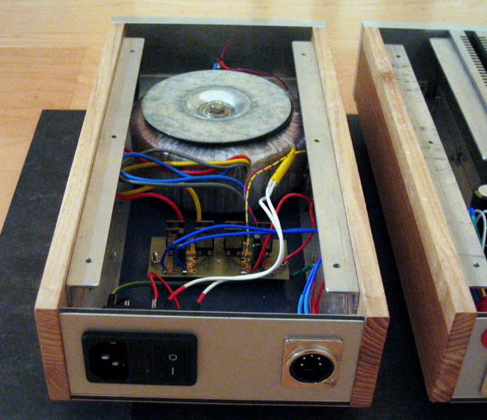

The twin external PSUs may be a bit of overkill, but it looks great! Is he using a regulated, or snubberized PSU in each one.....or just the rectifier boards? Any pics inside the PSUs?
The design is extremely nice, and very carefully executed. Very reminescent of some of your incredible case work. Those have to be the shortest heatsink fins I've ever seen, but the effect is stunning!

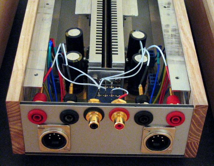

Peter Daniel said:The difference between dual mono and stereo is the number of rectifier boards used in powering the amp. In stereo, both channels are powered from the same board, in dual mono each channel has its own separate board.
While in stereo setups with a single transformer you could still use two separate boards, on more than one occasion I had reports of humming supply so I always recommend using a single rectifier board.
That's also what I'm doing in all my stereo amps and in the picture below I'm showing trouble free way to connect power grounds: output grounds of both channels (OG) are connected with a piece of thick copper wire. Central point on that wire is power star ground and all 4 ground wires from rectifiers board (PG+, PG+ and PG-, PG-) are connected here. Output grounds are taken directly from the board, signal ground connects to the point on the board marked as SG.
Those boards were designed with dual mono operation in mind and as such they work well without any mods.
I dont get it, so i need to ground PG+, PG- and both OG with an 10R resistor.
PG+, PG- and OG are all connected on amp board (with ground plane). The chassis is usually connected to earth ground (third pin from AC connector) and the amp ground connects to the chassis through 10R resistor.
Approximatly how many watt does the 10R resistor need to handle?
