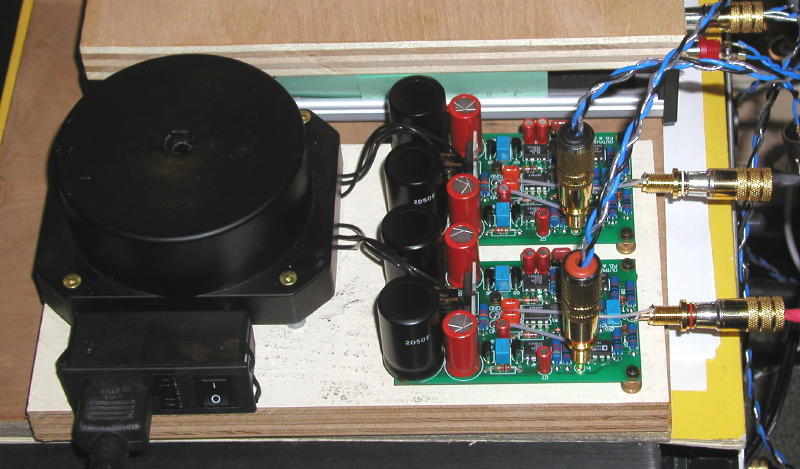

The buffer circuit has been tested today, and I'm greatly impressed. Together with a passive Placette, it is way better than my modified Levinson 380S. The sound acquired completely new dimension, resolution is improved, but what most important, the melody lines are much better pronounced now. Each instrument and each sound exists in it's own space and has now complete freedom of expression. Small details, that were not noticed previously, are more obvious now. 😉
Interestingly, I placed the buffer between DAC and the Placette (10k input imp). I didn't try it the other way, but what I hear, seems to be rather hard to improve 😉

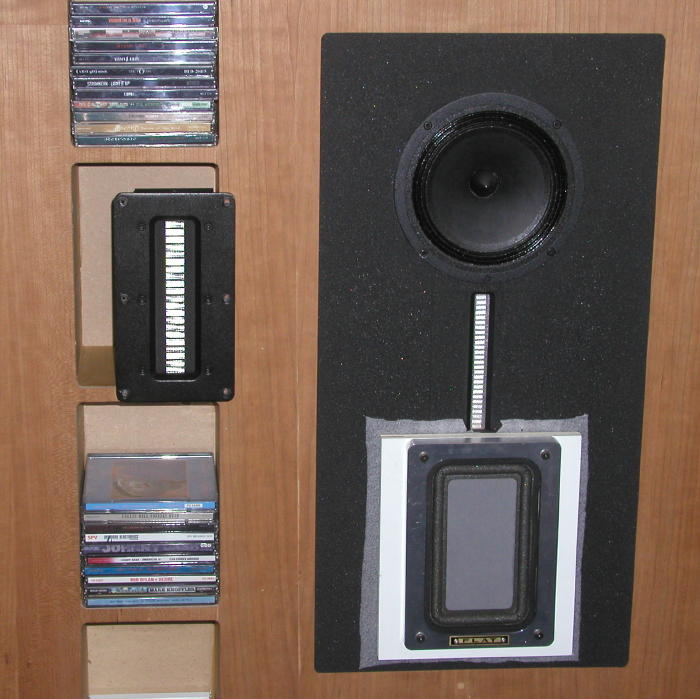

However, this change is not only due to the buffer itself. Last weekend, I made major modification to my speakers.
Few weeks ago I've replaced the MTM Triangle/Raven combo with FAL/Raven. Following some suggestions, I was initially using FAL full range, but for some reason, I couldn't get into that sound completely, as some strange coloration and ringing was always present. Finally, I measured FAL and they had some terrible picks and dips, but this characteristic indicated perfect candidate for low pass application below 2.7kHz. So last weekend I installed a coil (0.82mH) in series with the FAL and I changed the ribbons to Aurum Cantus GS1 (they are more durable at lower frequencies). While previously Ravens were used above 12k, this time AC were down to 3k (with a single 6.8uF cap crossing). I placed the ribbons somewhat to the center, because it was only available support space around ( I also attenuated them a bit with 10R series Holco 1/2W resistor). This combination appears to be very good, and so far, those are the best speakers I've heard in my house, truly a curtain has been lifted.

Hi Peter,
if you want to built a complete pre, it is better then to put the buffer at the input, before a 10K attenuator?
I already have your DAc and I am very happy with it, but I want to have other sources as well if I decide to built a pre with your buffer.
