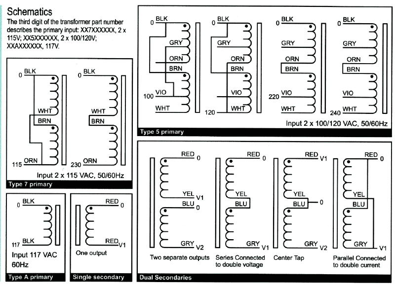

Peter, I have a basic question about how to tie together the primaries for a toroid.
My 300VA toroids for your LM4780 arrived today. The primaries are 115-0, 115-0 and the secondaries are 25-0, 25-0. Our voltage is 230volts, so does that mean I have to tie the 115 from one group to the 0 of the other group, and do the same for both, then connect my supply from the wall to them?
Thanks Peter. Just to reconfirm, I have to tie the white 115 to the brown 0, and apply voltage to the black and orange? Sorry, I am not good at this. My torroid cables are of different color coding but I believe they correspond to the above.
There are two primaries on each transformer with ends marked 0 and 115. You connect them in series (115 connects with 0). The primaries of both transformers configured in such way are then connected in parallel and plug into 230V outlet.
Peter, this is what I did, and the results I got. Please comment:
Blu (0v) . -----||------. Blk (0)
Grey (115v) ------||------ (25v) Red
Vio (0v). ------||------. Orange (0)
Brn (115v) ------|| ------(25v) Yellow
I tied Grey and Vio together and applied Live 240V to Brn and Neutral to Blu. I measured the primaries and they were giving 28.5V across Red/Blk and the same for Yellow / orange. Is this voltage too high for the LM4780 and did I wire it propperly?
