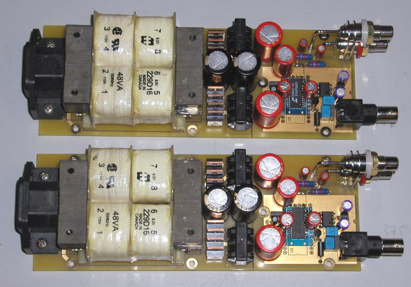

I recently received an order for two assembled premium DAC kits, so I decided to compare receiver chips (CS8412 vs CS8414). I'm slowly running out of DIP pacakage and whatever is assembled now uses adaptor boards and SMD chips. Soon, I will redesign the board to be compatible with SMD package only.
There is definitely a difference between those two chips. SMD package of CS8412 sounds the same as DIP version, however CS8414 sounds different. I got the impression that music flow is much more liquid and coherent with CS8412. The musical notes with CS8414 seem somewhat disjointed and I'm having problem concentrating and following the presentation.
The impression is so pronounced that I actually have to remove the CS8414 chip and install CS8412, as otherwise I would be hesitating to send such DAC to a customer. The bass may be slightly better with CS8414, but I'm not sure about it yet.

That is very interesting. I compared the SMD CS8414 to the DIP CS8412 in my Budget Greenboard DAC (post #714) and could not hear a difference. I can't do the comparison in my two Premium All-In-Ones, because I have the DIP CS8412s hard wired.
Could there be enough difference between the Budget Greenboard and the Premium All-In-One to cancel out the difference in the receivers that you are describing....or are my ears just that bad?

It's hard to say if budget version prevents noticing the differences. I think it's more a matter of getting used to a certain sound signature. I'm listening to that setup for almost a year now and any small changes are easily noticable right away.
If I put a freshly built DAC in a system, even if it's not broken in yet, I recognize the same sonic virtues. Here however, the sonics had different "virtues", the ones I'm not being used to.
The difference may be subtle, to me however is quite important.
