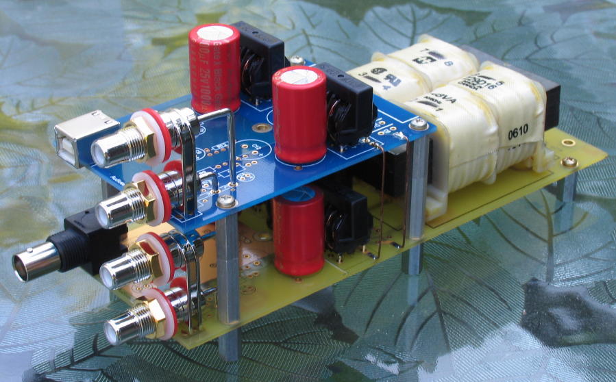

_henry_ said:is there any possiblities to have coax, toslink and usb altogether in the DAC?
It's been posted here: http://www.diyaudio.com/forums/showthread.php?postid=1579027#post1579027
ADding Toslink is not a problem, to have both SPDIF and USB input, two separate front end boards are needed though.

what kind of transport will do well for this, i mean regular compo cd player with possibly digital out, or dvd player?
i tried a pioneer dvd player with audionote zero dac few years ago, its improvement but sounded very thin, and any britain cd player easily outclass them like NAD or ARCAM.
but i heard the DAC from REGA transport is very good.
Destroyer OS. said:Next I must build a PSU.
You can use similar supply I used in ML buffer (see schematic)
Shunt sets input resistance.
_henry_ said:what kind of transport will do well for this...
The best one you can afford. If you can't find anything suitable, use a computer and USB version of a DAC, which is also available.
While developing DAC circuit, I was using ML31.6, ML37 and later CEC TL0. I presently use this: http://www.diyaudio.com/forums/showthread.php?s=&threadid=120229&pagenumber=1
