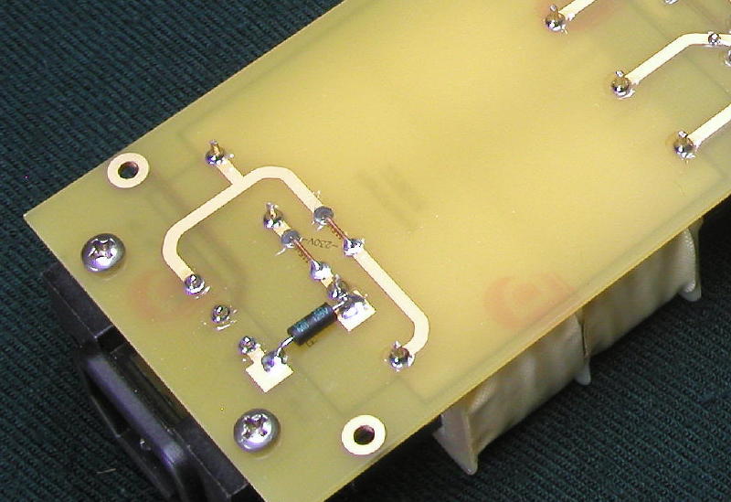

Hey Peter the resistor in the bag with the IEC socket, is that for connection between negative and earth ground for bleeding off? Also what size wire have you been running between the pads on line (and a switch/no switch).

That item is a PCB mount fuse, mount it according to the picture. Send me an e-mail so I will forward to you high res pics. Two jumpers set primaries voltage.

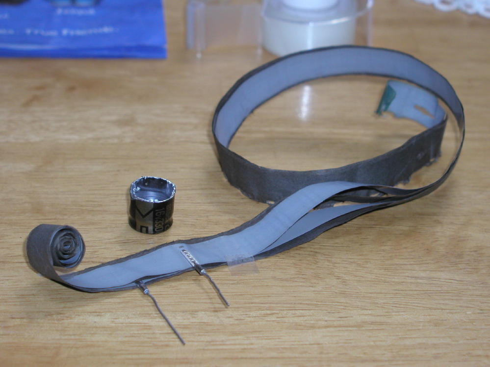

All red BG N caps should be installed with short pin (or side marked by NONPOLAR print) on +
Seriously? I thought the long lead was meant for the non + side??? Do I need to correct this on my amplifier as well? (what a nightmare it is on that)
Thanks for the information on the fuse. I got the jumpers right.
Yes seriously, but only for BG N red jacket caps, the STD caps (black jacket) are regular electrolytics and they must be installed with long pin to +
Going back to N caps, those are non polar and they sound better when short pin is on + (it has to do with inner and outer foil orientation).
World of difference... of course now everything I own from you looks like a hack job now. One of the BG's would not go back in, had to mount to other pins and then mount C10 by stretching the tiny leads...
