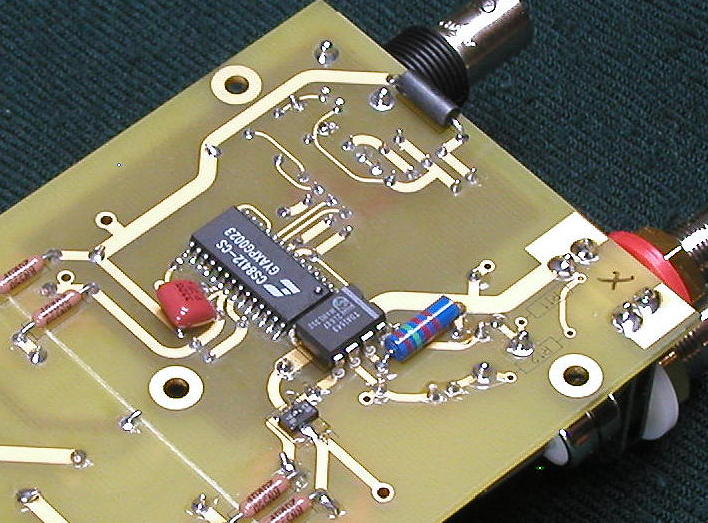

I found the orientation of the BG N info on the board, but only after you mentioned it. It would take me a month to go through all your posts Peter! You have been around this board for awhile. The circuit seemed more than simple enough at first look so I just dove in. I think everything but the BG N orientation went well.
I have no idea what it is but I can hardly get solder to suck up off of the stuff though. The PCB and metal are just different than some other stuff I solder on where I get cleaner open holes. I am sure I could use a better solder sucker but still, if I ever find out I need to make more changes this is all going to become point to point or buy all new stuff (not possible). It has been an educational experience. A lot of it has gone into messing with my ADCOM GCD-575 I got for free (1541a chip in it). I am considering using it for a transport but the Shigaclone or whatever looks fun if I could get ahold of the pieces.

It may be harder with my boards to desolder components, as I use minimum diameter holes, which are also through plated. It's best to use solder wick, and if that does not work, clear the hole with stainless pick first: http://www.hartvilletool.com/product/11679

I've had pretty good results on Peters (DAC) board using a solder wick. To be honest, I've found that solder suckers are really only good on bigger areas like around say the transformer connections etc. Wicks work best on the smaller holes. Heres another tip - when you get the component out, use another bit of wick to clean the hole again. As Peter says, the holes are only the right size and its quite easy to force a component lead through and lift the pad on the far side.

I think the PCB choices are good, but the old heat one side, pull a little, heat the other, pull a little, gets to you and runs the risk of popping off the pad. On C8 I think it is the PCB coating on the lead to the three prong whatever it is that looks like a JFET (do not remember part name) kind of dissappeared a little so there is solder on the tracing now that will not ever come off. C8 is wired across ground and input or output, whatever one it is suppose to be, so the cap faces straight down, and then C10 streches to it now (barely).

To remove caps, it's best to use 2 soldering irons, heating both pins at the same time, but you need another person to help ( I use my kids 😉
Then use solder wick to clear the hole (iron temp approx 800 deg F). Some holes will be stubborn, especially those on ground plane, here I use stainless pick (a needle is good too) and while heating the pad, puncture the solder in the hole clearing it out this way, solder wick for final clean up.
A small BG NX (0.47uF) is not that critical and I wouldn't be touching it if it's installed opposite way.
Picture below shows how C10 mounts (it's Wima now which is better than previously used Panasonic)

I will have to take a picture later. My C8 (I think, long slender BG N that was on top and C10 mounts to the lead of) if on the bottom now, across the little switcher, and C10 on the lead to ground, and on I think the resistor? Not sure where the other lead went too.
