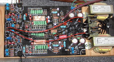

I think it was some 4-5 years ago last time I was comparing those two DAC chips.
I still have a DAC based on parallel TDA1541 (see attached pic, uses S2 chips). The DAC sounded initially better than my TDA1543 prototype, but after some parts swapping and mods I was able to match TDA1541 tonality, while TDA1543 still had better clarity, immediacy and PRAT. Since then, I never went back to TDA1541.
The volume control through the SqueezeBox3 will work with my DAC. The output level is approx 2V so it's pretty high and enough to drive the GC amp directly. No need for stacking chips either.

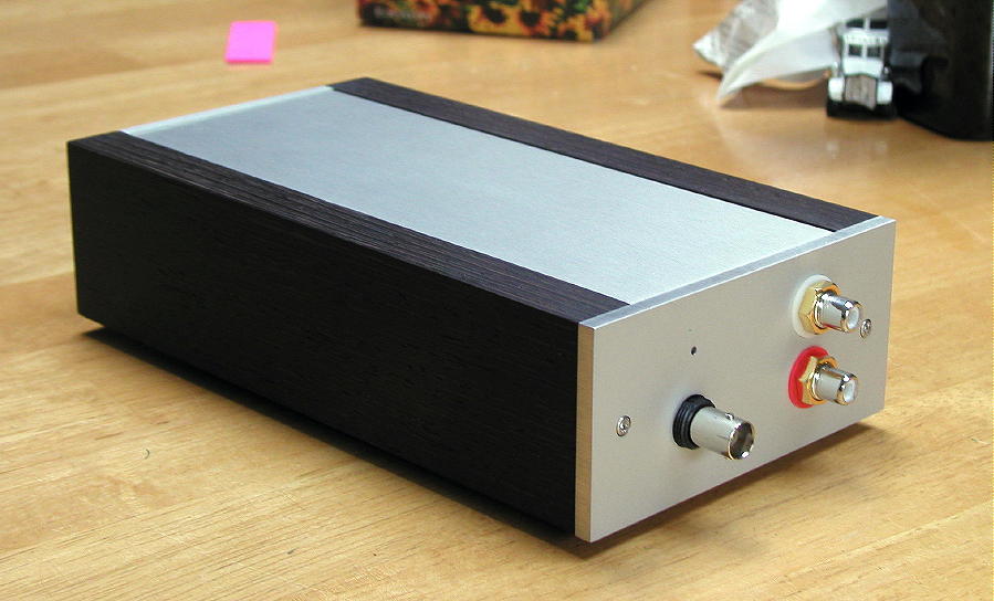

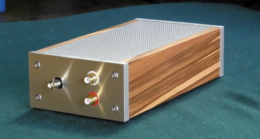

t-head said:Peter will confirm, but default input is BNC...extra for RCA...all chassis other than plain maple board are extra as well...
I do RCA inputs free of charge. The other chassis options are as pictured.
Destroyer OS. said:Well we shall soon see very well perhaps. The price is $280 for it with BGs? Then $30 for transformer, $20 for Cardas, how much for the new chassis? What about BNC connector instead, or do you offer 75ohm stuff? (no optical needed)
The supplied BNC is 75 ohm. If you need 75 ohm RCA, get Canare stuff from percuaudio.com
You are correct about the kit pricing, the chassis options pictured above are $330- $70.
I do not understand the chassis options. Do you mean $330 for the upper two and $70 for the bottom?
Destroyer OS. said:I do not understand the chassis options. Do you mean $330 for the upper two and $70 for the bottom?
Correct for the first and last, second from top is $260
