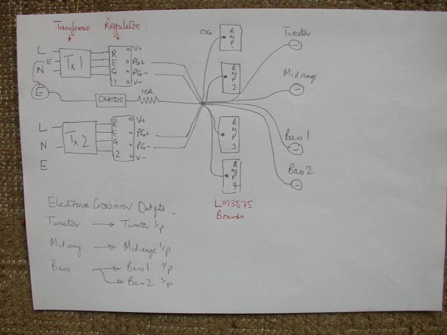

Old thumpers back
Peter,
I have tried your suggestions and failed! Firstly I established a Star ground by connecting all four CHG points with solid copper wire, to this I attached all the PG+ and PG- wires from the two regulator boards. The sound seem to be better but the switch-off thump (on the bass speakers only - sorry for not mentioning that before) was still there.
So next I took all the speaker negative leads and soldered them to the star ground - still the thump - but again possibly better sound.
So next I swapped the two transformers / regulators round - you guessed - still thumps. The reason for trying this was that I have the mid/tweeter amps on the Polish transformers (which have an earth lead on them) and the Bass amps on the Airlink transformers. I am trying to load a circuit showing the ground / earthing arrangement only.
Perhaps I will just leave them on all the time!!
Might it be better to run each bass amplifier from its own transformer / regulator - or is that just going to make matters worse?
Alan

Why not keeping transformers separate and all the grounds with respect to each transformer also separate? So you would have two completely separate PS; one for mids and highs, the other for bass.
The star grounds from each power supply would only connect through 10R resistor with a chassis.

Peter,
I did originally have the psu's separate but without the star-ground, so I will try that configuration tomorrow.
Alan

Peter,
Still no luck! I am begining to believe that the problem lies in the way the two bass amplifiers are fed by the same signal and that it may be better to take only one lead from the electronic cross-over to amplifier boards and to daisy loop the Signal Inputs on these two amplifiers.
I had seen somewhere that some people cure this type of fault by shorting the power rail to ground when the amplifier is switched off - one assumes using a DPDT switch with the off-position linking resistors from the V+ to Ov.
Is that possible / wise with these boards / psu?
If all else fails I will just accept the thump as I do not wish to compromise the sound I am getting.
Regards
Alan

The thump is usually caused by the way the grounds are run and in some cases may be hard to eliminate. If you could post a picture of your setup it may be easier to advice.
I never tried to shorting the rail to ground though.

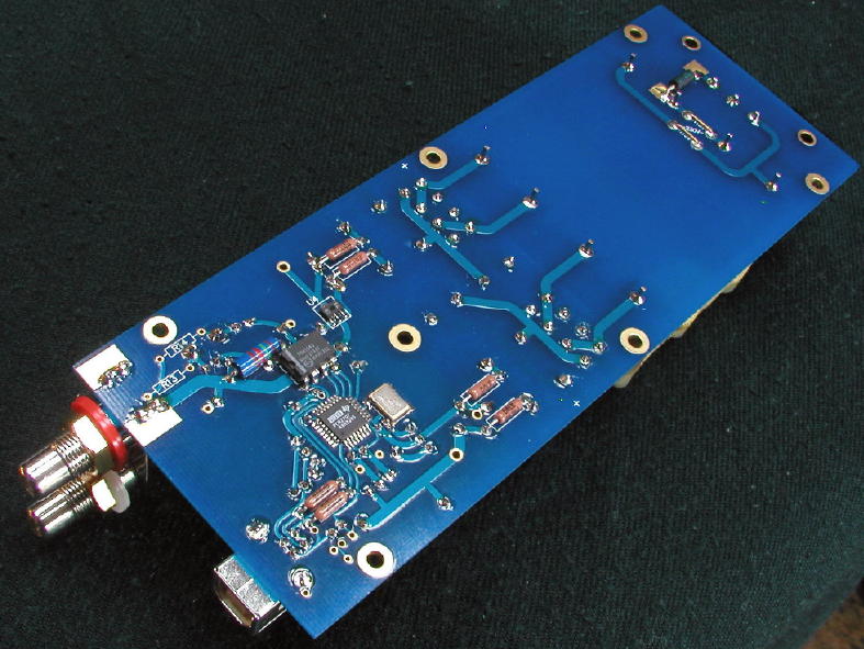

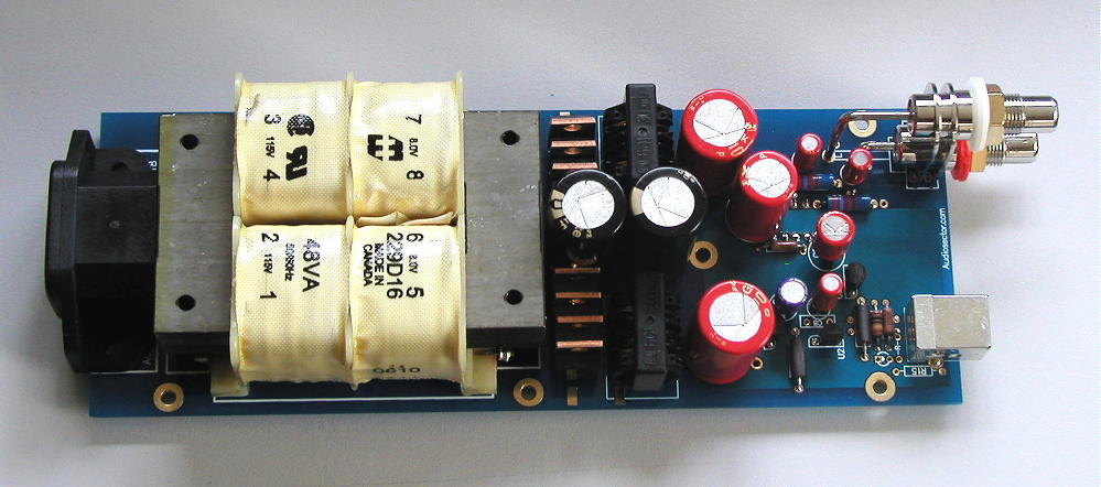

Peter Daniel said:A customer contacted me today with an enquiery regarding Mac and my USB DAC:
My understanding is that the Mac must "see the USB device" in order to control the volume. Do you know whether your USB DAC shows up as device for sound output AND whether Mac computers can control the volume? (With the toslink connection, Mac MIDI software options for volume control are not selectable.)
Anybody familiar with the issue?
Well, today I got response from that person and this is how it worked out:
... the Macbook does recognize the DAC as USB device. However, I still can not control the volume using Apple Front Row/Itunes and the tiny white remote that came with my IMAC. Fortunately, I have another solution: the Apple IPOD Touch that was free with the computer purchase and remote control software from Apple. Other companies off similar software with more capabilities (Remote Buddy and Signal) but I found Apple Remote to be much simpler to use. The volume feature works great, too.
As for sound, the DAC is truly amazing! I can't believe how much better music sounds, so much clearer and detailed yet totally natural, and the bass response...... stunning. The sound quality is much better than my Marantz SACD-14 player ($2,600 new but recently sold) and as good as a CDX2 ($6,000+) which I recently tried in my system.) All this from a product that has yet to be broken-in and using 10' USB cables from Lowes. (Kimber USBs are on order.) The internet buzz is right, you have a fantastic product and I'm a now in your fan club.
I'm quite amazed myself, as the USB DAC seems to be a sleeper. Whoever gets it, always likes it and the response seems to be even better than with the SPDIF version which was around for quite a while.

Here you are, the parts list and attached schematic:

The SPDIF DAC has been around since 2005 and there are few reviews on 6moons, most recent one here: http://www.6moons.com/audioreviews/audiozone5/system.html
The USB DAC was introduced last year and it's basically same circuit with exception of input interface which converts USB signal directly to I2S.
SPDIF DAC kit is $280, transformer additional $30 and Cardas dual RCA $20.
USB DAC kit is $250, transformer and RCA extra.
Both DACs are also available as assembled and tested circuits, mounted on wooden board, at $80 more.
