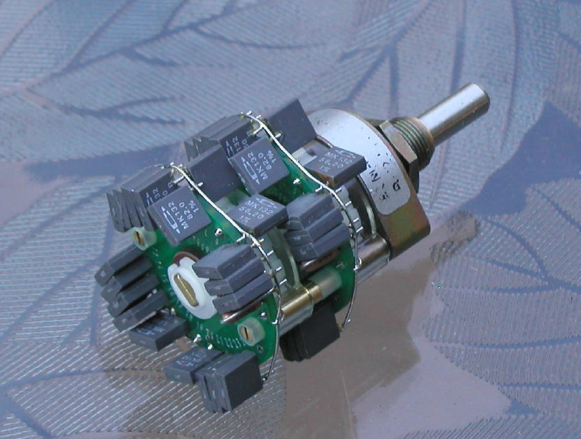

I only use passive stages: either discreet attenuator with quality resistors or TVC.
I was experimenting a bit with active line stages, but in the long run I didn't find them interesting enough and in my best amp it is TX102 that I decided to implement: http://www.diyaudio.com/forums/showthread.php?s=&threadid=76609&highlight=
Important thing is to install the attenuator directly at the amp. If active stage "improves" the sound, it could indicate that the system is not assembled properly. 😉

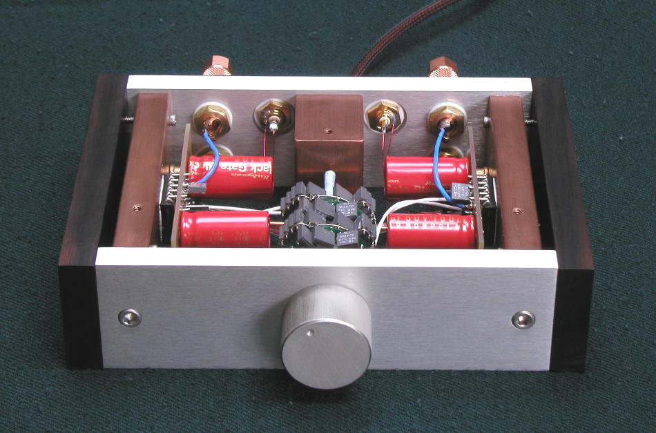

Hi Peter.
For the cuts you made in the circuit boards (on Patek) to accomodate the earthing copper bar, what did you use? Would a dremel be OK for this or would it pull the pad from the fibreglass? High or low speed?
Thanks,
- John
Thanks,
- John
I used copper wire (10 ga or so) to connect ground planes of both boards.
The cuts were done on band saw (approx. 0.1" deep).
You can use a cut off disc mounted on Dremel tool, higher speed is better. Remove some mask to allow for soldering.
Thanks Peter. I'll get to work on the revised grounding for my Gainclone today/tomorrow.

Thanks to everyone who made suggestions re. my Gainclone's earthing. Re-did it so it's exactly like the Patek and I have no hum now at all 🙂 I also decided to dispense with R1 which also helped, especially in terms of a more full bodied presentation.
