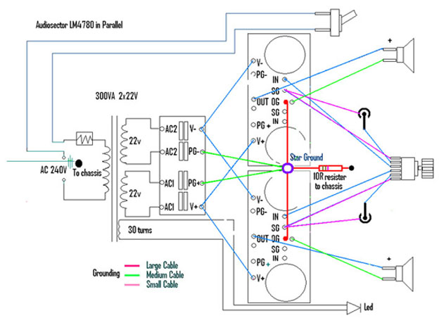

It looks OK, except that you are missing one power connection on each board (V+ and V-); they should be run parallel from PS to each board (4 wires in total plus 2 ground wires)
Also, the ground to speakers can be run directly from from OG on each board, not neccessarily from star ground which I use only for power supplies.

Now it's really good and that's how I do my amps.
In case of stereo amp, with a single transformer and single rectifier board, I indeed prefer to use wire between OG points on both boards and connect power grounds centrally there.

The only thing I would question is the wire guage. Very small (28+) is good for the signal path. Would you agree that the star ground does well with large guage (18+)? Signal out is likely medium.

I use gauge 14-12 to connect OG on both boards, power and speaker wires are 18-20ga and signal wire is 26ga.

I have only built one, so I followed your advice and benefited from your research. I used bare copper 12 on the OG (had to sand it down to get it into the pcb) 18 to the speaker (copper) and 3 strands of 30 guage pure silver on the input hard wired to your DAC. The sound is very clean and alive.

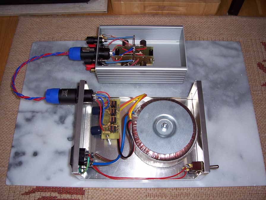

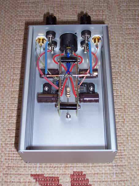

Would you mind taking a few moments to check out the internal arrangement of my 'Budget Patek' please?
I couldn't afford Black Gates so using 4 x 100uF Elna Silmics at the chips, and 300VA 2 x 25V transformer in separate PSU enclosure, with one of your rectifier boards, and two Black Gate 1000uF / 50v caps.
I noticed in an earlier post that the speaker grounds should go to that point marked on the circuit board. Mine are currently on the copper cross bar - is this OK or would I get slightly better results using the board point instead?
Please note that the current build also contains an 4mm thick copper heatsink on the bottom of the chassis for improved heatsinking.
Many thanks.
- John

It looks good. In Patek I also mount speaker ground wire on both sides of copper crossbar, you may still trim it a bit and do it right at the board:
Thanks Peter - reason I asked is that I get a very faint hum from the speakers, though admittedly that's with my head practically INSIDE it haha!
Being a perfectionist I'd like to get rid of the hum altogether. I'm thinking perhaps I need a bit more capacitance that 2 x 1000uF on the rectifier boards. I did try just using them without the Black Gates and just the 100uF's on the amp boards but I got alot louder hum then.

Hello John, it looks like you have two ground connections on each board. I would remove the link between PG+ and PG-. You should only need to connect ground once to each board. At the moment you are running a parallel ground to the ground trace on the board.

Well the whole groundplane is one big rectangle of copper, so it's not really two earth connections at all. Basically what Peter did with his Patek was to drill slightly into the Rz areas on both boards and join them together with a piece of copper.
I didn't want to risk damaging my board by drilling so instead I 'extended' the ground-plane area of both boards by attaching copper wire to the PG+ amd PG- areas of each board as an anchor, then join those together with a single piece of wire, which is the star earth point.
I have a feeling it may be a lack of capacitance instead when used with my speakers - as an experiment I took out the 1000uF Black Gates (I need to use those for the JVC Shigaclone at any rate 😉 ) and the hum level really increased. I have just received some 2200uF Panny FCs so will try those on the rectifier board and see what the hum level is like then.

I didn't notice that before, but those "copper wires to the PG+ and PG-" might actually do something with regards to hum.
If you don't want to drill more holes, why not connecting OG points on both boards with copper wire instead? That's what I did in Patek Integrated:
The capacitance should not be a problem:with 100uF only you will get hum, and it's normal. With 1000uF the amp should be quiet.
Hi John, no need to drill holes. PG+ on one board should line up with PG- on the other board. Link with a piece of copper wire and use the centre as the star point, that's what I did..
