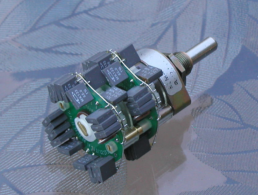

3. I would like to build a series attenuator using an Elma rotary switch, but I am having a hard time figuring out which model to use. Percy has kits based on the BV series and the 04-2130. The Elma website shows the 04A2A00 for audio use and it appears to be the same model (due to the PCBs) that you used in your integrated Patek. Do you have a preference? Again, a kit would be nicer here, but mechanically, this doesn’t look that hard. I have found the listing for the resistors to be used (10K I believe) so picking them out would not be difficult. Caddrocks would be nice, but I may have to stick with the Holco H4/PRP assortment.

3 I use BV22568 Elna switch from Percy catalog.

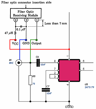

How do I best implement dual digital inputs and switching from frontplate? I would like to use BNC input for the coax input and optimize wiring/impedance to 75ohm.

The example of optical input implementation is attached. It's best to use a toggle swith close to both inputs and select them from rear panel. If you really need to do it from front panel, you may consider a relay.
Is it not advisable to use a traditional input selctor switching between spdif signals ?
superhkm said:Is it not advisable to use a traditional input selctor switching between spdif signals ?
I'm not sure about that, but I'd rather use as simple switch as possible for those type of signals.
