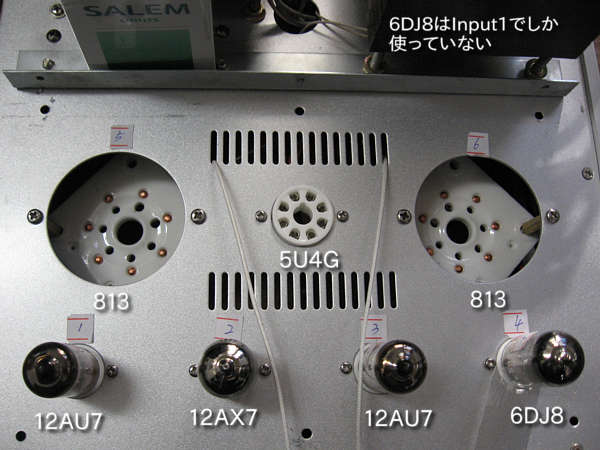

This is actually the only documentation that followed the amp!
I bought Audioromy's FU-13 SET one year ago. It may be an old version. The tubes are shown in the attached photo by American tube names. 6DJ8 is for input voltage amplifier to accept low level input signal and can be skipped by a switch located on the front panel.
I modified it to reduce global NFB. I changed the value of NFB resistor from 22K to 56K. I like the sonic of low NFB.
I replaced the faulty cap for 47uF/160V/105C. Now FU13 works as usual. I believe, that the original cap was from faulty batch. I run the unit more than 3 hours and it was really hot, specially inside. It is american product. Now I will work over the bias to reduce it to ca 65 mA. Then I will try to reduce NFB and see impact on the sound.

Hello ali tait and trondareo,
This is what is possible:
Swap ECC82 for JJ ECC99( direct swap ) or 6n6p( after modify filament supply ).
Swap 6dj8( ecc88) for 6n6p ( direct swap ).
Ronny
Ronny
Oh I see! thanks for that.I didn't realise the amp had to be modified to change ecc82 to 6n6p.I take it ecc99 and 6n6p are not exact equivalents then?
The ecc99 and 6n6p are almost compatible, just the filament supply is different.
For the audioromy the mod is simple. Original pin 4 and 5 are joint together and the filament supply( 6,3V) is connected to pin 9 and pin 4/5.
To use a 6n6p tube as driver you have to disconect the joint between pin 4 and 5. Connect the cable from pin 9 to the pin of 4 or 5 witch have no cable connected. Now there is filament supply( 6,3V) on pin 4 and 5. Leave pin 9 disconnected.
Ronny
Ronny

Bias Adjustment
As some of you, I had problem with reducing bias below 72mA. The easiest way to solve it is to sqeeze more negative voltage, which polarise the first grid of FU 13 valve. To accomplish it, one should increase resistor 56k connected in series with the regulating potentiometer. The lazy way to do it is to cut one end of this resistor and solder to cutted small pieces of copper another resistor ca 200k ( I had 180k ). It should be done for both channels. This operation allow me to reduce bias down to 60 mA. Mentioned resistors-the small ones, can be found between pot and 100uF cap at the left corner of printed board.
After that, I measured output voltage and power at 9,4 ohm load. Max non distorted voltage was ca 20V max, which gives ca 21W RMS output. Such values was observed at oscilloscope for both 72 mA and 60 mA bias.
I also measured DC and signal voltage across the signal path. It seems, that working points was designed properly. With max non distorted,output power, the signal voltage at the first grig of FU 13 was ca 100V max, which fine corresponds with ca -90 DC - negative polarisation of this grid. So only limitation of non distorted output power is the last stage of amplification i.e. FU 13 with trafo and power supply.
