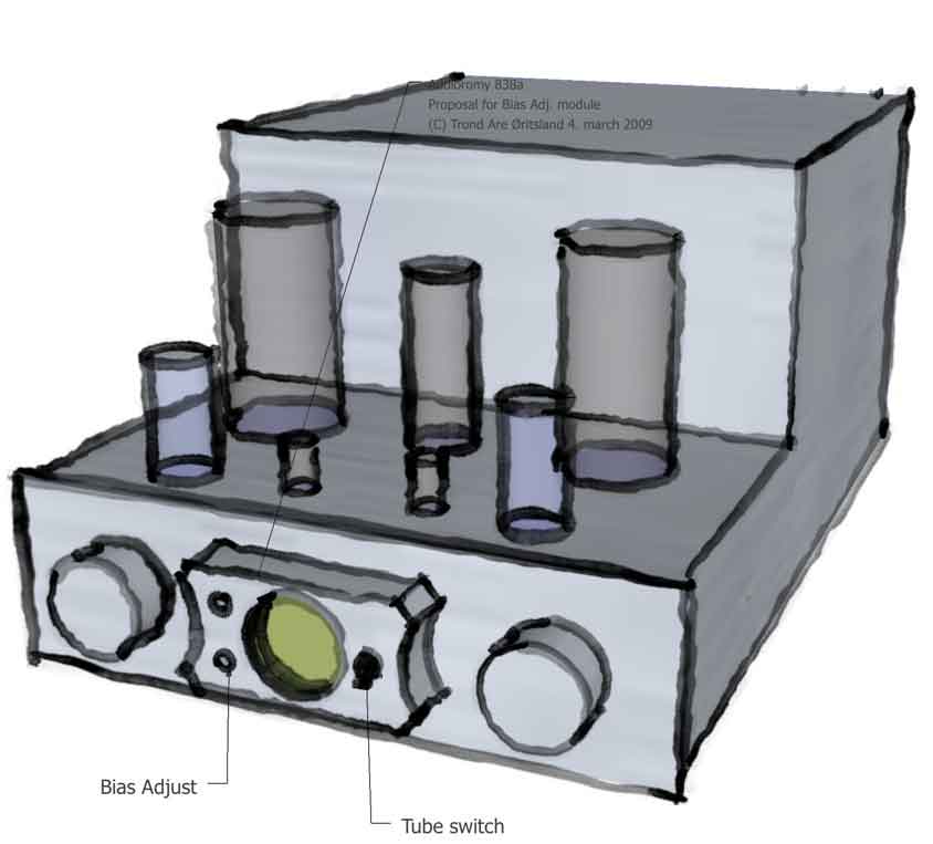

I have been reading Rören und Hören and; being an industrial design engineer with an interest in usability, one thing that strikes me is that it would be better to rebuild the amp with bias measurement and adjustment on the outside. I really like the Classic 16.2 and the Mr Liang amps for this. They even have voltmeter(s) built inn.
Any thoughts on this?

Ahh yes and Norwegians are known for being nonconformist inventors who never capitalize on their ideas, so in that spirit, here is a sketch of my previous proposal.
