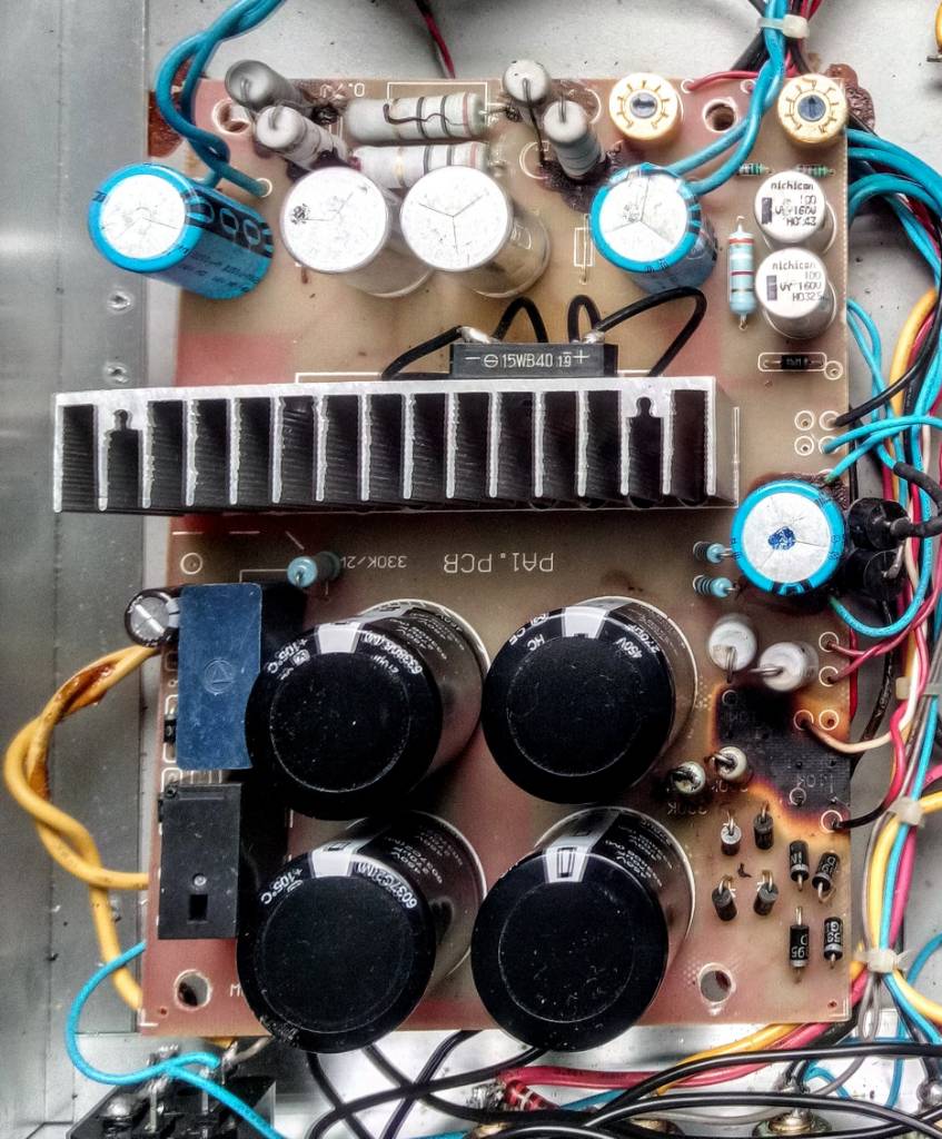

Can anyone say how the 4 capacitors located off the power supply board are connected to this board. They are wired as series pairs, the same as the 4 on the power supply board with 330K balance resistors. As such, are they connected in parallel with the 4 on the board? Can't think of any other way they could be used.

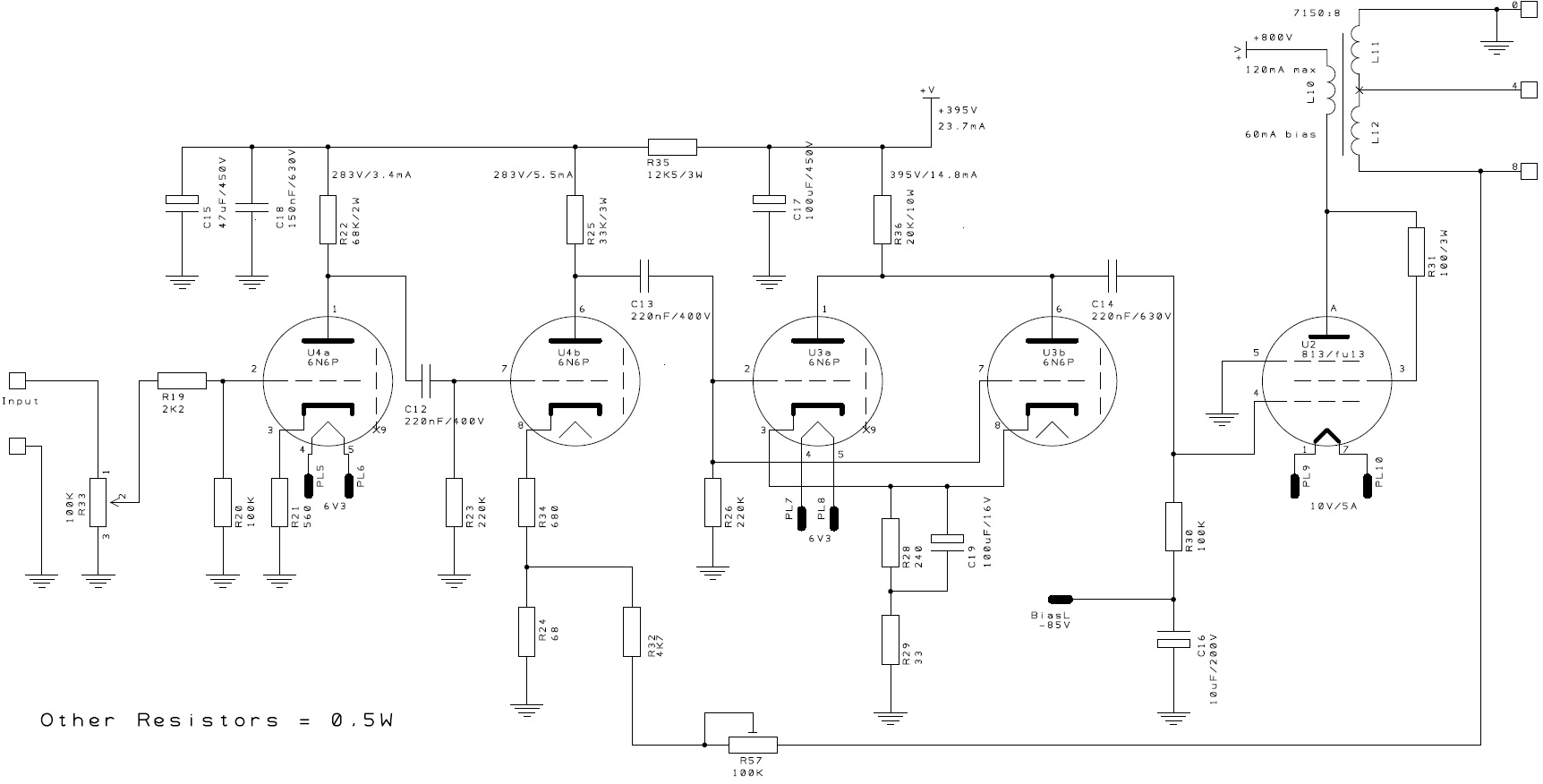

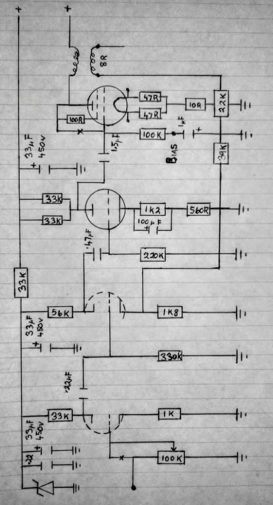

As preparation for me to give my amp a new case, i reversed enginered my amp to get the schematic of my version with 6dj8 and 12ax7 preamp tubes.See below.
Further i lke to make some changes like,
- Dual mono build
- Other power supply without voltage doubler and single fase rectifyer.
- Less distorsion and gain.
- Feedback control.
- Easy biasing.
Schematic of the mod will follow soon.

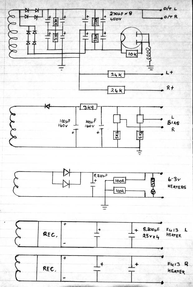

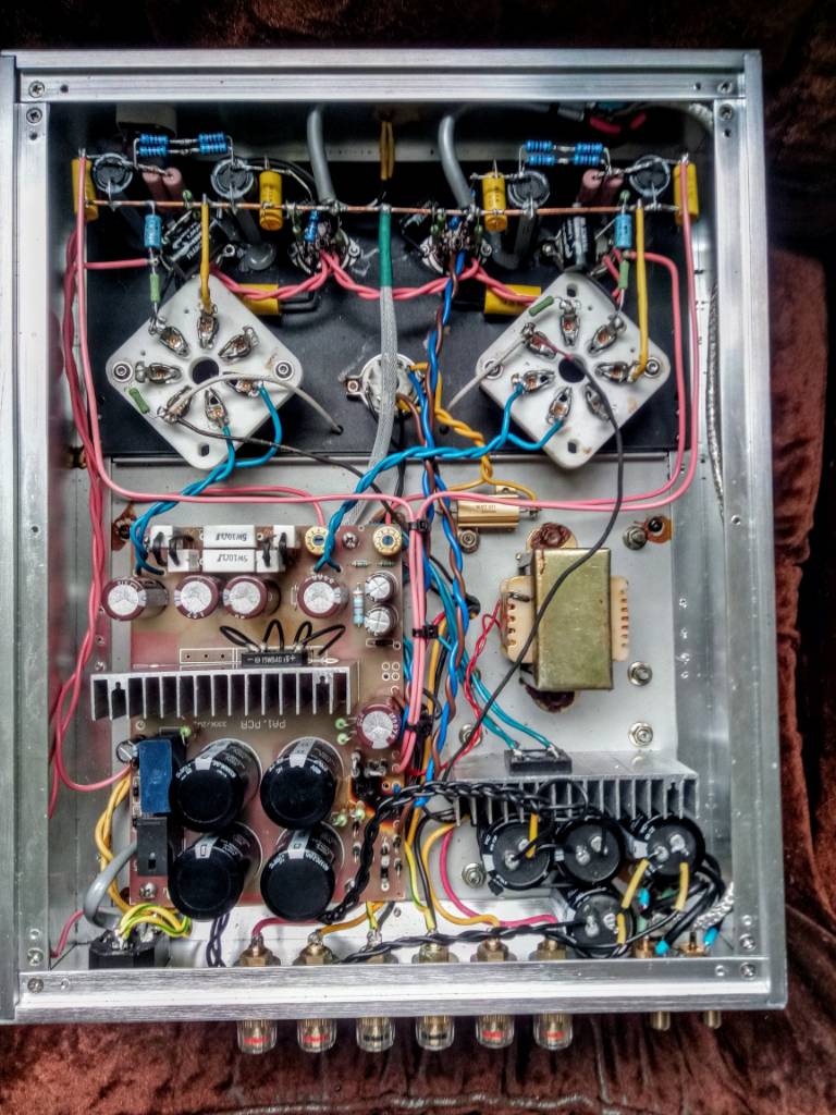

Odd you should be thinking that. I want to rebuild mine. Not sure about monoblocks. Want to get a new transformer(s) as the one fitted gets really hot from switch on. Don't think it's really suited for 240v. Not sure what current rating the bias and B+ windings should be. Want proper tube rectification, but not sure what's needed. Want mercury vapour rectifiers as they look really... BLUE! (816/866?). Voltage regulators look nicely...PINK! (VR150?).
Oh, and a proper isolated soft turn-on with adequate relay rating.

I bought a Audioromy seller told was 230 volts but was 120 lucky, I never trust chinese sellers so used a 120 step maid many changes to the horrible circuit but the transformer still went up ,in smoke, I built peter Millets circuit as monoblocks very good. I hope to replace the transformer. a friend bought 4 Audioromy duds on Ebay all had transformers had burnt out.
Thanks Multi. I have stopped using mine untill I get it rebuilt. I am going to use the Pete Millet circuit too and am waiting for the driver valve, which was really cheap. Here in the UK the Audioromy 813 hardly ever shows up on eBay. I think I have seen about 3 over 10 years. Perhaps not many were bought. I know of one were the mains transformer burnt out.

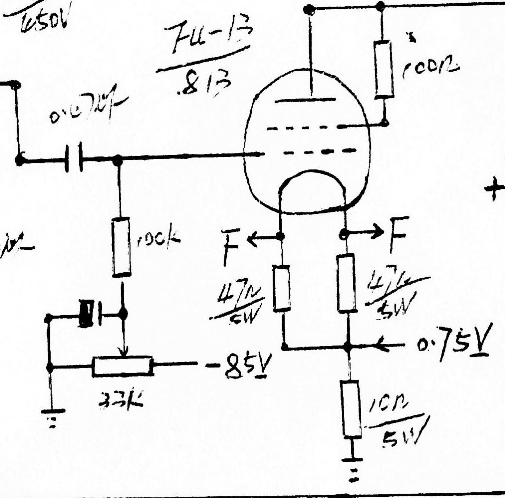

Ten years ago i wrote that the bias could be lowerd to 50 a 55mA and not 75mA this keeps the mains transformer a lot cooler. Mine has now about 10.000 burning houres and no problem with the mains transformer.
Wiring from the bridge rectifyer of the heater supply had i to replace because these were to thin and isolation melted. A short here would distroy the mains transformer.
Pete Millet and Lukasz do not use negative feedback this changes the soundsignature a lot. Therefore i like to use adjustable feedback in my rebuild.
There is nothing wrong with the output transformers. Good frequency bandwidth.
