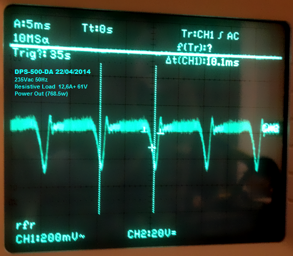

I hope that all of you have had a good Easter as I passed in the family.
The Sicilian cassata was very good 🙂 (typical dessert with ricotta and sponge cake).
Just for completeness, place on my thread some measure, some you've seen before on another thread, with the addition of some info to better understand the benefits of this new topology, compared to the conventional switching regulated. (developped in 2009,first production date 2010).
596 pcs around the world, with 592 customers very happy for the Audio result, in both class D / AB. only 4 issues, of course, replaced with new one module immediately.
Pic1:
Ripple 100Hz @11,8A(720W) (resistive Load->positive rail) measure on CN DC Output
CH1->Probe 1:1 (AC) 200mV/Div. 5mS/Div. (Full 150Mhz BW Vert. CH) Also measured to 350Mhz BW and 1Ghz Analog input scope.
CH2->Probe 10:1 (DC) 20V/Div. 5mS/Div. (positive rail on CN DC Output).
Extra info included in the pic, are not related to ripple, but in timing/relation to other internal functions of the DPS-500. as eg. the synchronous controller coupled to the phase AC Line. (as a PFC, but without the disaster of PFC ,it's just for audio).

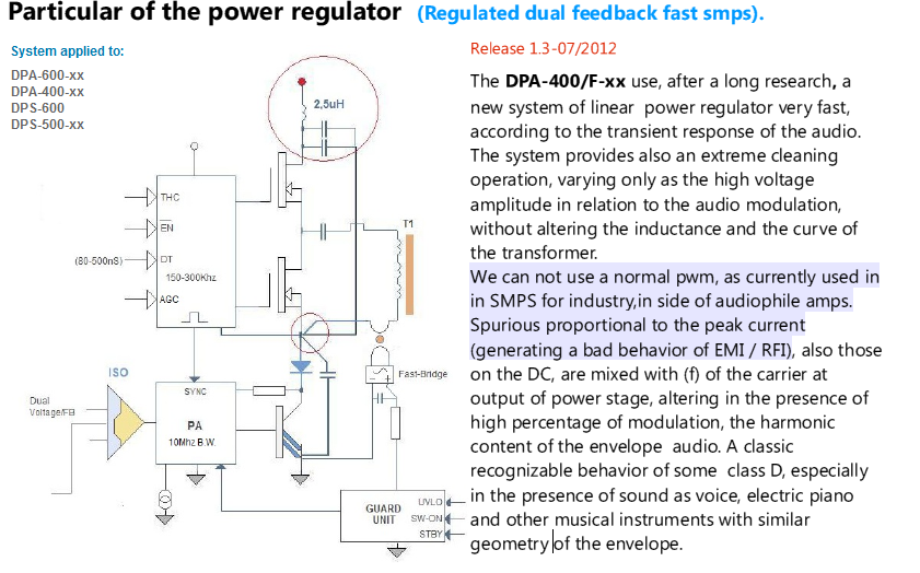

Pic2:
Simplified diagram of the "linear regulator" in the DPS-500-xx.

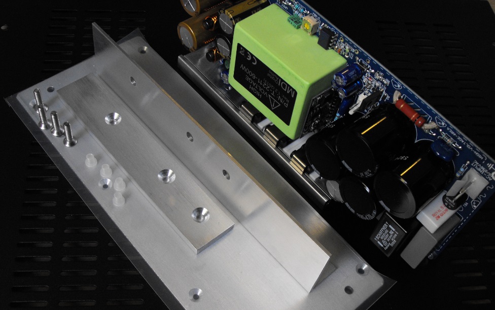

Package Info:
The package includes (for each smps) a complete set, mylar form (220x95mm) + insulators (visible in the picture before putting), all stainless steel screws and connectors. PCB color = Blue.

Pic1:
Pic2:

Package Info:
I have well tested with frame, it's a clean way of assemble in side of your case.
If some want, I can send even now (the 24pcs are ready).
Just for info...This "operation" of the aluminum frame, has had a considerable cost, I have dealt exclusively to offer a product "ready". I did not gain on the frame, see price.

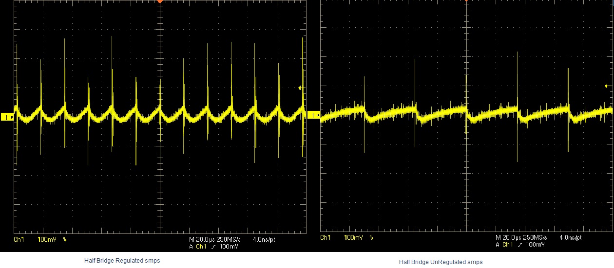

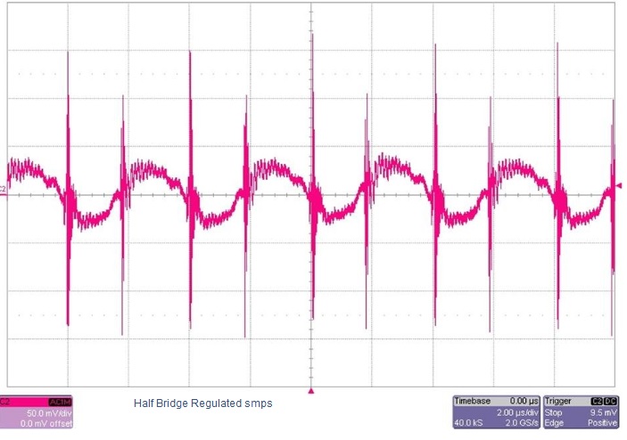

I want to take advantage of this break in the afternoon, to explain a few things related (in general), smps used in audio.
First, I show a measure of HF-Ripple DPS-500, pushed to the limit (continuos current) 12.6 Amp on the positive rail, measured on the output connector. (PIC1)
Just a few words about smps ripple:
On a linear psu, we have a sinusoidal ripple with very close to twice the line frequency, then, by (50 Hz), we have 100Hz. Obviously there is nothing else that can disturb (except for some spurious coming from the ac line, if the psu is not done well.
In the case of smps, we have a dominant at 100Hz (which can be not SIN) with sub modulation, of the frequency of switches.
To this are added, (A)spike in exact position (time) of the change OFF-ON, due to the switching of the FETs / IGBTs. and other signals derived from the imperfect adaptation of the primary inductance, parasitic, etc, etc, and in the end, the (B)ripple High frequency in Khz range (switching frequency). the ripple go measured in percentage or Vpp.
Classical view of what it contains a simple measure of the ripple, performed in the high acquisition, is shown in the two pics,taken from measurements on two standard topologies of smps.
Now, with some simple interventions outside the smps, it is very easy to reduce to a minimum, the residual HF (HF-Ripple-note B), considering also that in percentage of 20mV/Amp, does not produce catastrophic changes in the harmonic content and is eliminated by most audio analyzers, just to get good measurements.
For spike (notes-A), things are very different, these are in the range of MHz-GHz, can not be eliminated, they are the first reason, the lack of official use in large scale of the smps in the high-fidelity sector. also, by nature, inherent to these spikes, they propagate on the surface, via air, and via induction, both to the DC output, and vs. to the ac line. directly, and indirectly (bidirectional).
It is easy, to represent the effects of these spikes, with a simple fft at the output of the amplifier, but very complex to describe the effects on the harmonic content of the sound envelope.
The sole fact of filling a fft with harmonics, independent of what actually will change on the audio, it is already a big problem, have a fft full of harmonics, when a company wants to show the measures that have a nice amp. 🙂
This is a serious problem in the world high fidelity, not a joke.
Continue... show the fft with 3 model of smps.
