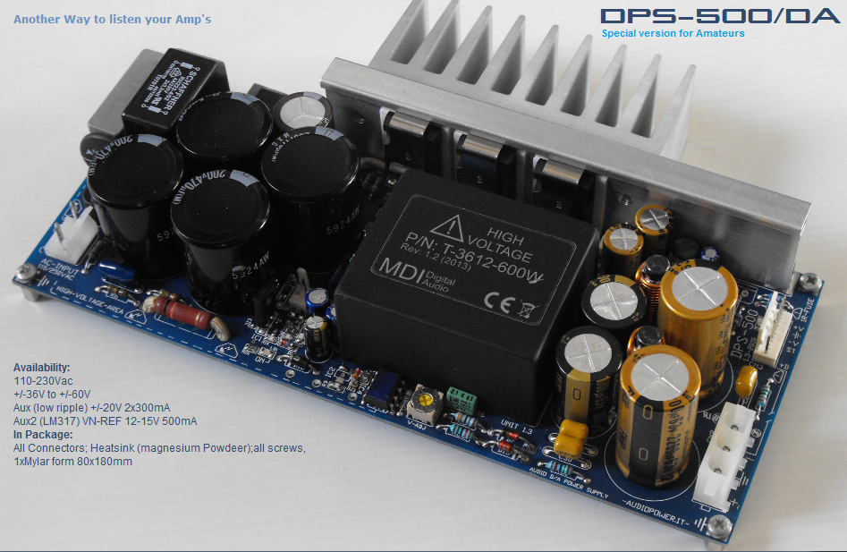

Hi guys,
I can only manage version DPS-500/DA up to + /-56V 10A.
We must consider the voltage drop under transient audio that can offer this smps. For this reason, the measures put with typical mosfetAmp (2 mosfets per side) and 4R, -- 2.7 R load, just to see how much power we have.
The behavior I think is very well known, thanks to the two FB (one per side),and power regulator linear,synchronized, (not pwm use),also the balance is very fast, as the output very clean with 8A continuous.
well, coming soon new measures.
The price is € 230 for a couple. (includes as photo).
The amount is fixed at 25pcs for GB, an opportunity to have a smps created for amplifiers and at the same time save a little money, (maybe there is a free amp as gain).. :)
Continue ...

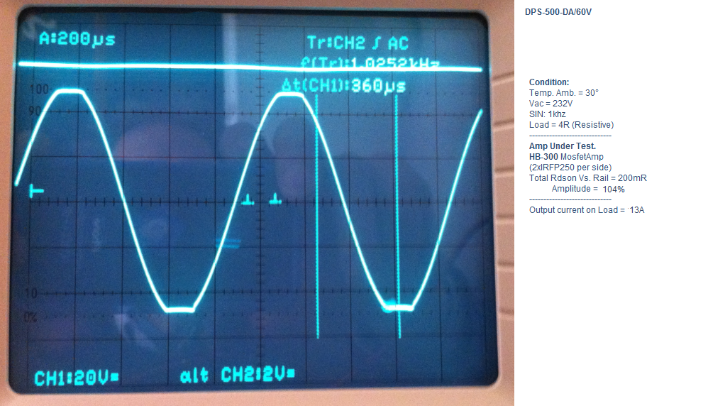

Some first measure on DPS-500-DA/60V well tuned for Amateur Use.
I wait the first qty of all Nichicon Audio-Grade caps for this version for Tuesday.
These measures demonstrate what he is capable technology.
So we have a smps , compact (30mm Height) , absolutely clean (- 78dB the fundamental 150kHz ) , Able to withstand large surge currents repeatedly , such as audio transient , with no compression on the envelope .
In terms simple, we can offers of course, excellent dynamics with unquestionable realism on fast attacks ( timbre of musical instruments) .
Also, the geometry of the audio envelope is closer to the real one, with a result of greater SPL product.
Note: All those who have, for example, the DPA-400/F3, ask if it is 800w :) but we measure only 320w at 4R SIN
These three performances, (sorry for some, for my statement ) , it is not subjective when listening .
The problem is , that we are not trained to listen psu that does not drop under the transients , the reason is simple ... we have not , before the DPS -500- xx .
The image sound ( stereo ) , height of the stage and other definitions have nothing to do with the PSU .
For sure, I will not spend my time trying to convince those of the old school.
maybe there a reason... why not have AudioPower smps normal? :D
P.S. The third pic (SIN- 4R Clip) , is outside of the physical, consider this smps , uses only 470uF in the Main filter cell.

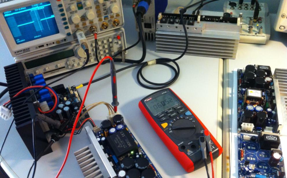

Et voila! ...The version I dedicated amateurs.
The difference is immediately listenable at 5w (not as you think, just near the region of the clip, or just Increase the power on amps).
well, my job is done, as you can see I chose Nichicon audio grade for this version, I have to say that the difference is much more than what I thought, I had to completely revise the levels and constants in the two feedback, including current limiting .
At this point, we have set 1V rms drop under load, regardless of whether continuous or burst.

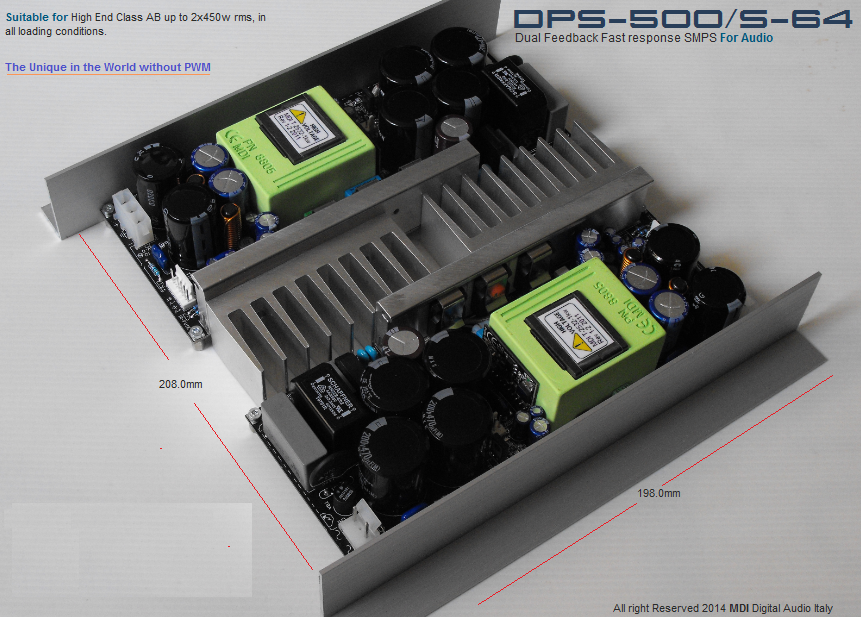

As writed on the first pic, the voltage can be selected (at purchase ) between 36V to 60V , independant of 110/230Vac.
Not knowing what load (in your example) link your full balanced amps, I recommend using 1 DPS-500 / S in this case, for a couple of Amps.

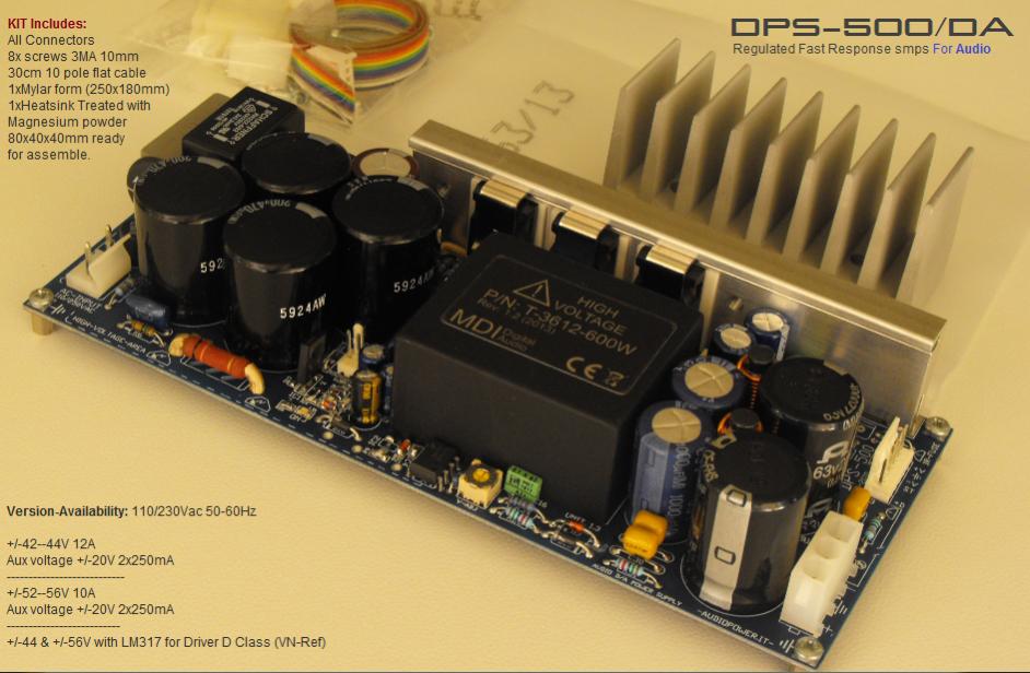

Without any doubt, use the DPS-500 for the bass, it offers excellent timbre, very dry. and, in the case of VSSA amp, ensures perfect rebalancing of the power stage, between a transient and the other.
I would recommend using the DPS-500 horizontally (like the pic post # 3) and changing the spacers with plastic. in this case, the heatsink are isolated from the chassis.
