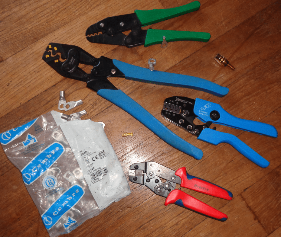

I prefer crimping, but it also depends on the kind and the size of existing connectors.
The quality of the crimping tool, the accuracy of the crimpature and the material of the forks are crucial.
When it is appropriate I use wire ferrules too.

In audio applications if wire gauge is very thin I prefer to solder it, if very huge (i. e. loudspeakers cables) I prefer crimping it.
Before to crimp I spread a thin veil of an appreciated non-conductive oil on both terminals and wires.
The eyelet terminals are a quality italian brand made of electrolytic copper (tinned).
That crimpature sounds so good to my ears.
I rarely used crimping and soldering together and if/when almost always for faston only.
