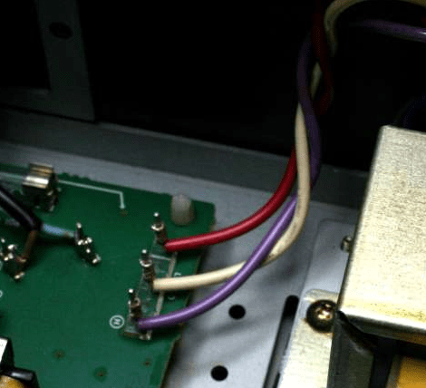

I just came across this power supply connections where you can see an alternative way to soldering and crimping that I had forgotten that I had already seen (I don't know how it is named though).
I'm wondering what is the technical/electrical reason why on an industrial level in the construction of an audio device (CDP in this case) that kind of connection is preferred (twisted wire).

It's like a kind of crimping, but with much more area of contact between metals and probably also easier to do at its state of the art.

In power distribution everything is either crimped (or bolted). Same goes for networking stuff. One practically never sees soldered connections in either one of the areas. Only electronic parts are soldered on PCBs.
That's simply wire-wrap. A fast, cheap way of connecting flying leads to terminals. A real pain to service as if you remove the wire, it tends to break where the edges of the square peg is. I desolder the peg (wire wrap terminal) and pull it from the PCB. Much easier and remains reliable.

Yes, high current connections would probably melt solder for one, and crimps withstand vibration much better. The bolted terminals are either a crimp or bolt (in the sleeve) attachment. But soldering flying leads is also very common in low current applications.
For networking and telecom the wires are typically connected by insulation displacing "knives" (IDC) where the insulation is held (except with horrible "66" blocks). Not really a crimp, and the knives are soldered onto a PCB (could be a backplane in patch bay strips). This is all about speed of assembly for low voltage, low power.
