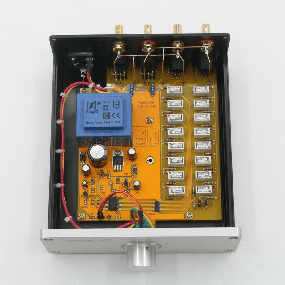

But maybe you guys should just all buy one of these. Check out all those relays. No doubt it will sound better
Signal will always travel better through solid wire and soldered connections, compared to some sort of alloy contacts, that are only connected by tiny amounts of metal contact, along with metal oxides and varying amounts of who knows what other types of sprayed metal compounds.
HiFi Advanced Relay Volume Controller Balanced Preamplifier / Passive Preamp
Passing a signal through quality passive contacts of a relay has way less signal deterioration over an active Silicon device. I have never liked using analog (active devices) switches but then that is just my own bias. That is the nice thing about DIY, you are free to try anything you want and evaluate its sound.
Hi rschmitt100,
Some relay contacts are better than a connector, and better than some traces.
One thing you are not doing is taking into account circuit conditions. You are doing a thought experiment only as you cannot hear what you are talking about unless there is something wrong with the connection. We can easily measure 35 dB below what the human body can perceive, lower if were careful. I routinely do this by the way. The impedance level of the circuit compared to resistance variations from contacts is such a massive difference that there is no practical issue. You simply cannot even perceive it, never mind actually hear it. All you can do is think you hear a difference. That is the truth of audio measurements these days, we easily measure way beyond what can be heard - and we look at the spectrum, not a meter pointer. Believe me, we can easily see the least amount of noise. I can see noise even if everything sounds clean, and my bench monitors are 99 db/watt. Measured extremely flat in their mounted locations.
Now, a passive preamp is only a volume control. Please don't insult yourself by calling it a preamp. It has no gain, and no buffer. In fact, it prevents the source from driving the cable, connections and the input stage of the next thing in the chain. If anything, this class of device causes more trouble than it can possibly correct. So it has an input selector as well. Big whoop! The term "passive preamp" was coined so it would gain traction as an idea and sell better. It most often reduces high frequencies a touch. Want to avoid the active stages? Well, what do you think is in the source? How about the gear in the recording studio? Do you have any idea how many stages of amplification the signal goes through in a studio? The number would blow your mind. Most preamplifiers have much higher quality gain stages than seen in studio equipment, especially the outboard gear and effects units. Never mind the tape machine. I'm talking Studers, not old MCI, Ampex or Scully as so much early stuff was laid down on. Then there was the Denon PCM recorders.
You basically get all worried about nothing. Nothing in comparison, or if it is poor quality stuff that bugs you, the answer is easy. Use good stuff.
