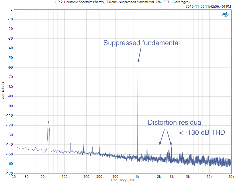

Yep. Those are good. I can't measure any distortion added by them.I like the Kemet EC2-5NU

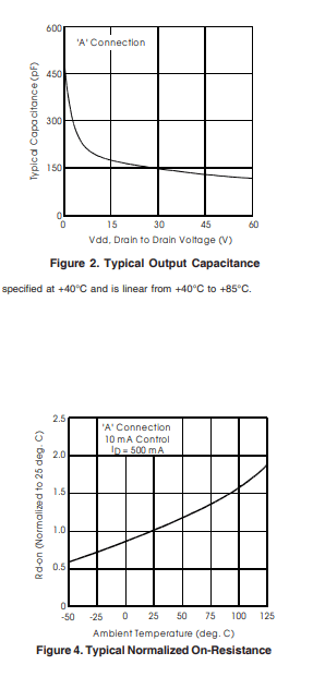

Infineon's PVG612 offers claim of linear AC/ DC operation https://www.infineon.com/cms/en/product/power/solid-state-relay/photovoltaic-relays/pvg612/
I use the EC2 as the protection relay in my HP-2 headphone amp. The output of the amp flows through the relay. I don't have a measurement with 600 Ω, but here's 50 mW into 300 Ω. Note that this measurement was performed using the APx525 and a notch filter to knock down the fundamental at the input of the analyzer. That's why it shows at attenuated. If I recall correctly the filter had 9.2 dB loss at H2.Can you please measure with 600 Ohm load?

Resistance totally dominates though, for signal coupling ie 1 ohm in parallel with maximum of 130pf , so OKPVG612 output capacitance varies with voltage. Maybe not so good?
OK thanks! The harmonics are not a problem here. But the mains hum ;-)I use the EC2 as the protection relay in my HP-2 headphone amp. The output of the amp flows through the relay. I don't have a measurement with 600 Ω, but here's 50 mW into 300 Ω. Note that this measurement was performed using the APx525 and a notch filter to knock down the fundamental at the input of the analyzer. That's why it shows at attenuated. If I recall correctly the filter had 9.2 dB loss at H2.

Yeah. The notch filter was on a piece of perf board dangling from the input connector to the analyzer. That's also why you see the switching hash above 1 kHz.
It's a challenge to make a setup that works well and doesn't require a bunch of compensation to extract the THD number, so in the end I ended up punting and bought an APx555B.
