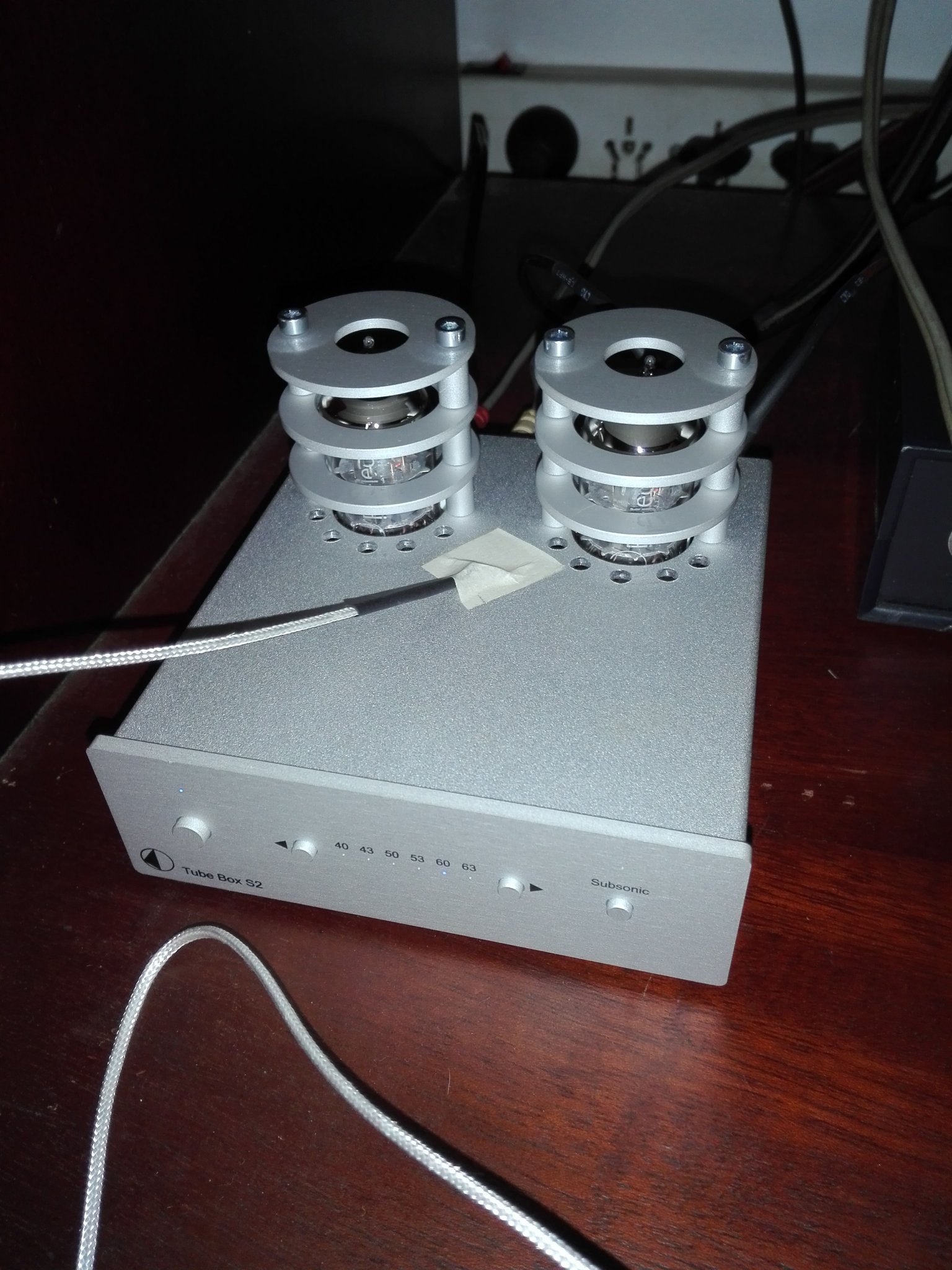

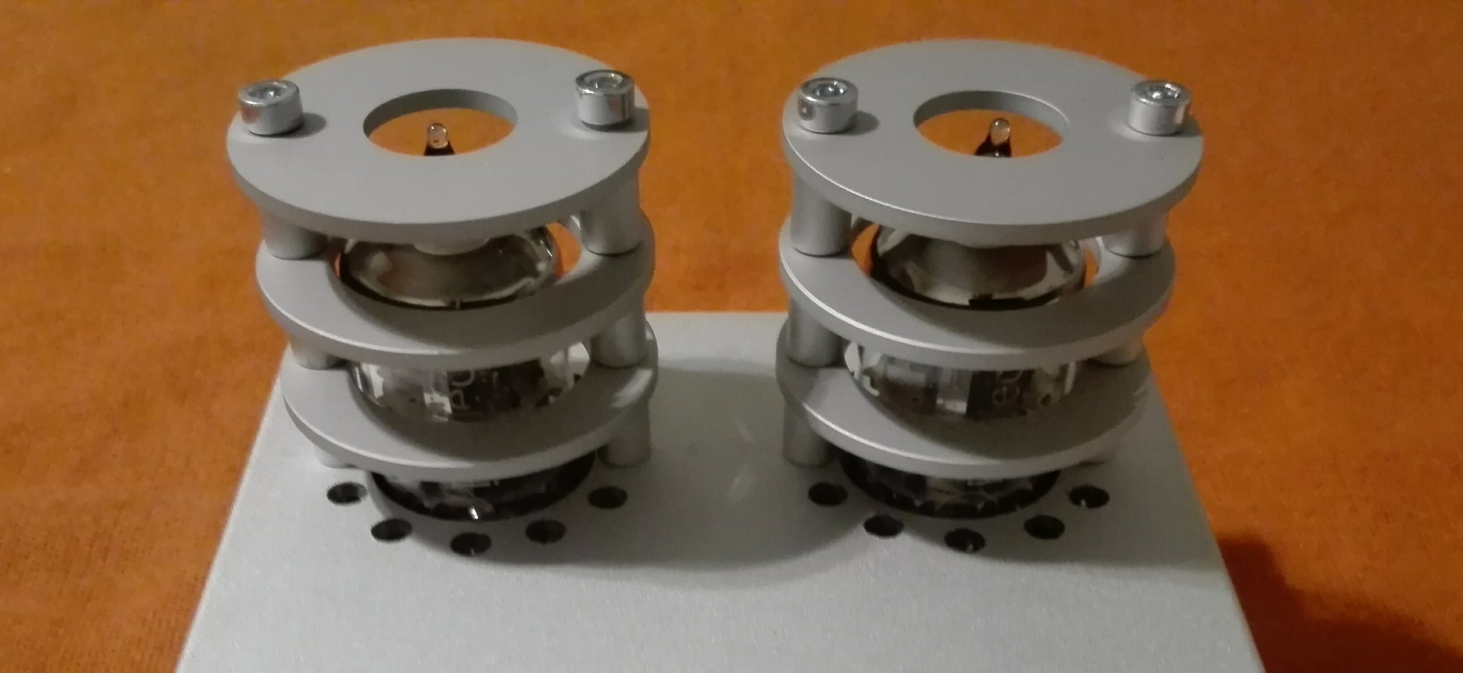

I have done a rework on the PJTBS2 box, you can see it here:
https://www.diyaudio.com/community/...ubes-project-tube-box-s2.383291/#post-6946817
Thanks! , in something you have to entertain yourself...... I should have taken the temperature before and after with the multimeter sensor ....

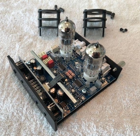

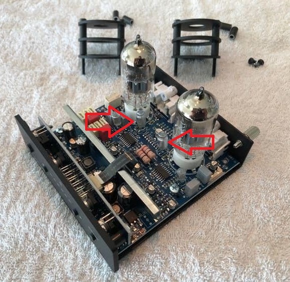

Thanks for the suggestions but I need to clarify something.
The reason for the rework is explained in post 102. It is not to extend the life of the valves but to protect the interior of the cabinet from a slight excess of temperature.
The photo you can see was taken from the web, obviously it is not my unit since mine is silver and that one is black. But you can see two capacitors indicated with arrows, they are the ones that I wanted to protect especially.
Avoid overheating beyond 70 degrees Celsius. In fact, the factory unit does not have any ventilation, beyond the necessary holes to house the tubes, so I decided to make the modification.

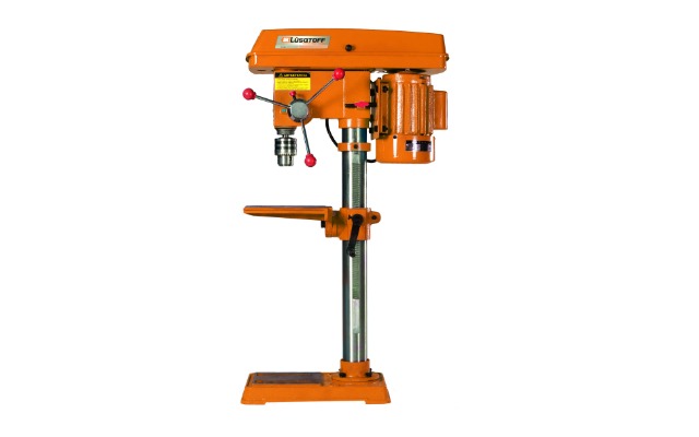

But I can't make holes on the sides (the idea is a good one, I had already thought about it, thanks anyway) because I would need a professional bench drilling machine that allows the carcass to be placed vertically. I'm not going to buy it, nor annoy friends, nor invest neither time nor money sending the work to a metal-mechanic specialist.

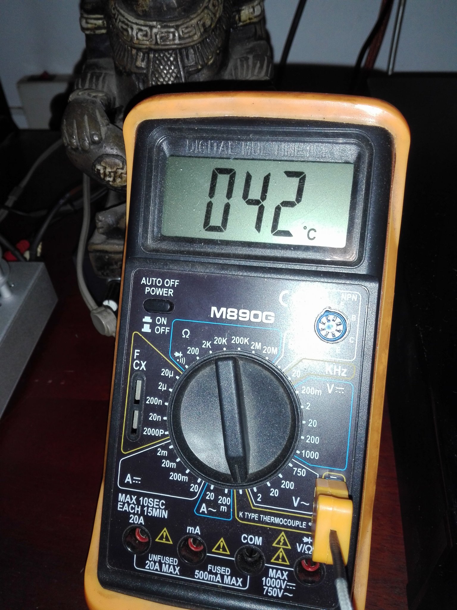

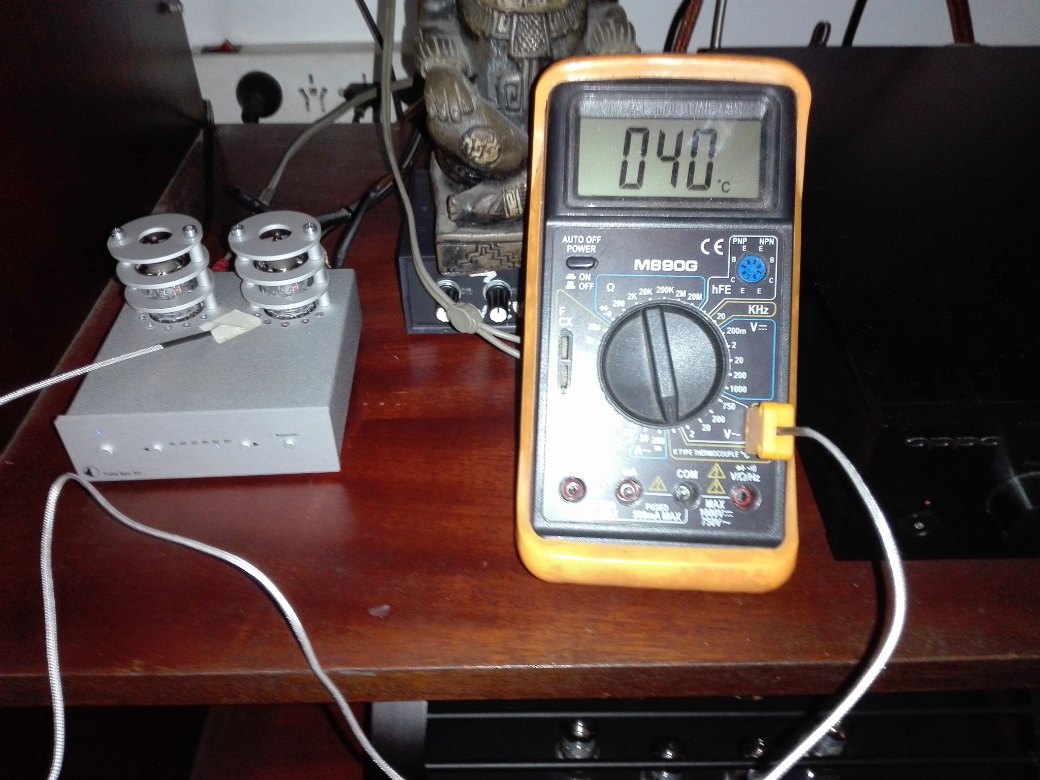

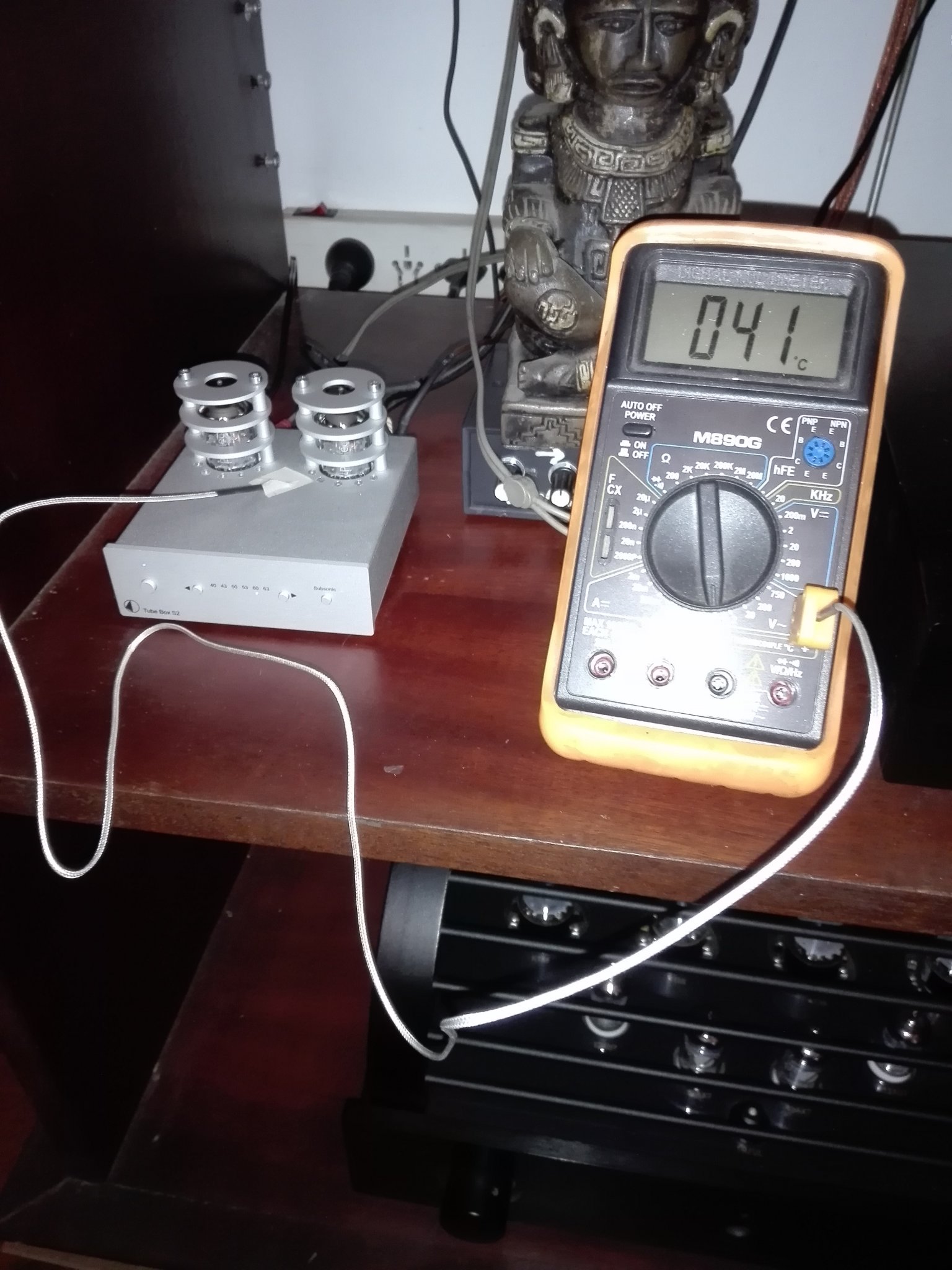

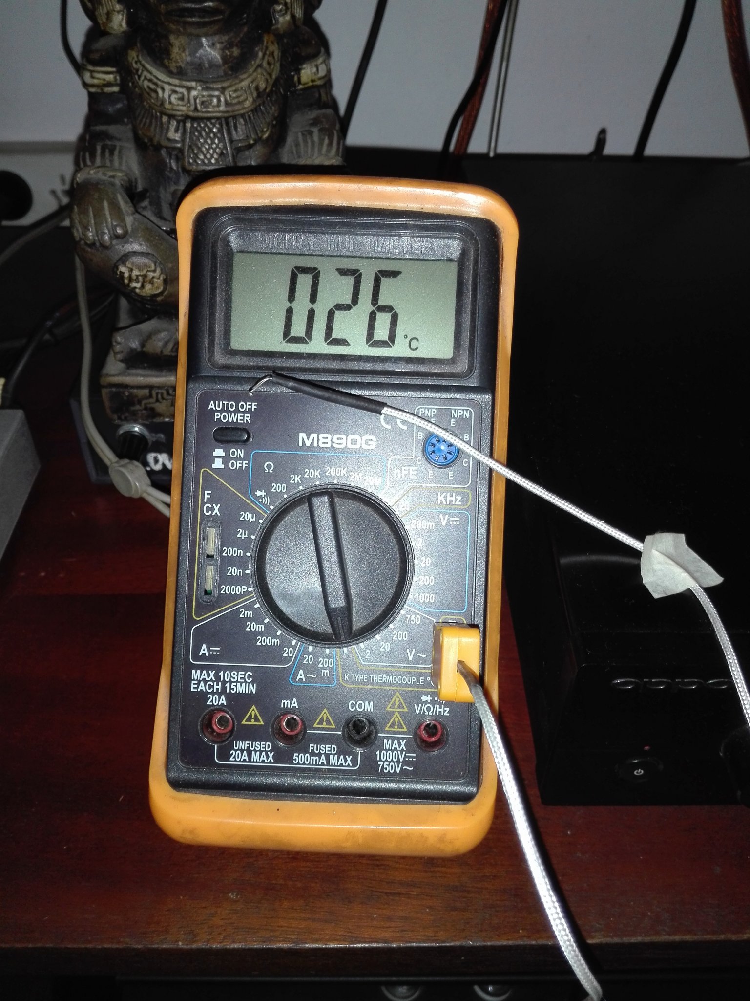

Here are the promised photos. After a few hours of loud music (more than I normally listen to) this little but great Project Tube Box S2 hybrid preamplifier, - suitable for MM, MC cartridges, precise RIAA equalization, selection of impedances, capacitances, gain and subsonic filter - 😊 , step from 40 ° to 42 ° , with an ambient temperature of 26 ° .
So very happy, thanks for stopping by. 👍
