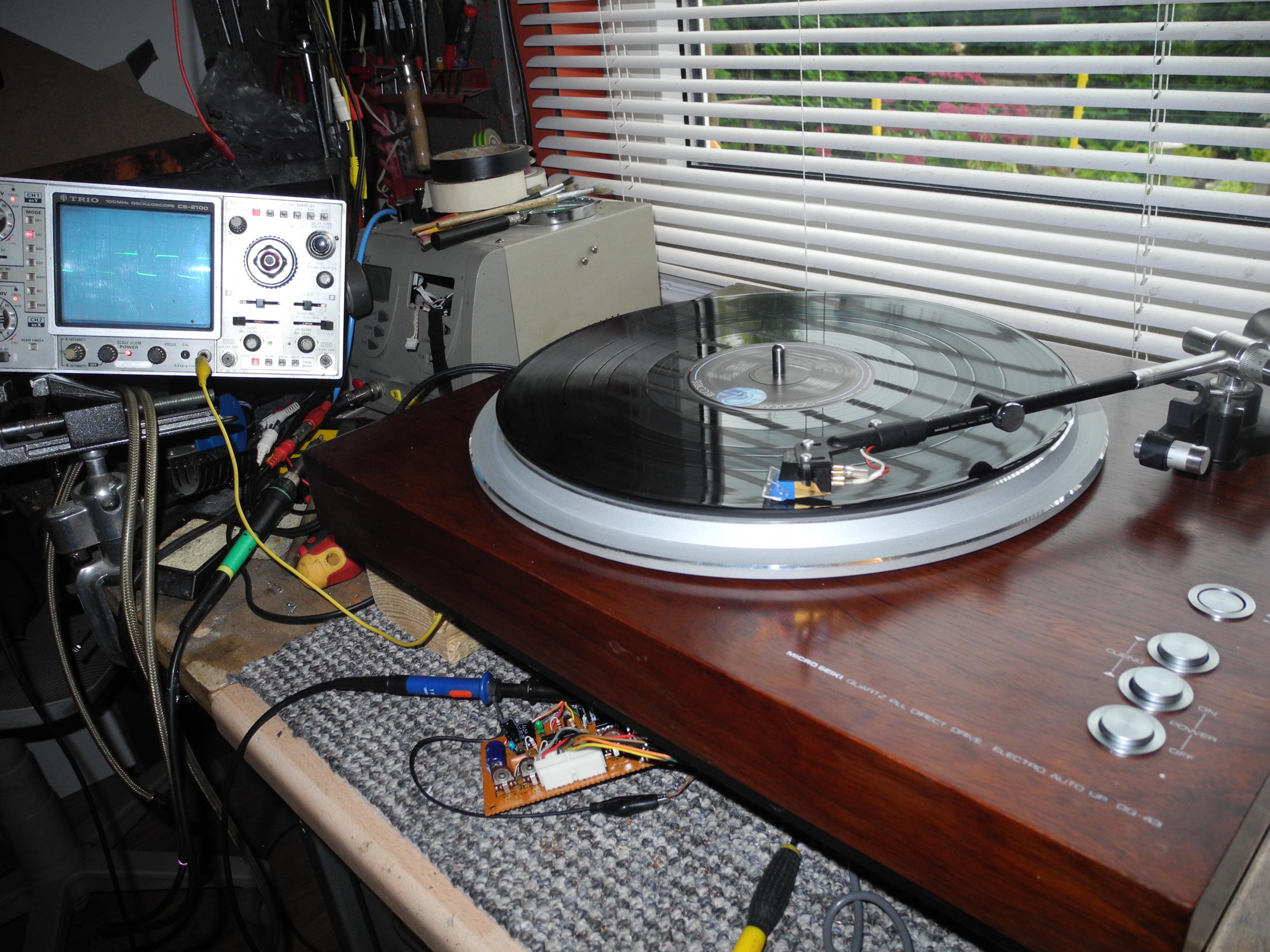

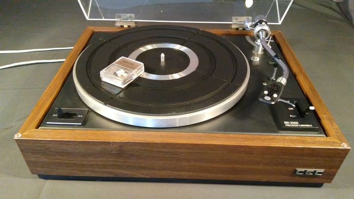

These are my two current turntables, I have built a selector box for them, used low capacitance teflon cable and gold plated RCA terminals.
(photos taken from the web)

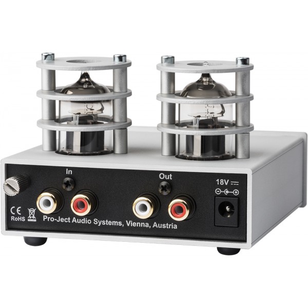

It would seem, academia50, that some commentators do not bother to follow the thread from its beginning. 😉The 18V DC supplied by the outboard supply is converted electronically to the higher DC voltage (at least 100V) required by the anodes of the ECC83s.
Commentators should not confuse the $400 Pro-Ject Tube Box S2 with some cheap Chinese preamp where the valves are there simply for show!

Nice turntables, by the way! 😎
Thank you, they fulfill their mission, the CEC is belt drive, it was said that Micro Seiki manufactured it.
The MS is DD, and I bought it used many years ago, I liked the possibility to vary the mass of the arm to use it with some "difficult" MCs, like the Denon DL 103. I am close to fulfilling my golden dream, haha ! 🙂

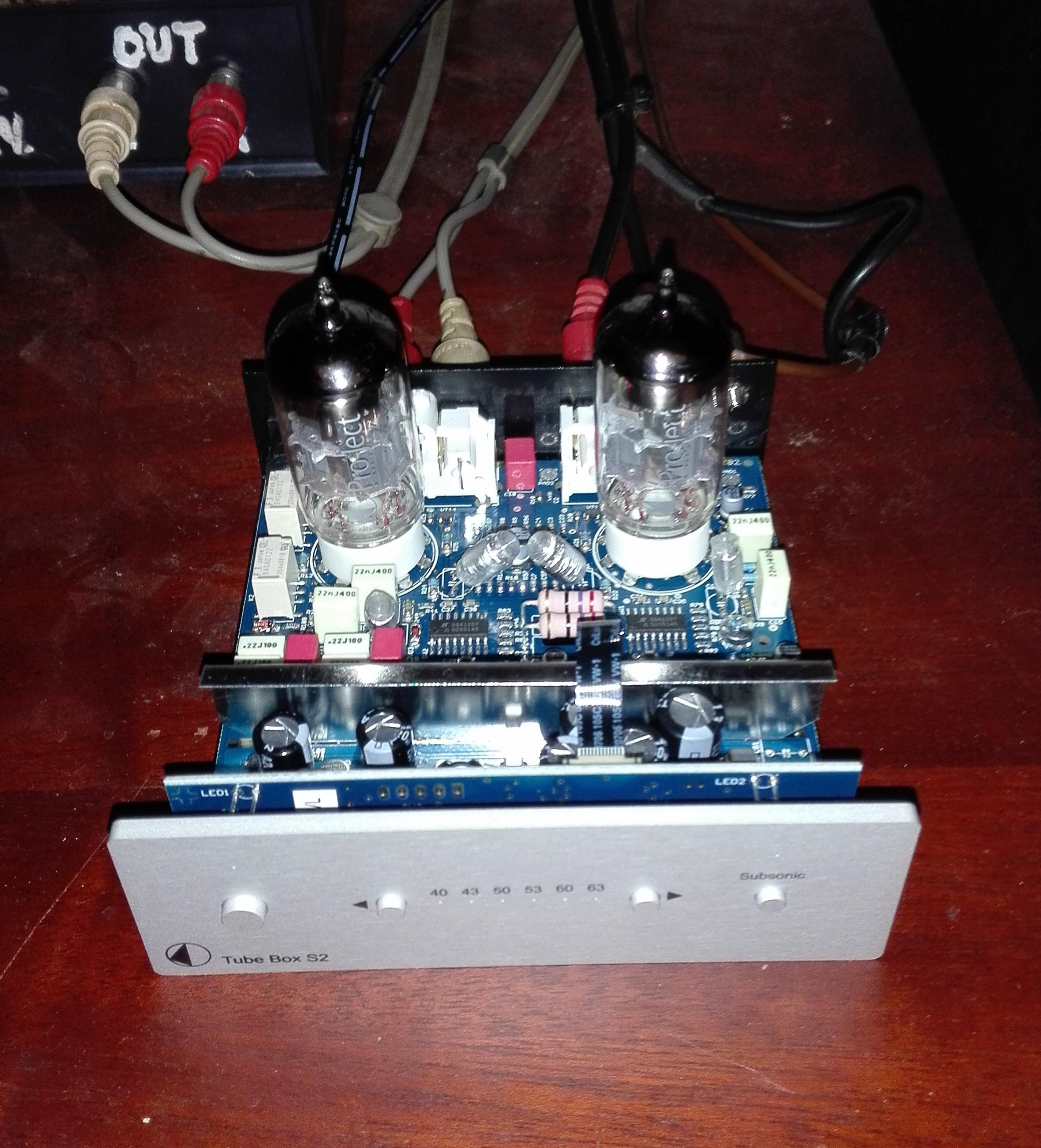

I go back to the beginning of the thread.
I bought and am using the PJ S2 preamplifier prior to the review. It appears that the author of the article (and several other reviewers) have tested it in the Arctic, 😀 because he did not observe the following:
The housing gets too hot, which is because the tube filaments are underneath the top cap and there is only a small hot air leak in the valve holes.
A few small holes around the tubes would have prevented the internal components from overheating, so the recommended solution is to use it like this:
PS: You have to remove the tubes and cages, then the bottom screws and the carcass slides back, it is not a "cover".
WAF: - 1000000 😡

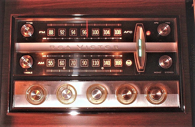

Poorly designed, as many things are today.
Designed around cosmetics, superficiality, impressive looks.....
Decades ago, this was not the case, things had impressive looks, but proper engineering behind it too.
The control panel of my 1963 RCA console stereo - beautiful classic design, 11 tubes under the panel, yet.... designed to float on rubber suspension 1/4 inch above the mounting panel with airflow in mind.
