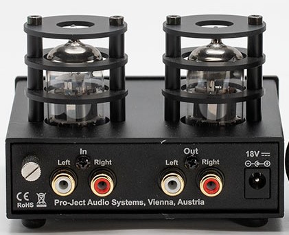

I return to the subject of reviewers and the Pro Ject Tube Box S.

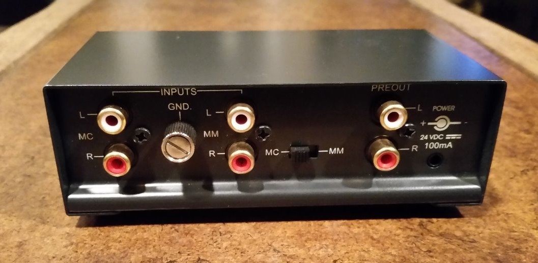

I am targeting one of these, but I want to use two turntables, one equipped with an MM cartridge and one with an MC cartridge.
It never occurred to any reviewer - I've read a lot of reviews - that someone might want to do that ?, and this is a major counter.
Pro-Ject Tube Box S Phono Preamp Review | Top Tube Amplifier
A lower priced NAD PP2 pre has two independent inputs selectable from the rear panel, but on the Pro Ject a DIP switch (e.g. seven, 100 Ohms for Denon DL103) must be set to ON to use MC, and for this there is I have to turn the device over, which is uncomfortable, not practical, and I also suppose that the durability of the microswitch could be affected by using it regularly.
So I ask, a resistance of the value required by the MC cartridge, in parallel with the RCA connector of the TT would fulfill the same function? There is no circuit available, as always....😱

What do you think of loading directly into the RCA input?

Your usage isn't what the manufacturer thinks is common enough to satisfy installing a convenient switching arrangement.
I don't know the schematic of that preamp, so I cannot suggest a rewiring of it.
IF that´s what the microswitch does , yes, why not.a resistance of the value required by the MC cartridge, in parallel with the RCA connector of the TT would fulfill the same function?
Just in case, trace that little bit of circuit.
Yes, JM, just have it in my power, I will try to lift the input circuit, I imagine that the resistors with their own DIPs will be easily identifiable...
Many answers here but only JM thought of what I am interested in knowing, about loading impedance in the input cable and leaving the corresponding switch in OFF.
I know perfectly well that a good MM cartridge can outperform an entry-level MC, but that's not the point here. I have bought Denon DL103, and will play with the mass of the arm until it "sings".
And with regard to the tubes, in the Project they do act on the output, modifying the sound. It is not a cheap Chinese pre !
