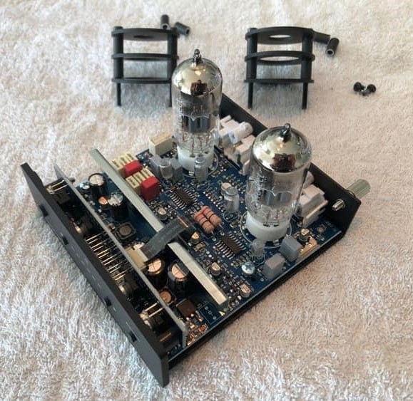

It is that with only a series of holes around the socket of each tube they would have prevented the heat from being trapped .....
To imagine that you don't need so much I+D.
It is curious, among the criticisms of the readers, I found only one occasion to mention excessive heat.
PS: The capacitors came away from the tubes as seen in the photo in the factory, that means something ......

Just a thought...
Are there gaps/vents in the lower part of the enclosure through which cool air can enter?
For effective cooling, a convection current must be able to form where warm air rising through your holes can pull cool air into the lower part of the enclosure.
I originally wrote "Are there gaps/vents at pc board level...", but changed it.
The vents would have to be on the sides of the upper removable section of the enclosure, just above the top surface of the pc board.
Just my thoughts - you may be correct in thinking that it's not necessary. 😎
Methinks all this discussion concerning heat is overthinking it.
A ring of holes through top cover around each tube, and a line of similar holes lower down on either side of the cabinet cover. = sufficient convection cooling flow.
These are small tubes, not 6V6's for jeez sakes.

Thanks for the suggestions but I need to clarify something.
The reason for the rework is explained in post 102. It is not to extend the life of the valves but to protect the interior of the cabinet from a slight excess of temperature.
The photo you can see was taken from the web, obviously it is not my unit since mine is silver and that one is black. But you can see two capacitors indicated with arrows, they are the ones that I wanted to protect especially.
Avoid overheating beyond 70 degrees Celsius. In fact, the factory unit does not have any ventilation, beyond the necessary holes to house the tubes, so I decided to make the modification.
But I can't make holes on the sides (the idea is a good one, I had already thought about it, thanks anyway) because I would need a professional bench drilling machine that allows the carcass to be placed vertically. I'm not going to buy it, nor annoy friends, nor invest neither time nor money sending the work to a metal-mechanic specialist.
As soon as I have some free time, I'll measure the case temperature - after a few hours of operation - with the multimeter sensor and let you know.

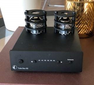

Here are the promised photos. After a few hours of loud music (more than I normally listen to) this little but great Project Tube Box S2 hybrid preamplifier, - suitable for MM, MC cartridges, precise RIAA equalization, selection of impedances, capacitances, gain and subsonic filter - 😊 , step from 40 ° to 42 ° , with an ambient temperature of 26 ° .
So very happy, thanks for stopping by. 👍
