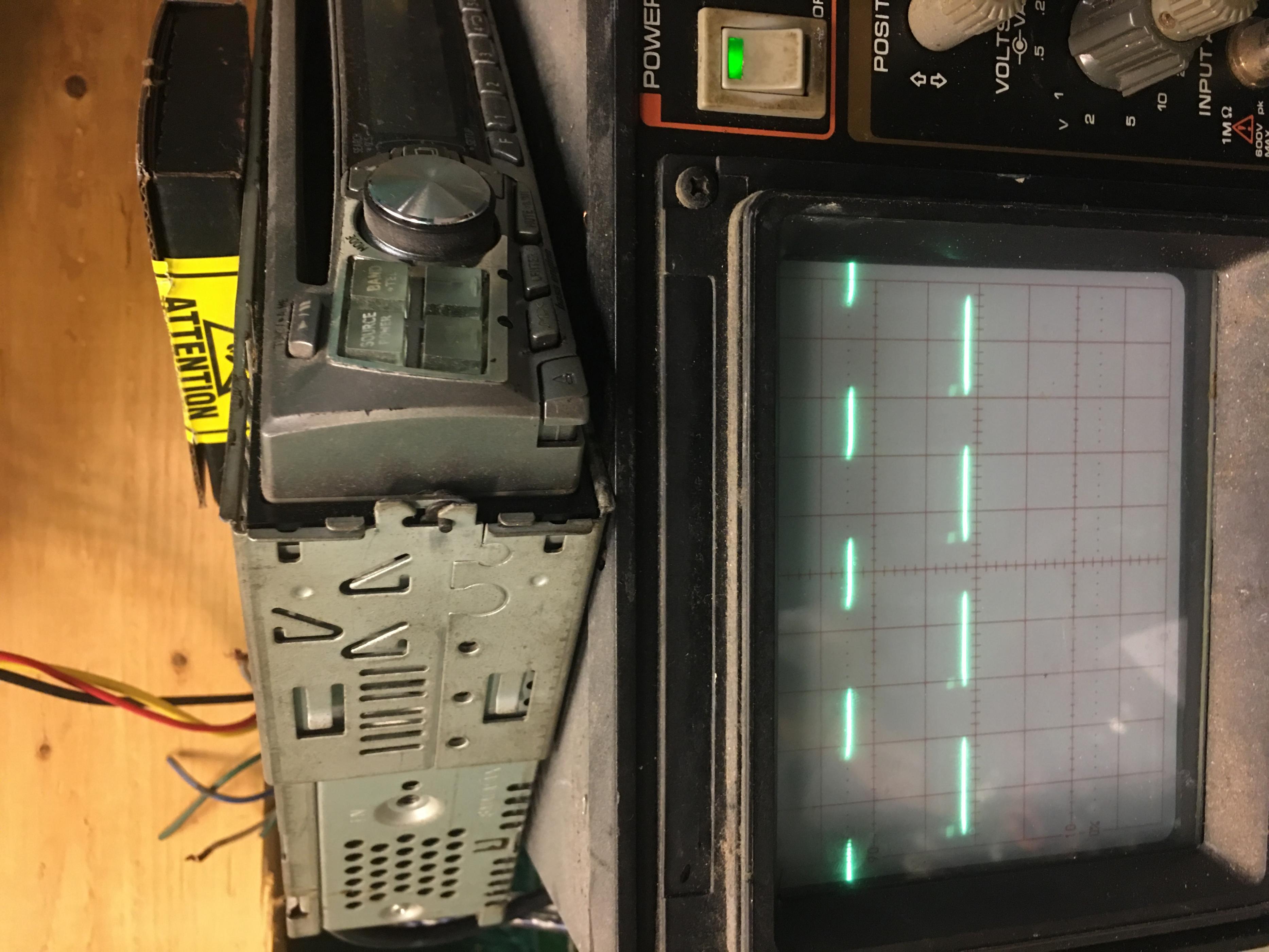

Pic 1 is 1 side of the gate resistor .

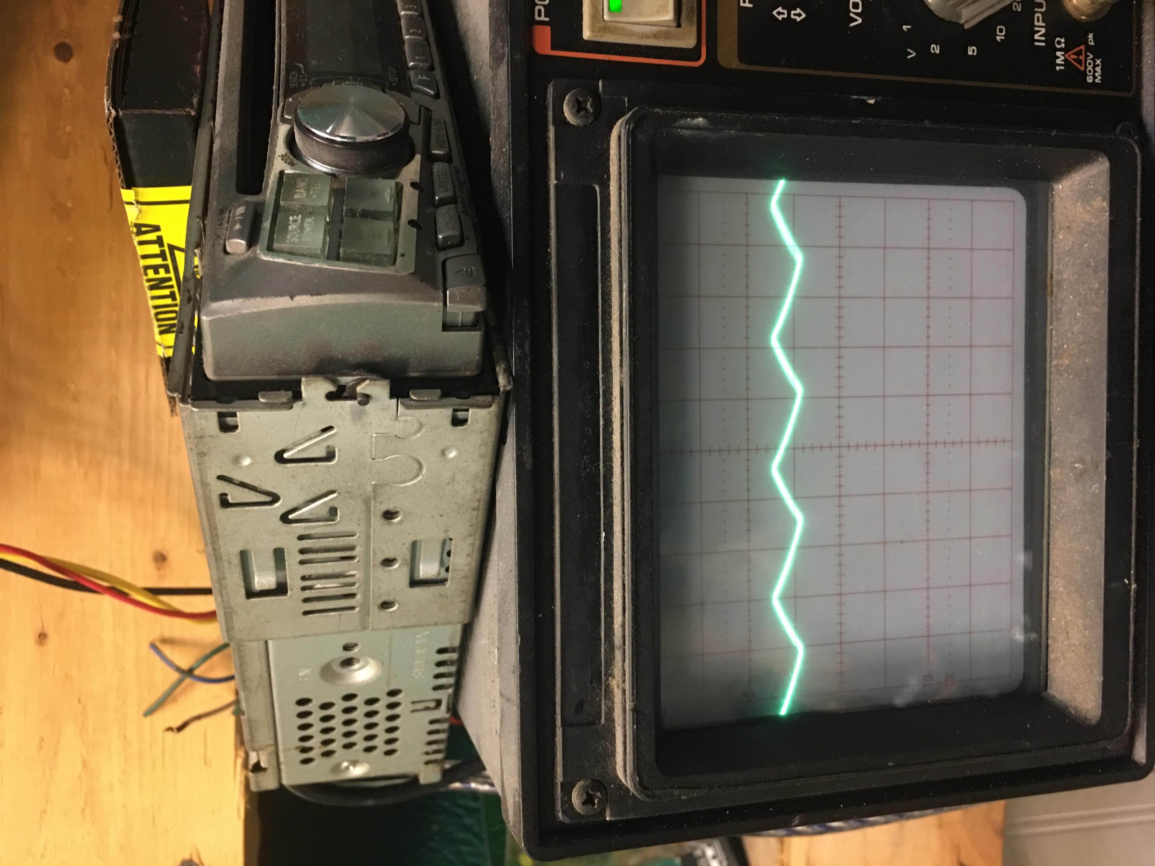

2nd pic is the other side of the gate resistor that connects to the fets gate leg this is loaded with 2 0.1 caps in series
I know what I’m supposed to have but I’m not getting that at all
Ok I found a problem . I wasn’t paying attention when I put the gate resistors in the amp .
I bought 47 ohm gate resistors from a electronics shop where I live .
The package was labeled 47 ohm but the resistors are actually 470 ohm 🙄
I will switch the gate resistors and check again
The gate resistors are labeled wrong they measure 0.468 K on my meter ,
I bought them and the package says 47 ohm but they are 470 ohm
Guess I should have paid closer attention to the color bands
I will replace them and see what I come up with
