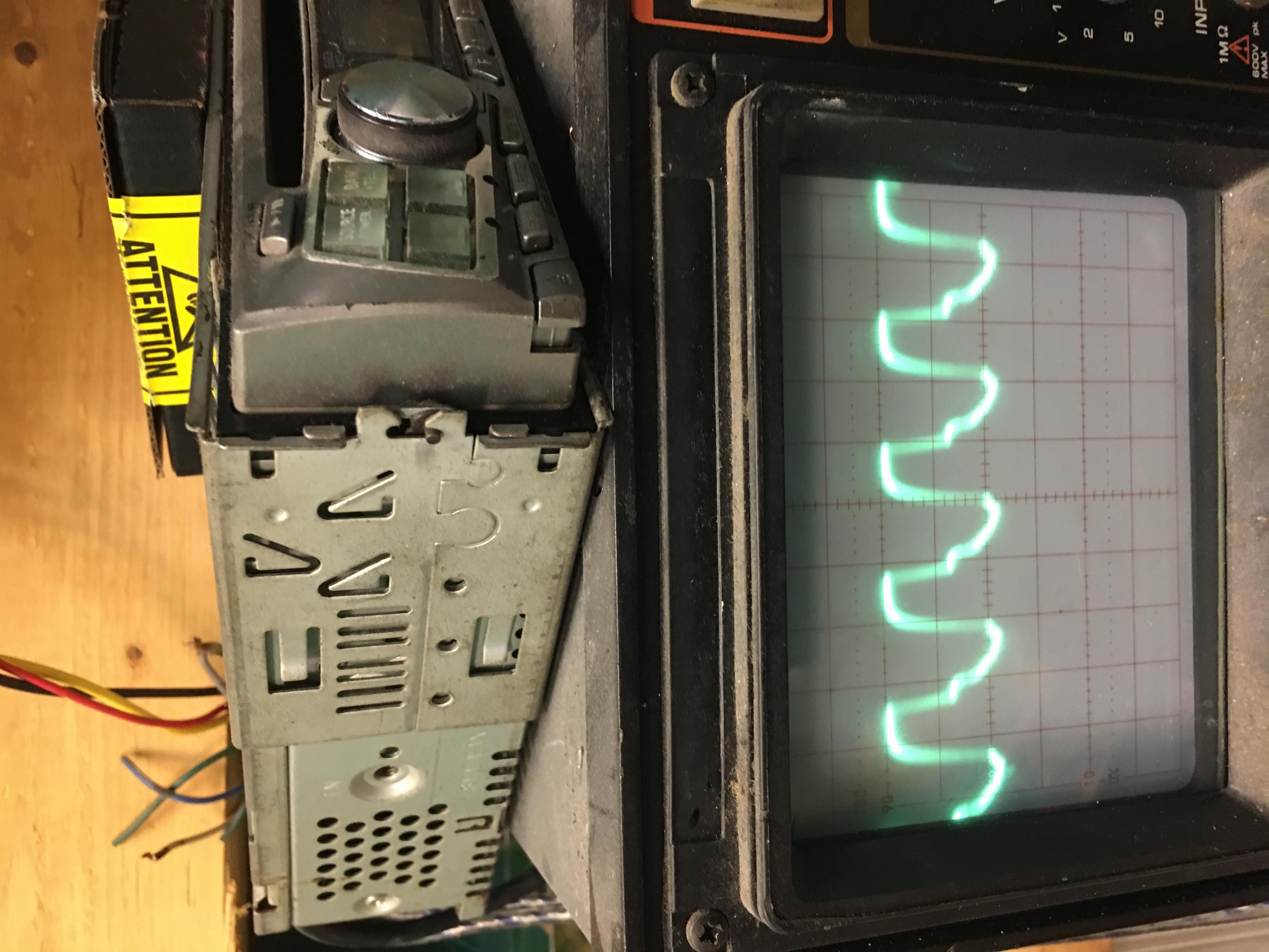

Is the signal the same on both banks?
Is the signal on the base of the two drivers a clean square wave like this was before loading?
Replaced the chipset (494) and replaced the drivers again .

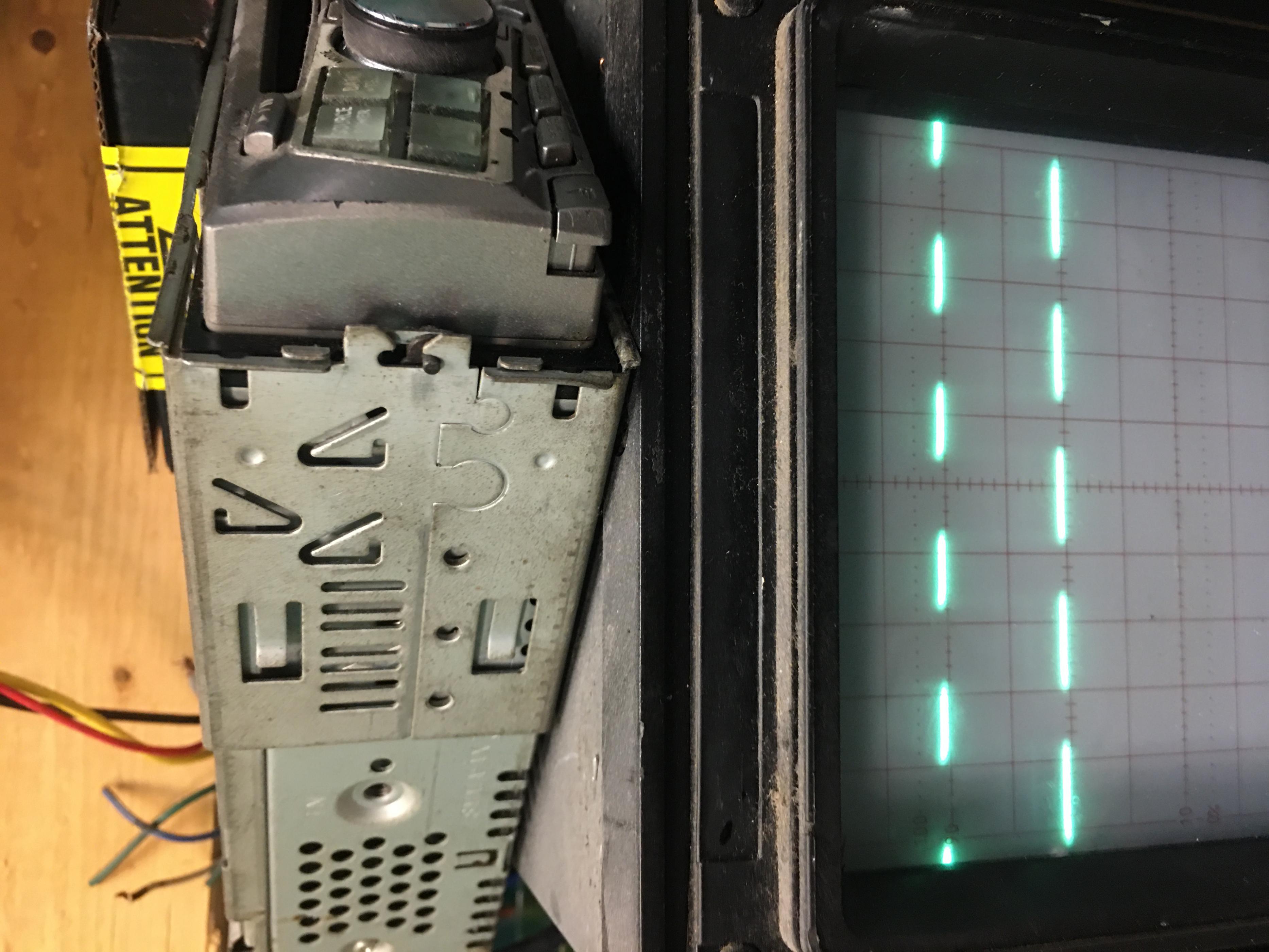

The drive is good all the way down to the gate resistor with it loaded then at the gate resistor the drive gets goofy like in the previous posts .
That's bad. What value are the pulldown resistors between the base of the drivers and the collector of the PNP driver (ground)?
If it's open, install something between a 1k and a 330 ohm on each driver pair to see if it helps.
