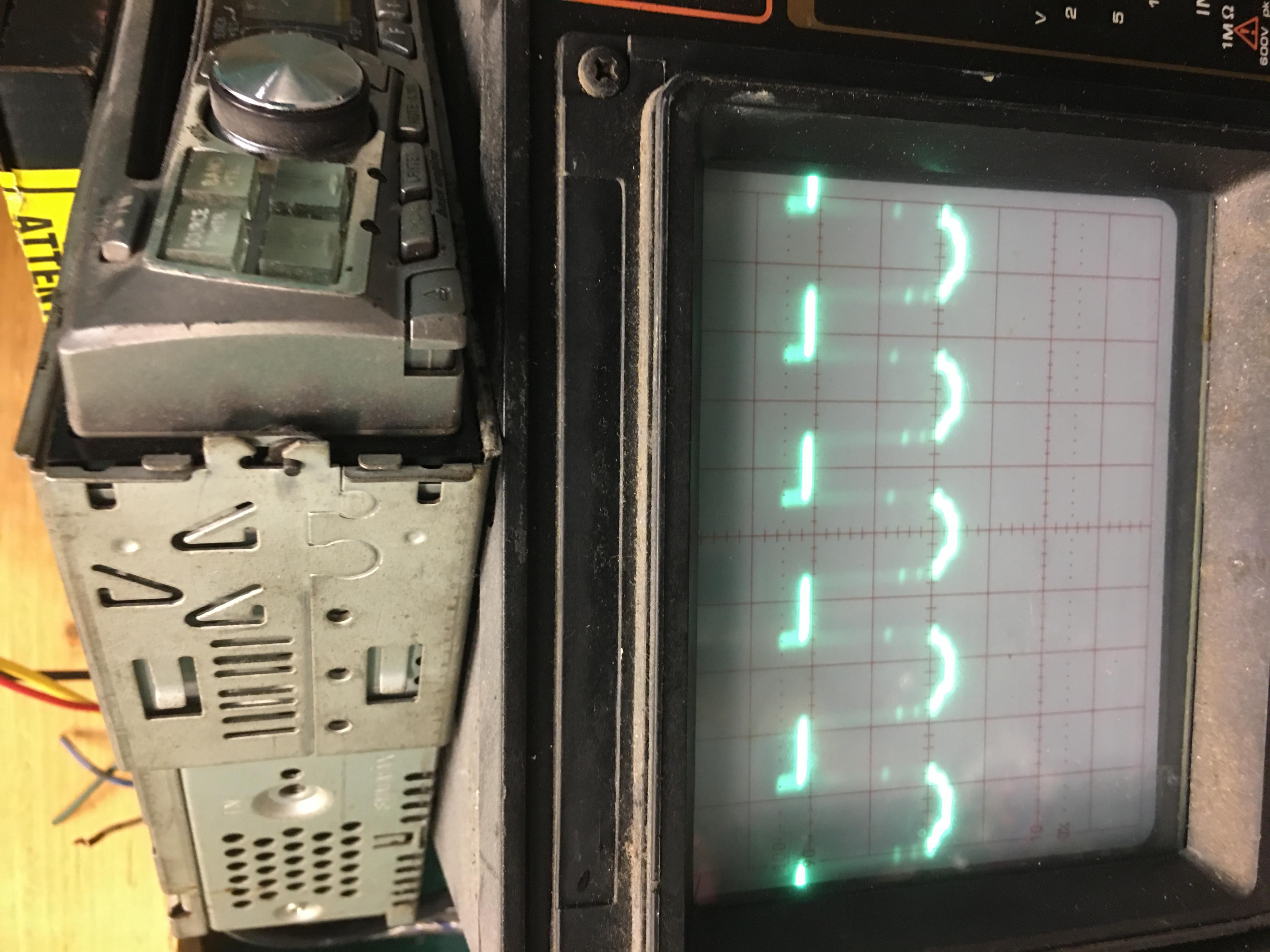

Ok something is not right at all in this amp .
I will take some pics of the waveforms and show you what I have on the fets .

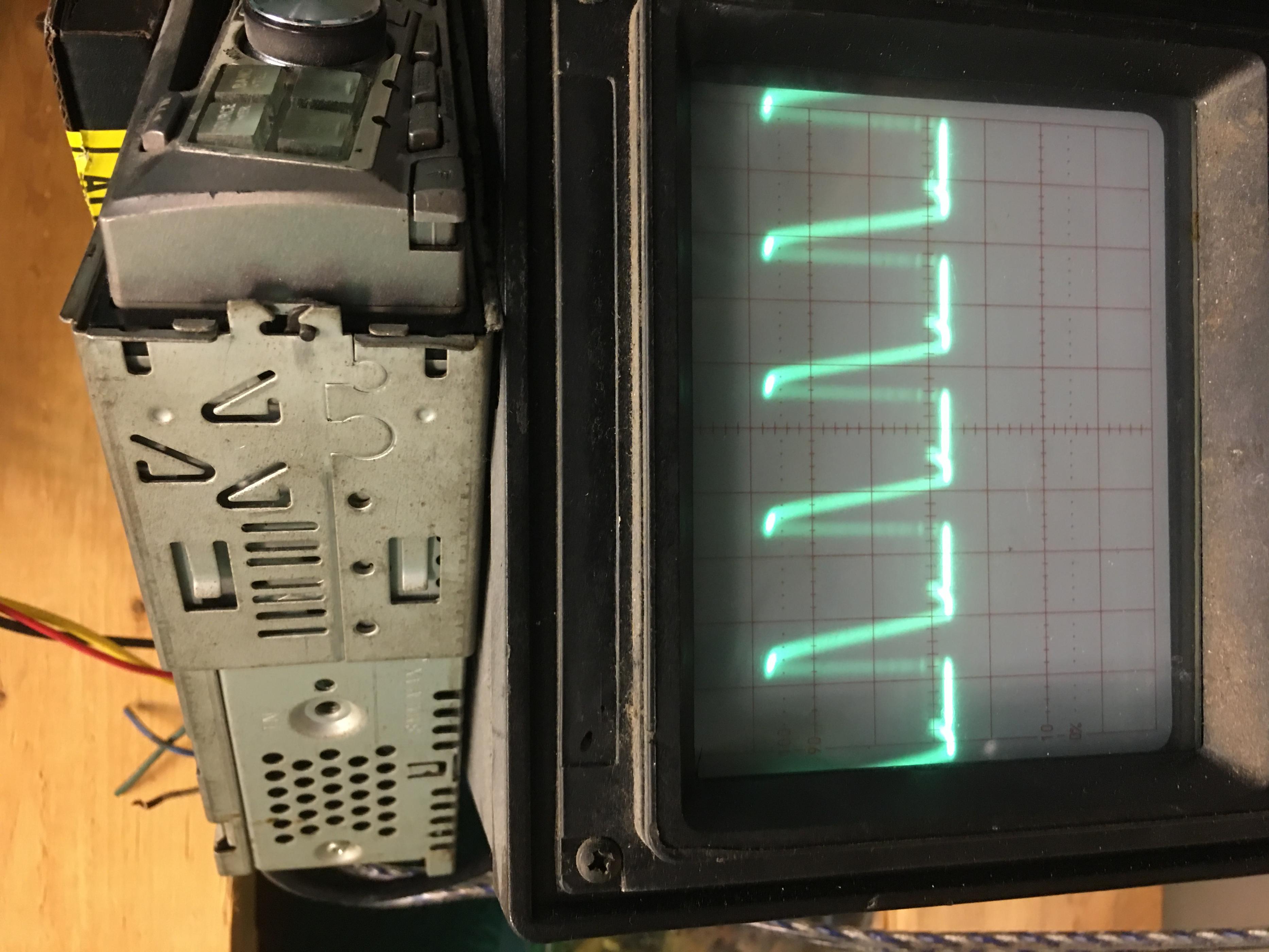

Ok the first pic is of the waveform on the gate leg of the power supply fet .

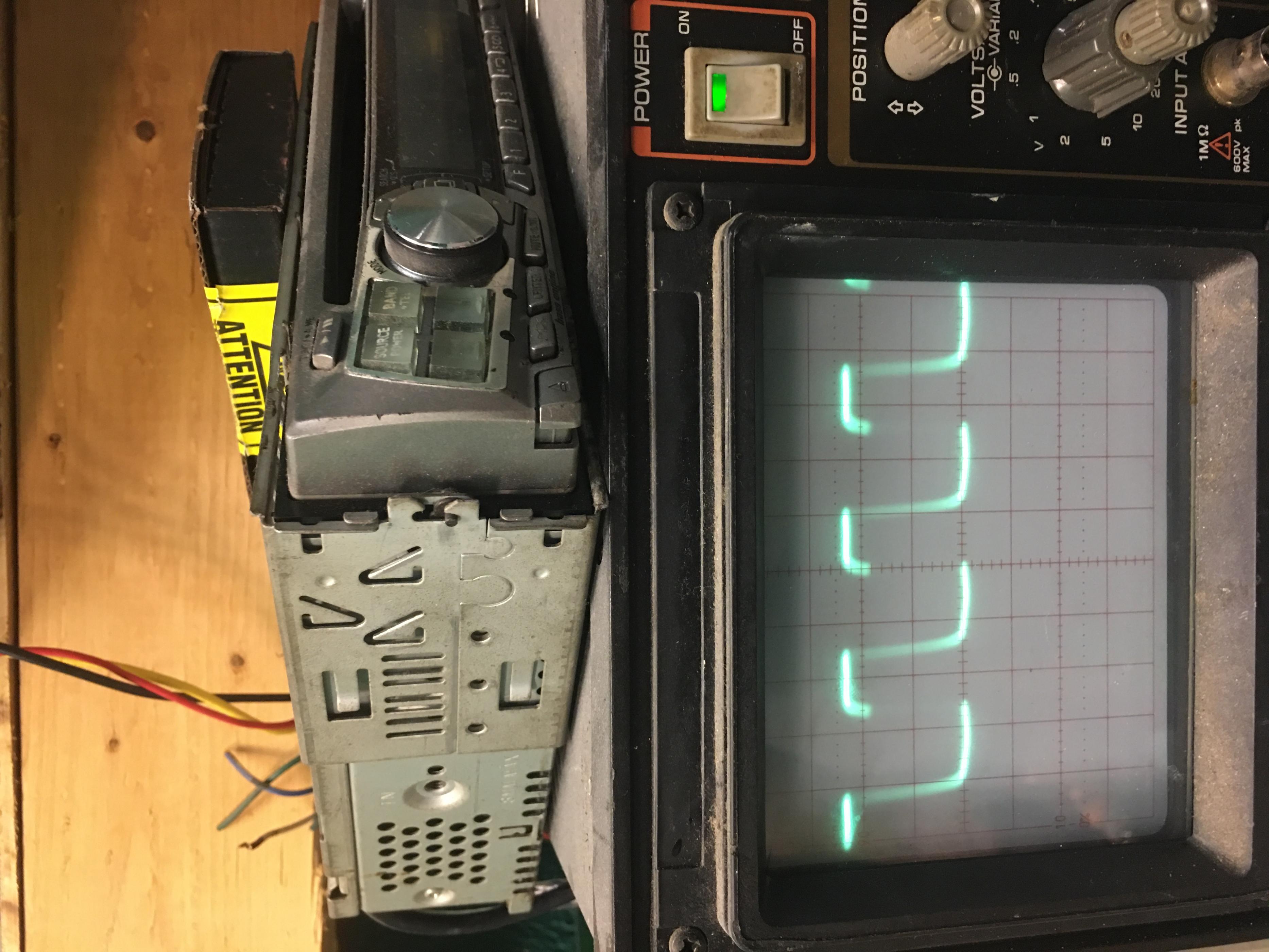

The 2nd image is with a fet in the amp and on the drain leg of the fet .
The 3rd image is on the drain leg for the fet the fet is removed out of that location .

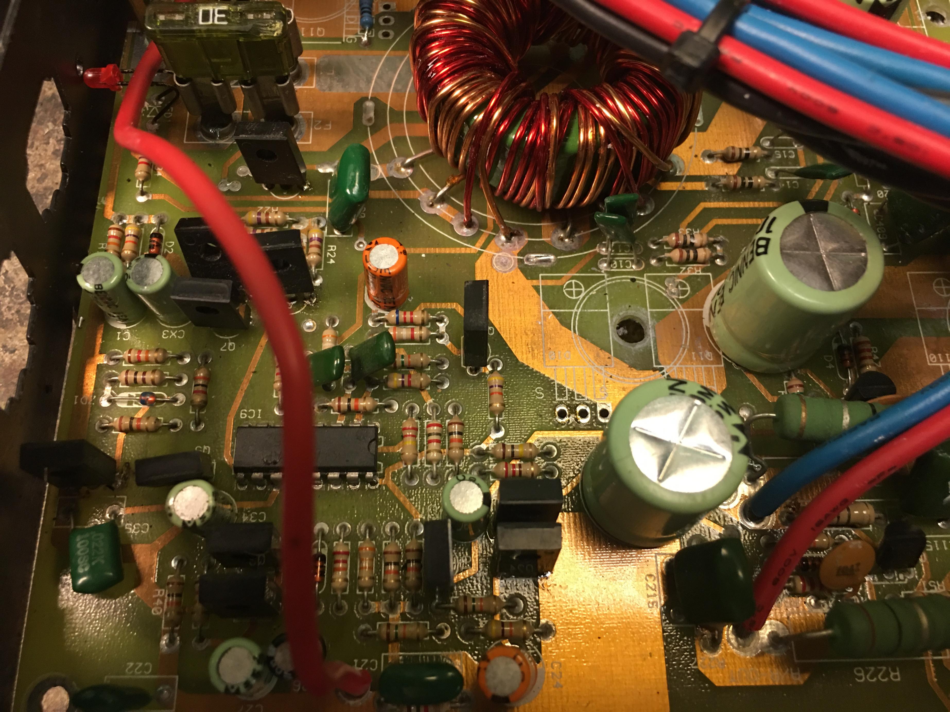

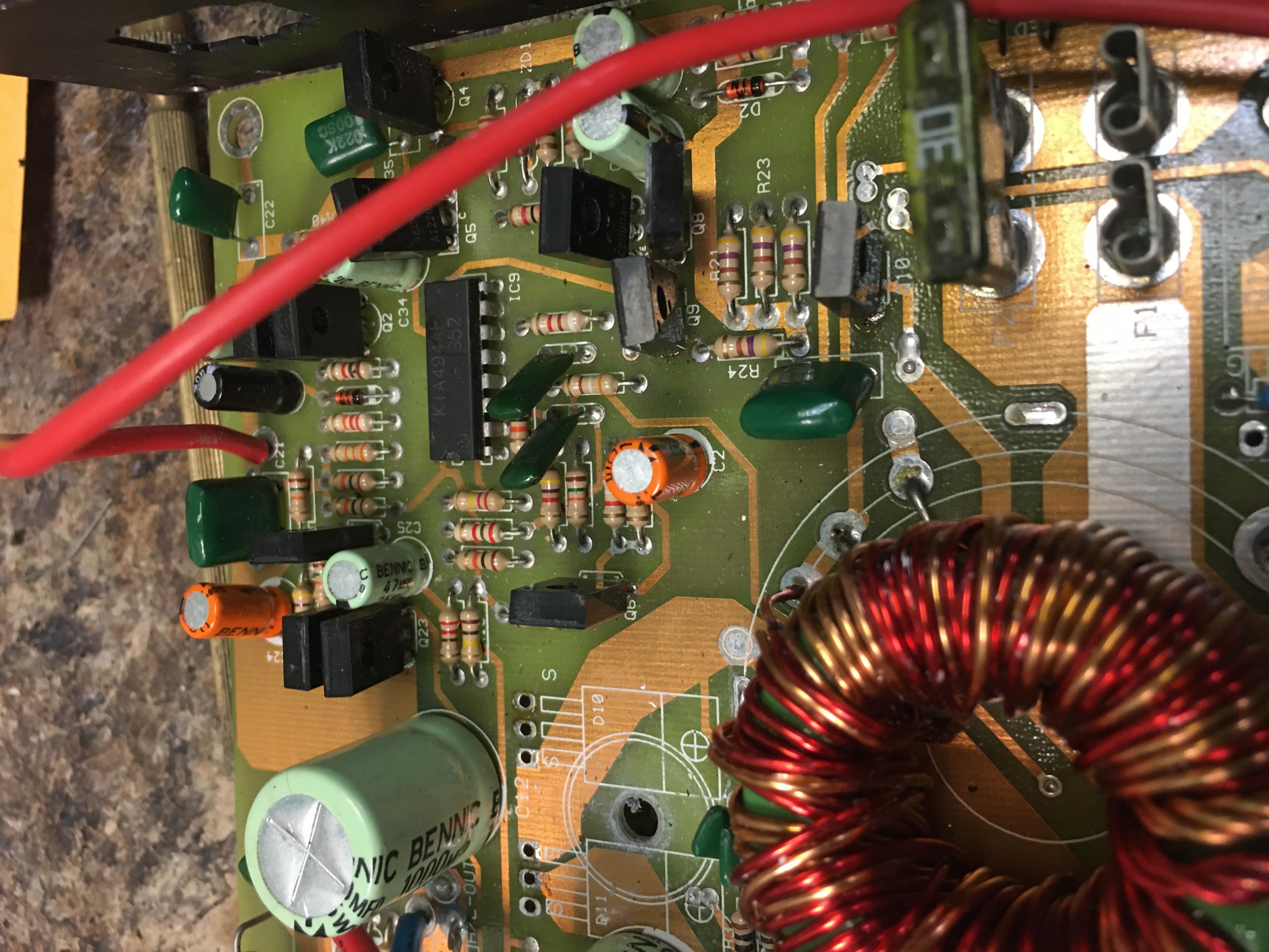

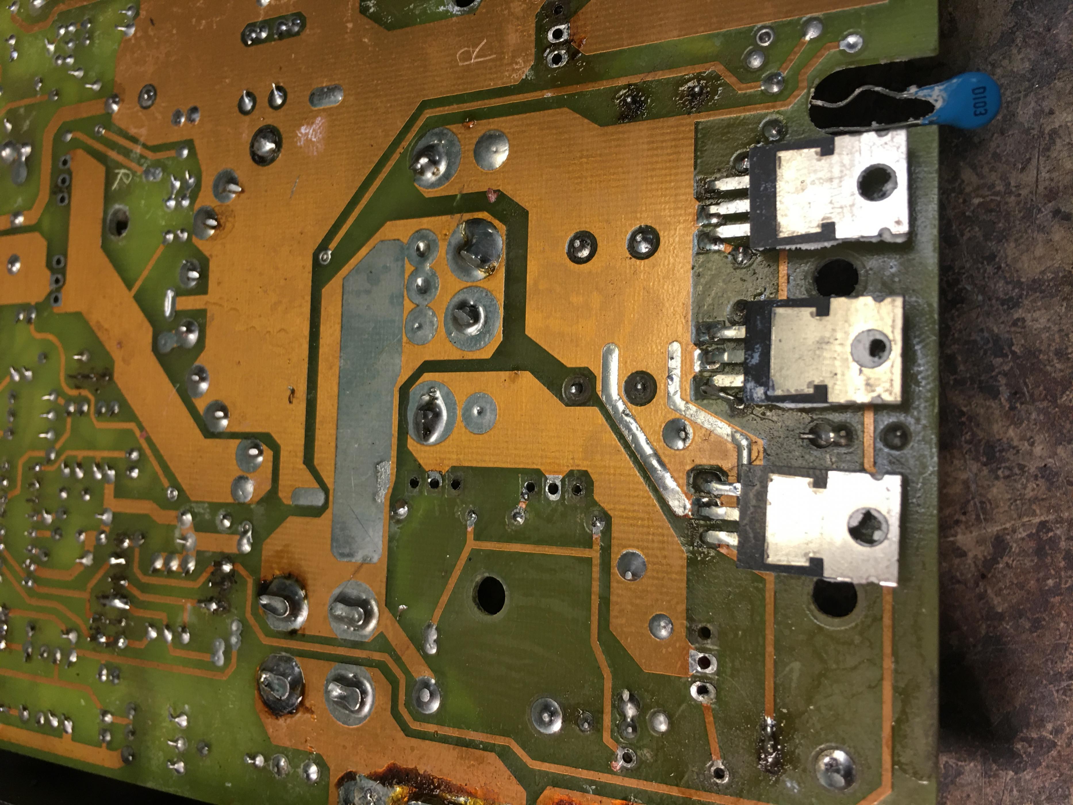

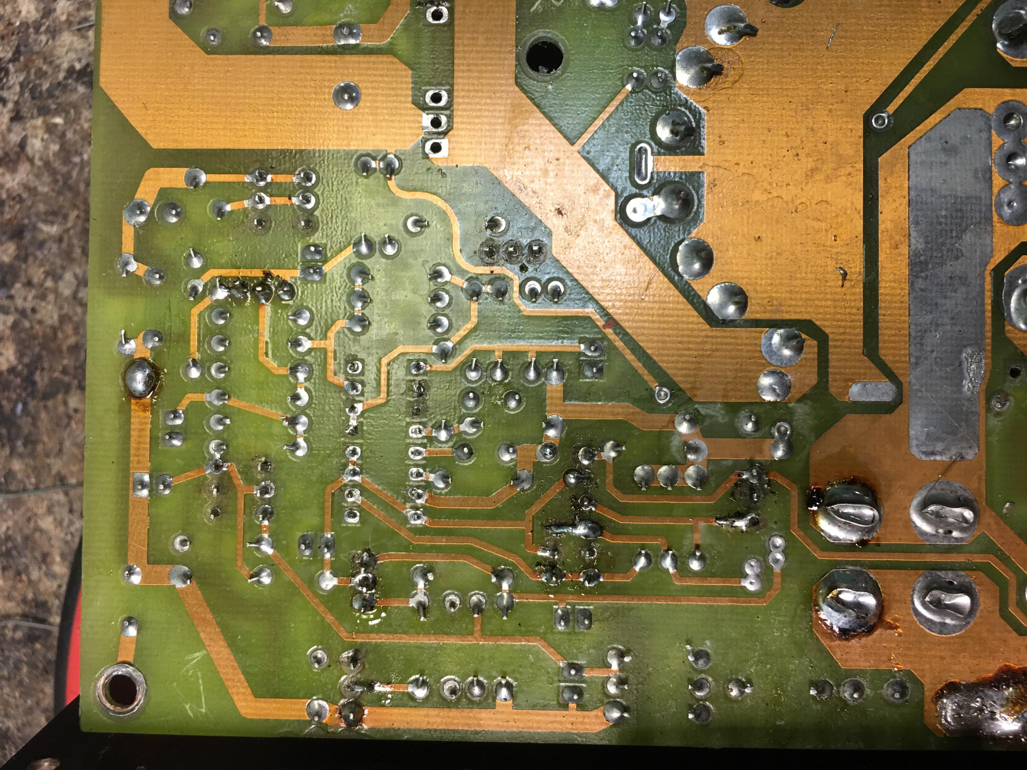

Post good quality photos of the PS section showing the entire drive section and both banks of FET locations, top and bottom.
Let me know if you need more pics or better pics of a certain area

From what I can see, I don't see any problems. I'm assuming that you've made sure that you have good connections, top and bottom where pads are damaged.
With only 1 bank loaded, you can't expect normal drain waveforms.
Go back to the loading cap. At what point do you lose the perfect square wave on the following points. This is one half. Check both halves.

What happened to the perfect waveform you had when you went to 33 ohms?

I’m losing the perfect square wave at the emitter (leg 1) of the drivers .
Maybe I was wrong when I said I had the perfect wave at the fet at 1 point .
And I’m going to confirm I have connection at the top and bottom of board where pads are missing . Which I will fix once I figure out the drive issue

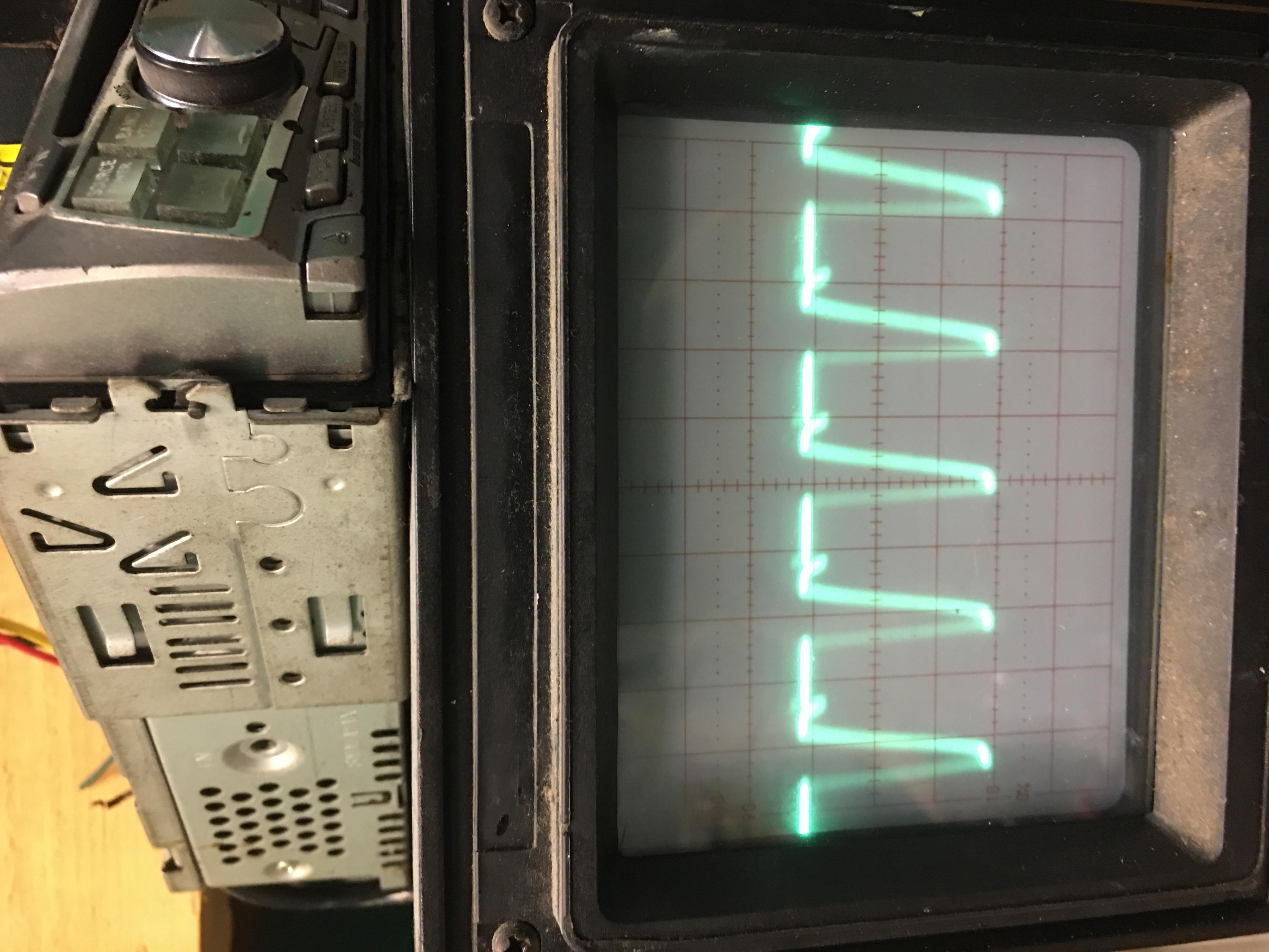

After going through the entire power supply section here is what I get on the gates of the power supply fets this is with it loaded with a fet .
Scope settings are 10us 5 volts /div
Do I still have a problem or does this appear to look good .
The led for The power light was shorted causing pin 16 to go high .
It's a little odd but it could be OK. Is the amp drawing excessive current when the FETs are in the circuit?
