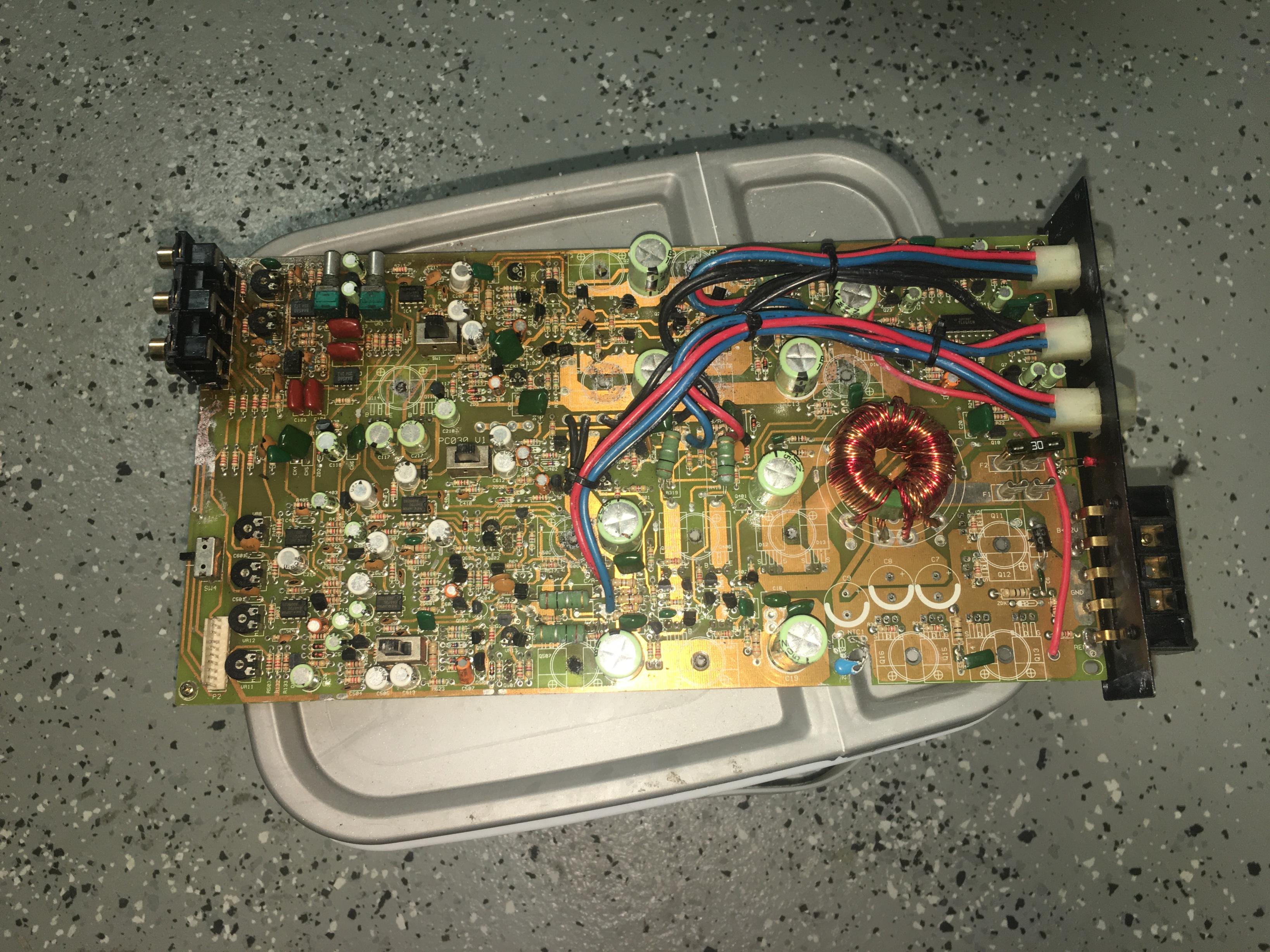

Replaced the driver transistors and the amp still draws excessive current .
The power supply fets get red hot within 2 secs
Did you check the drive signals before installing the FETs?
Does it do the same with the rectifiers removed?
If the FETs are clamped to the heatsink and you power through a limiter, does twisting the transformer make a difference?

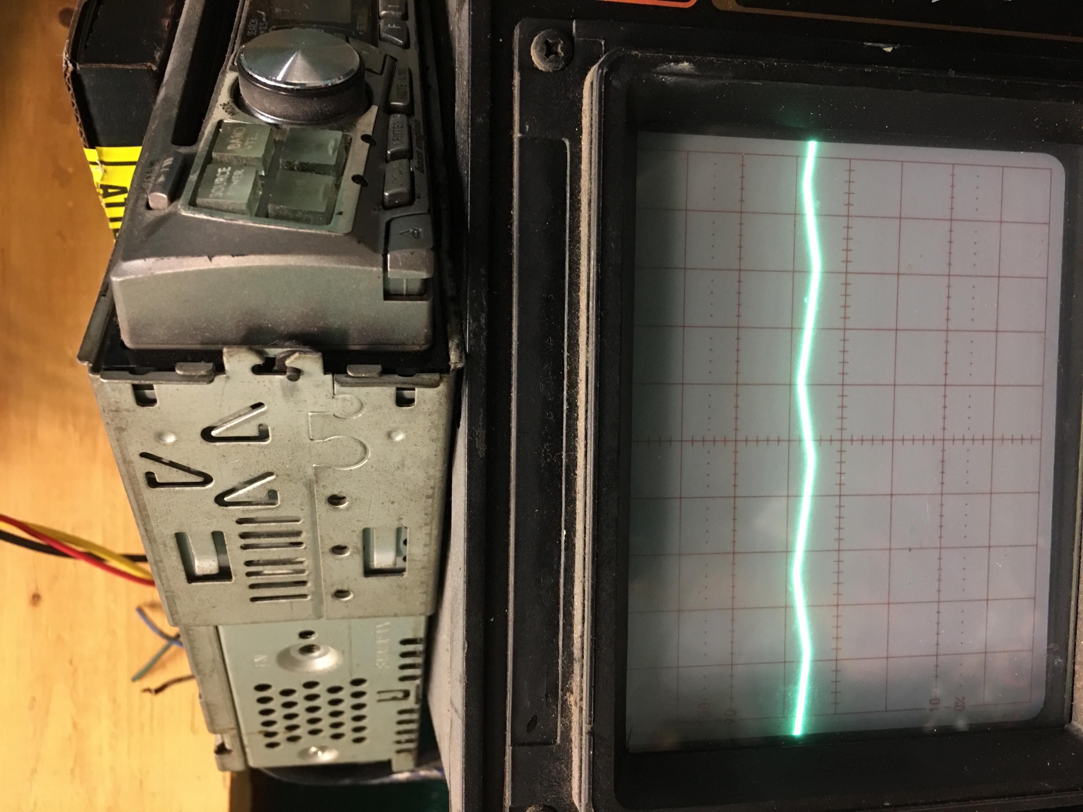

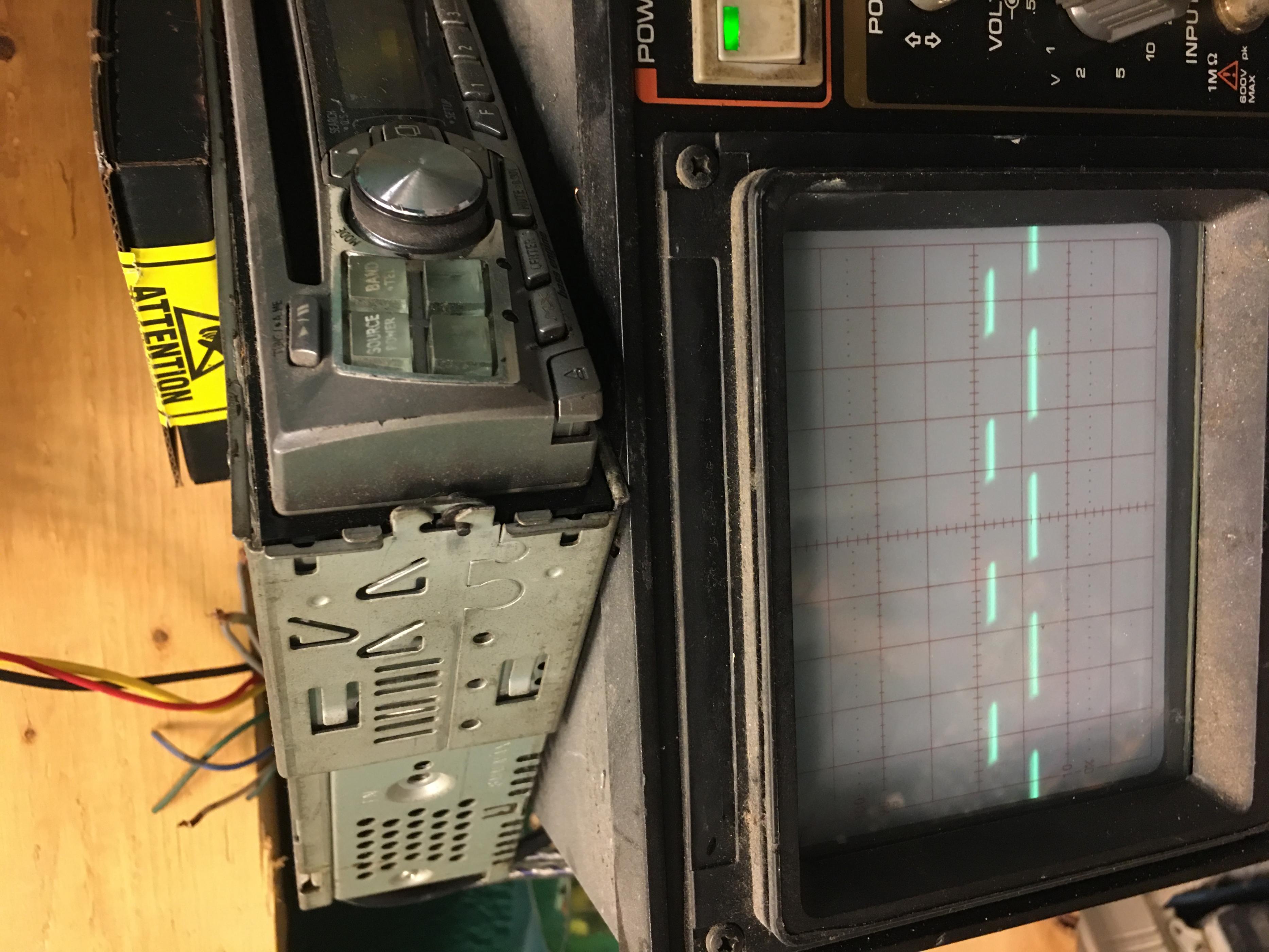

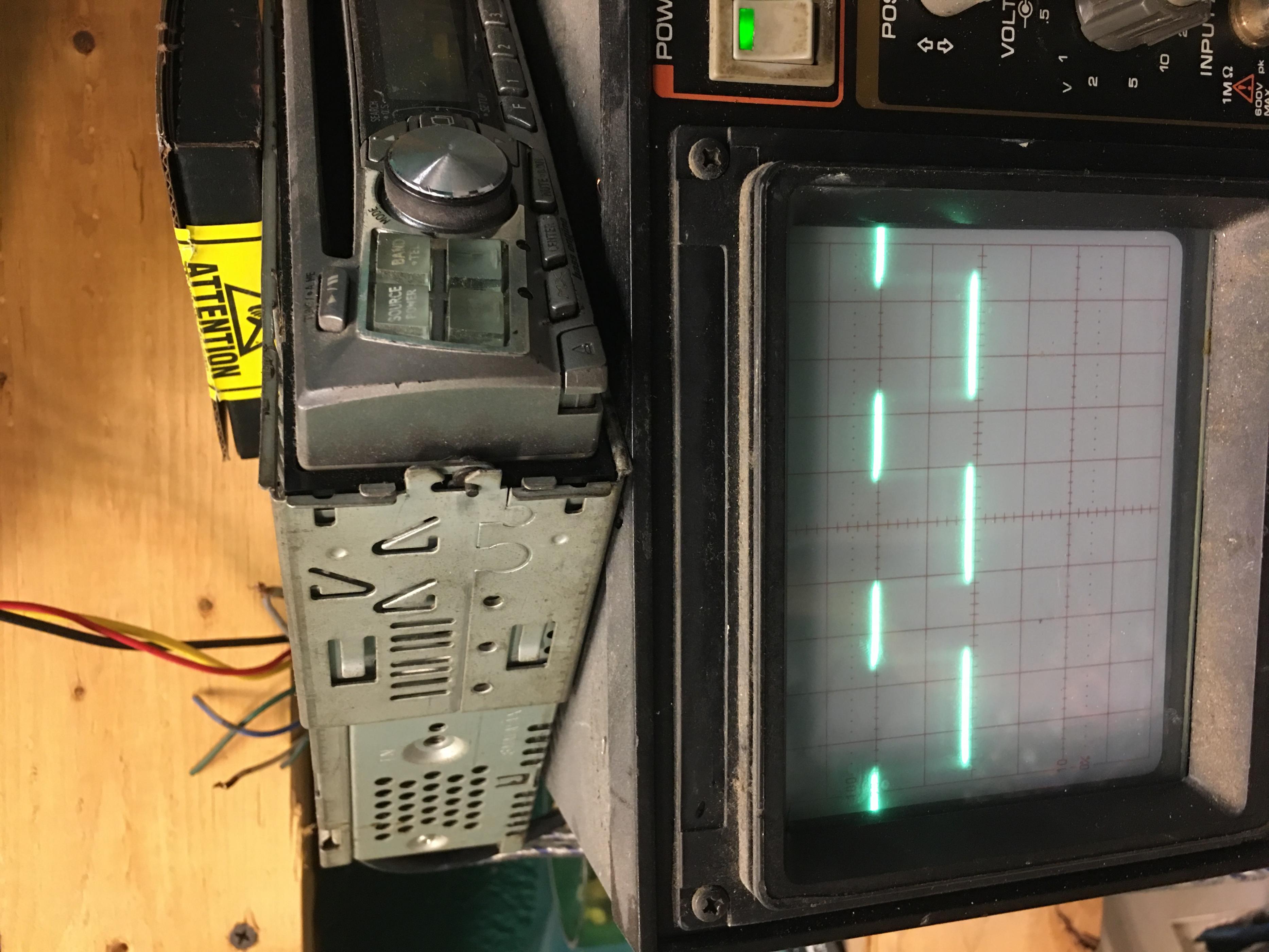

Without being referenced to the reference line and the scope set to DC coupling, that means nothing.
The line was centered that’s what I got when I touched the probe to the gate resistor and the scope is set to dc coupling .
I will try it again .

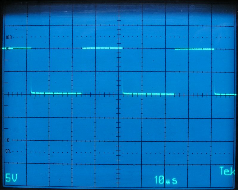

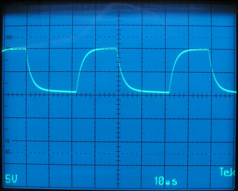

I'm assuming that the FETs have been removed. Load the FET location with something like a 0.1uF cap (gate to source) to see what it looks like.
I generally use a 0.047uF but that looks much flatter than it should be. The following are before and after being loaded with a 0.047. If you don't have one, two 0.1s in series give you the same thing. Note the scope settings.
In series you mean 2 of them gate to source or 1 leg of 1 to hate and 1 leg to source and other legs connected together
Two caps. One with a leg in the gate. The other with a leg in the source. The two free legs soldered together.
